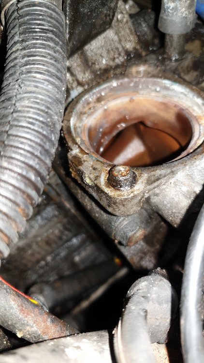

I've been working on the 205 this afternoon. I found the source of a water leak which was from the thermostat housing. The bottom bolt had been snapped off and silicone had been slapped about in the hope it would contain the water :(

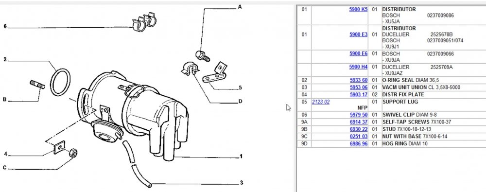

Anyway, after stripping it all down today to get the housing off the side of the block to get proper access to the snapped bolt I noticed a small diameter pipe which crumbled into pieces when I picked it up. Looking around the engine I can only assume it went from the bottom back of the throttle body all the way to the back of the distributor to the vacuum housing. Could anyone please confirm this? I've attached a picture, is it the pipe listed as number 3?

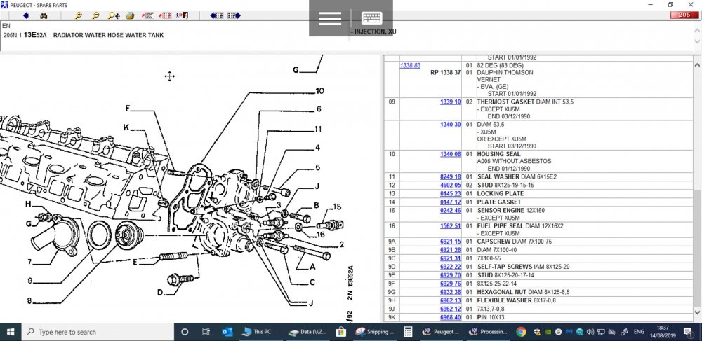

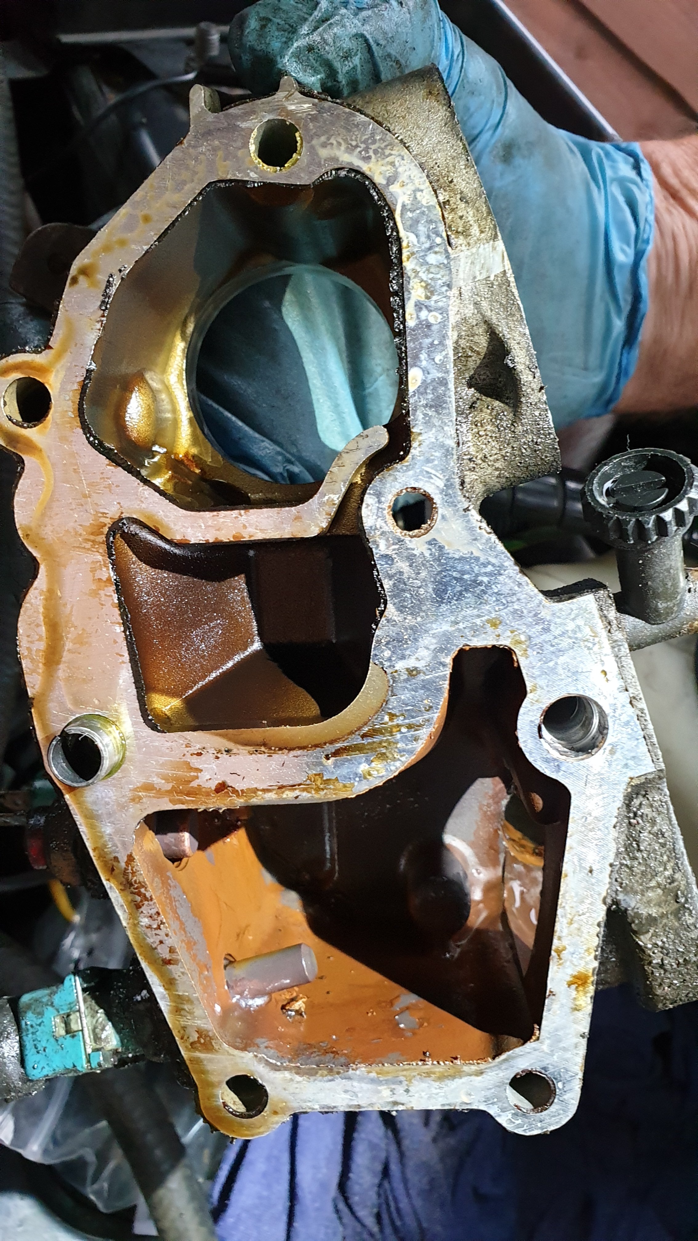

On the side of the housing between the block I was expecting a gasket but there wasn't one. I checked and it says End 01/12/1990, number 10 on the second picture. Mine's a 1992, what should I use instead of a gasket?

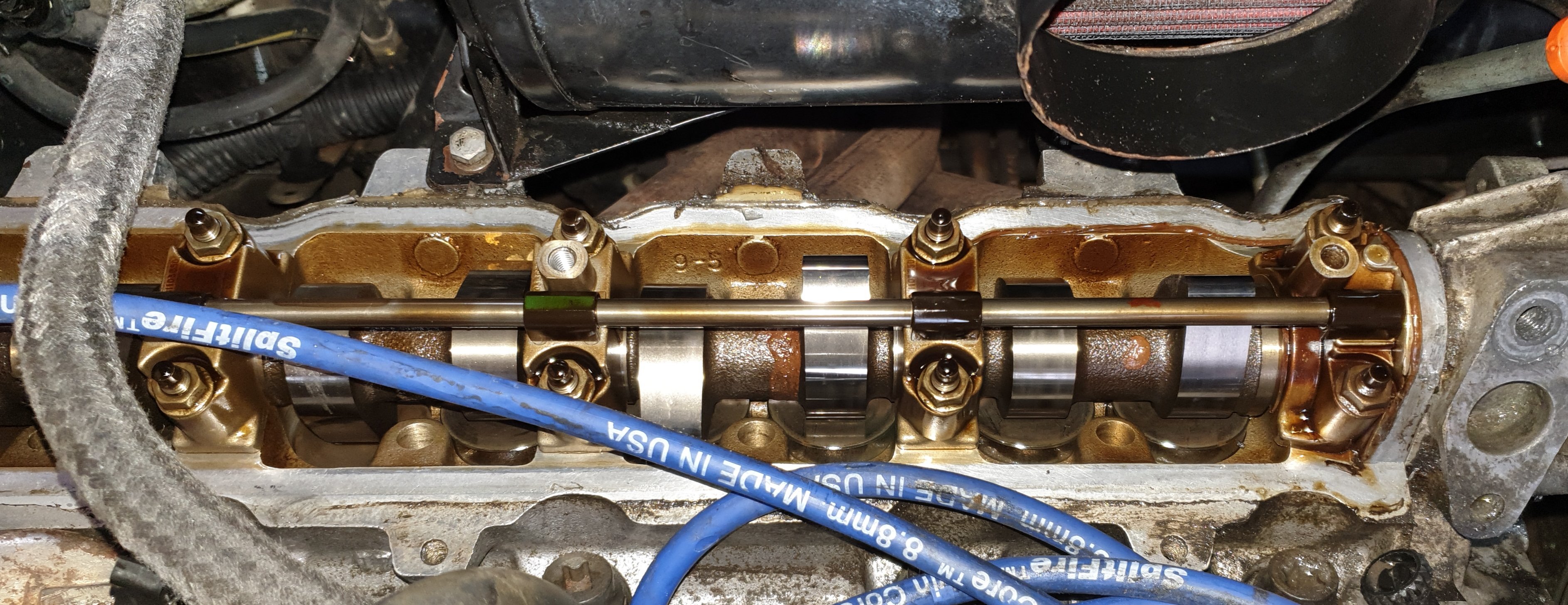

I was also quite surprised at how clean the inside of the rocker cover and inside the engine was, see pics, is this usual for a 27 year old 100,000 mile car??

Yes that's the vacuum advance hose, you can use generic vacuum hose to replace it.
A clean engine is normal if it has had very regular oil changes, or if it's been rebuilt relatively recently.
You could retrofit a gasket or alternatively use rtv silicone with no gasket.

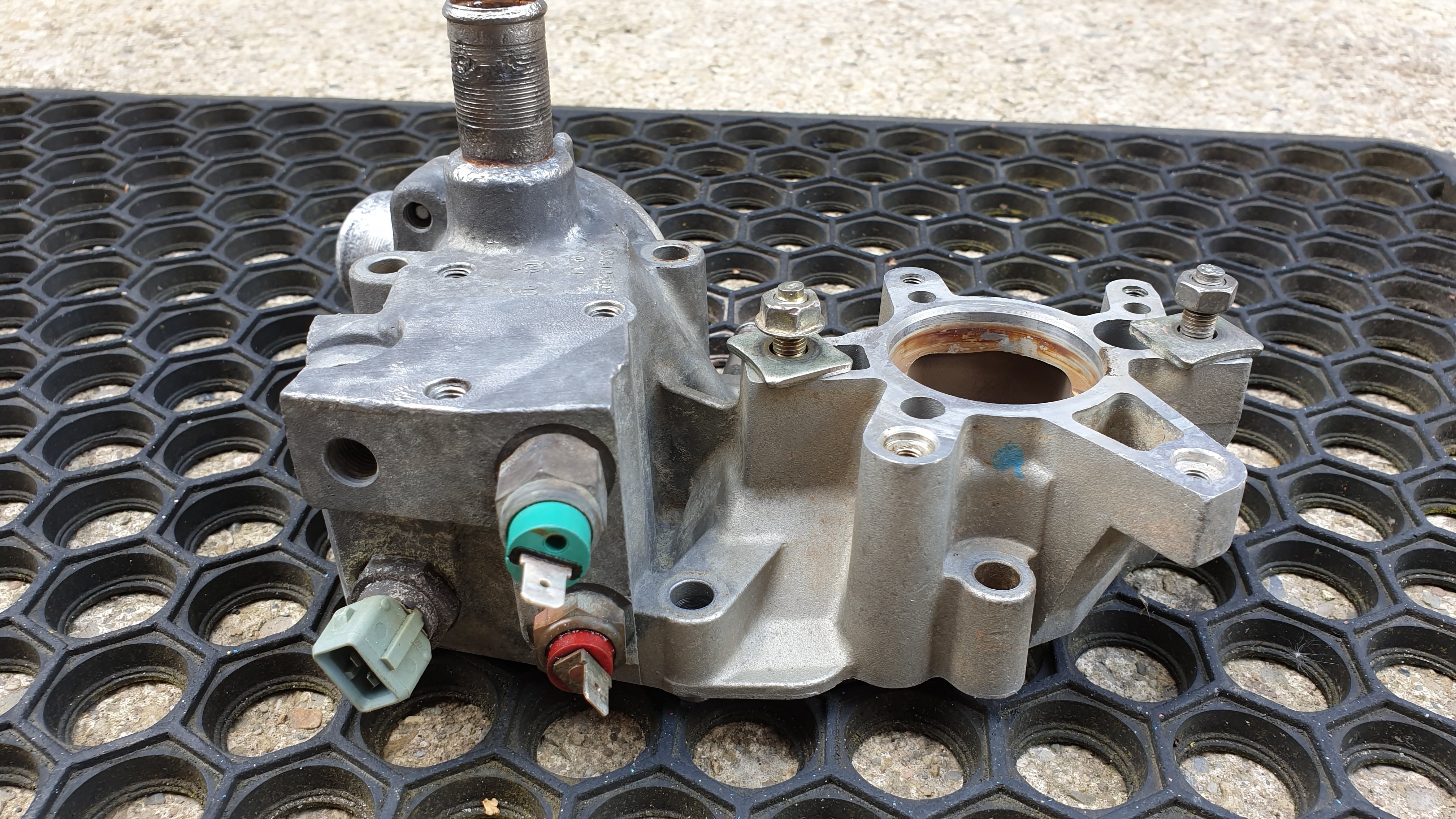

Snapped bolt removed and the thermostat housing is now cleaned up, new thermostat installed and ready to put back together. The small pipe with the tap on was totally blocked up :(

Cleaned!
