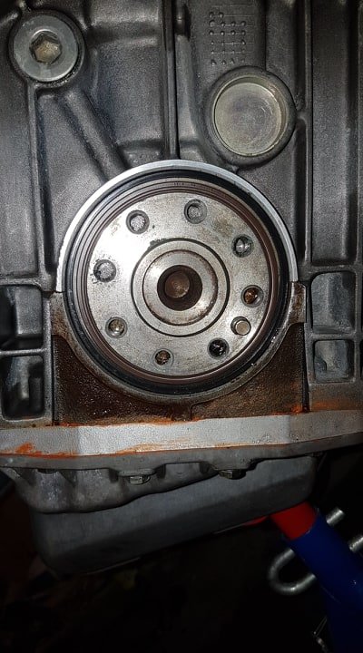

Ok, this is how it looked after taking flywheel off yesterday. I'm starting to think it is the front hockey-stick seal which seem to be the problem?

Whilst I agree that the front hockey stick seal looks to be the one leaking, given the labour required to get to this point and the small cost of the seals in comparison, I'd just replace the lot to be sure.

It was the front hockey seal. It was torn off actually. The rear one looked fine, as did the large oil seal...
