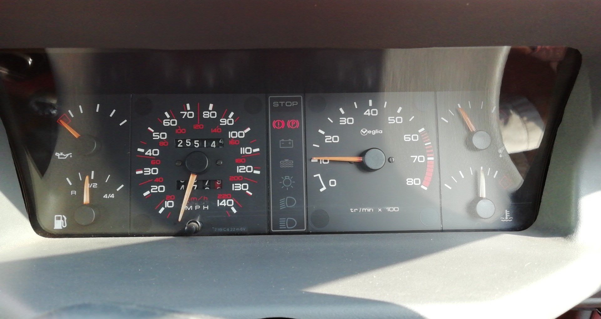

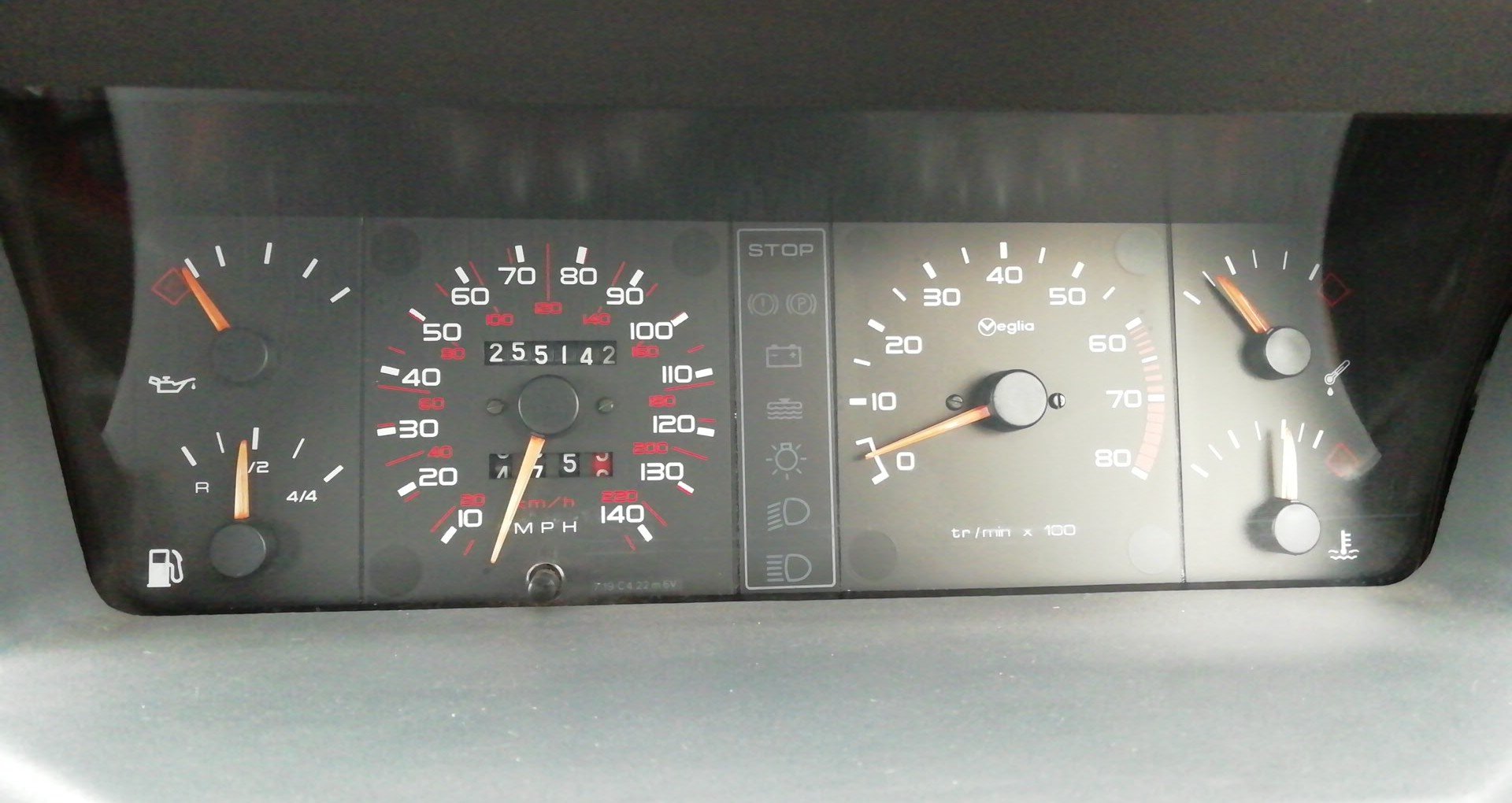

Any thoughts ? It's a standard 8V just rebuilt as most will know. It's running fine under load but the oil pressure gauge always sits low... I thought it was just the guage but obviously not.  See pics showing the dials just after I stopped. The car is idling-ignore the zero rpm.

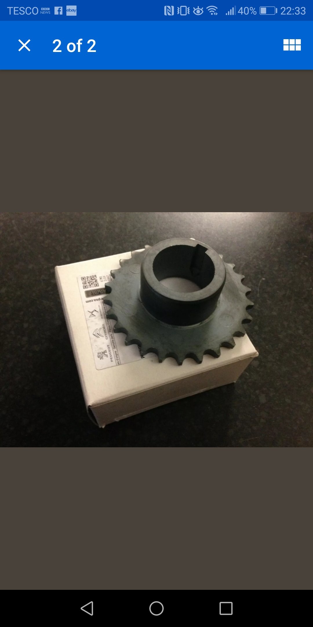

Leslie my gut feeling is that it's something to do with the sprocket on the crank. The actual block is a early 1.6 but it's been built as a 1.9. As said around page 13 or so on my engine build the 1.9 sprocket didnt fit and fouled the block so I fitted the 1.6 ...
Now that 1.6 sprocket is smaller than the 1.9 ... That means unless. Going mad that for any given rpm it will drive the oil pump slower. As it's red hot today and I've caned the car I think the oil has thinned enough that the pump isn't supplying enough pressure . I know the pressure isn't that amazing anyway but as it passed through the rolling road I thought the engine must be basically ok.
So from what I've seen if I fit a GTI6 sprocket that should improve pressure .. I dunno!

Well then its worth looking into Paul but is the gti6 sprocket going to fit or have similar issues ? maybe get one and compare
They appear to be the same as the 1.6 type I fitted
Leslie green
Well it will be about the number of teeth I guess so have a count , if they are the same can't see it helping .

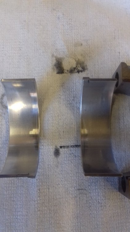

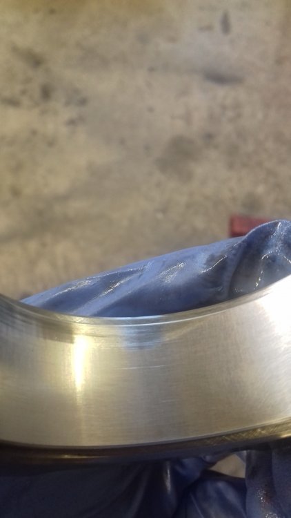

rereading my engine build - when I had the issue turning the built engine by hand I found that the shell on one of the crank journals had an issue- I took it all to bits, cleaned it up and refitted it all.
At the time I didn't think the scuff marks on the shell warranted any attention- see the pics- could this cause the pressure to be low?

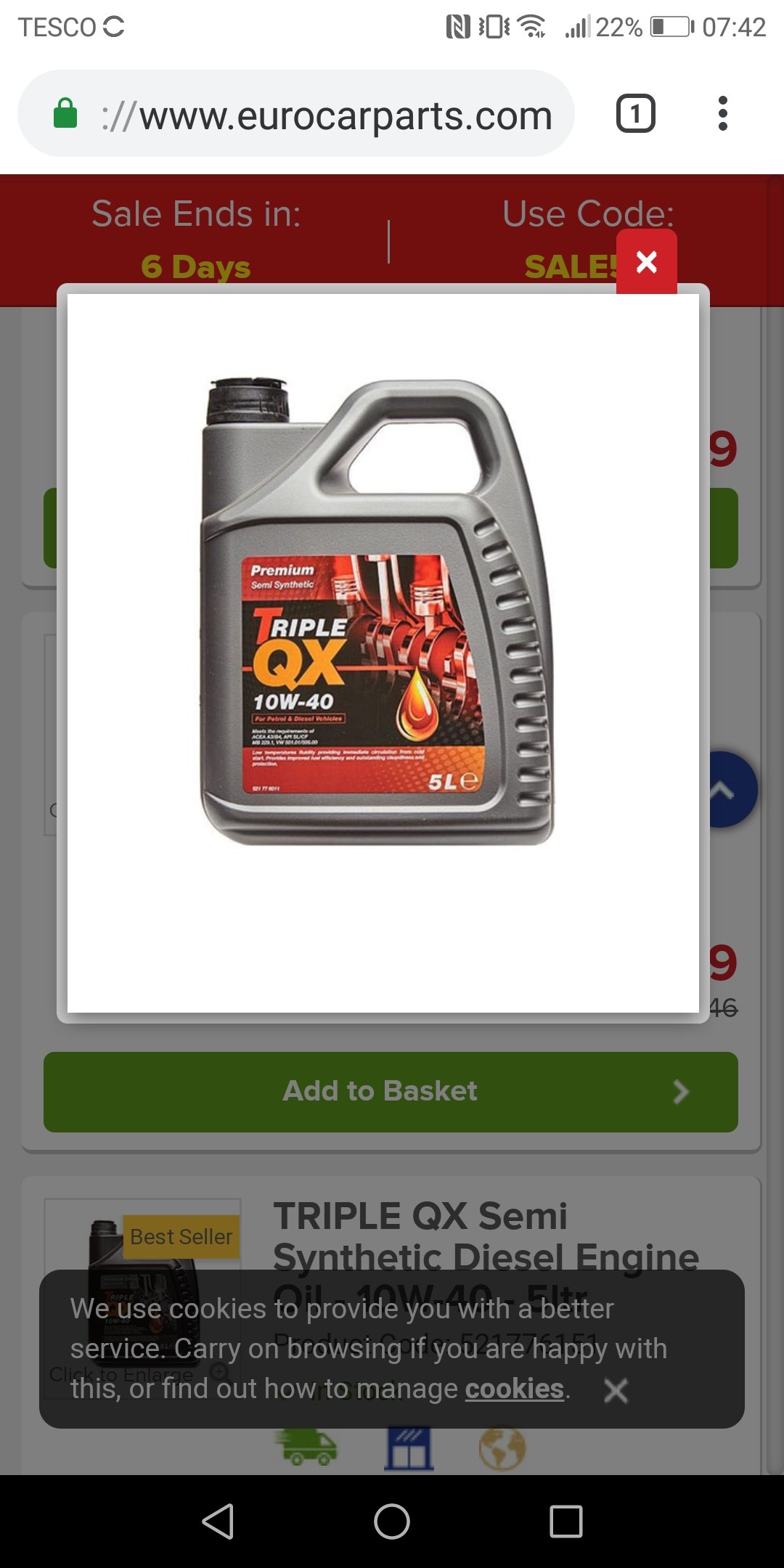

This is the oil it's currently got I'm it

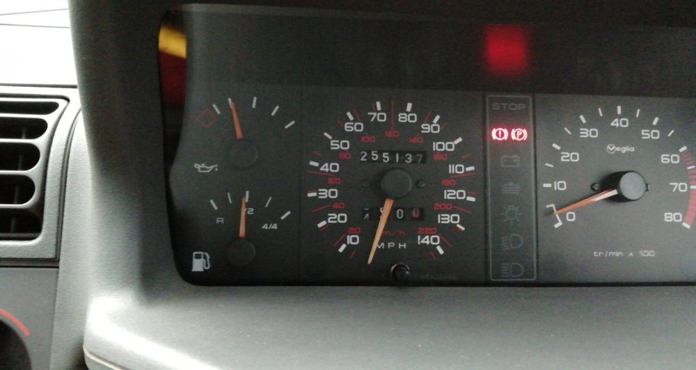

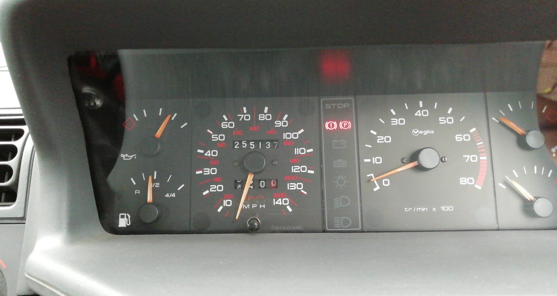

I took a picture of the dash this morning at idle and it looks like this
Pretty normal pressure.

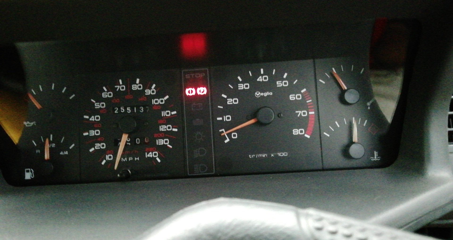

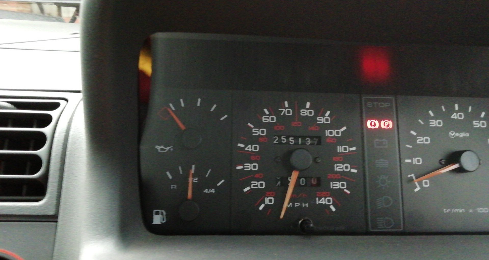

10 mins of driving and at idle I have this
As Tom said above - there's no point whatsoever worrying about oil pressure without using a proper mechanical gauge.  The standard OE setup is at best just a relative indicator, and has caused many a 205 owner unnecessary angst.
As for the STOP light coming on as you came off the motorway and dipped the clutch - how low did it feel like the revs dropped (I appreciate it's hard to be sure if the tacho doesn't work)?  Hot oil and a very low idle would be enough to likely drop the oil pressure low enough to trip the low oil pressure switch, especially if you're running the smallest of the oil pump drive cogs on the crank which turns the oil pump slower.

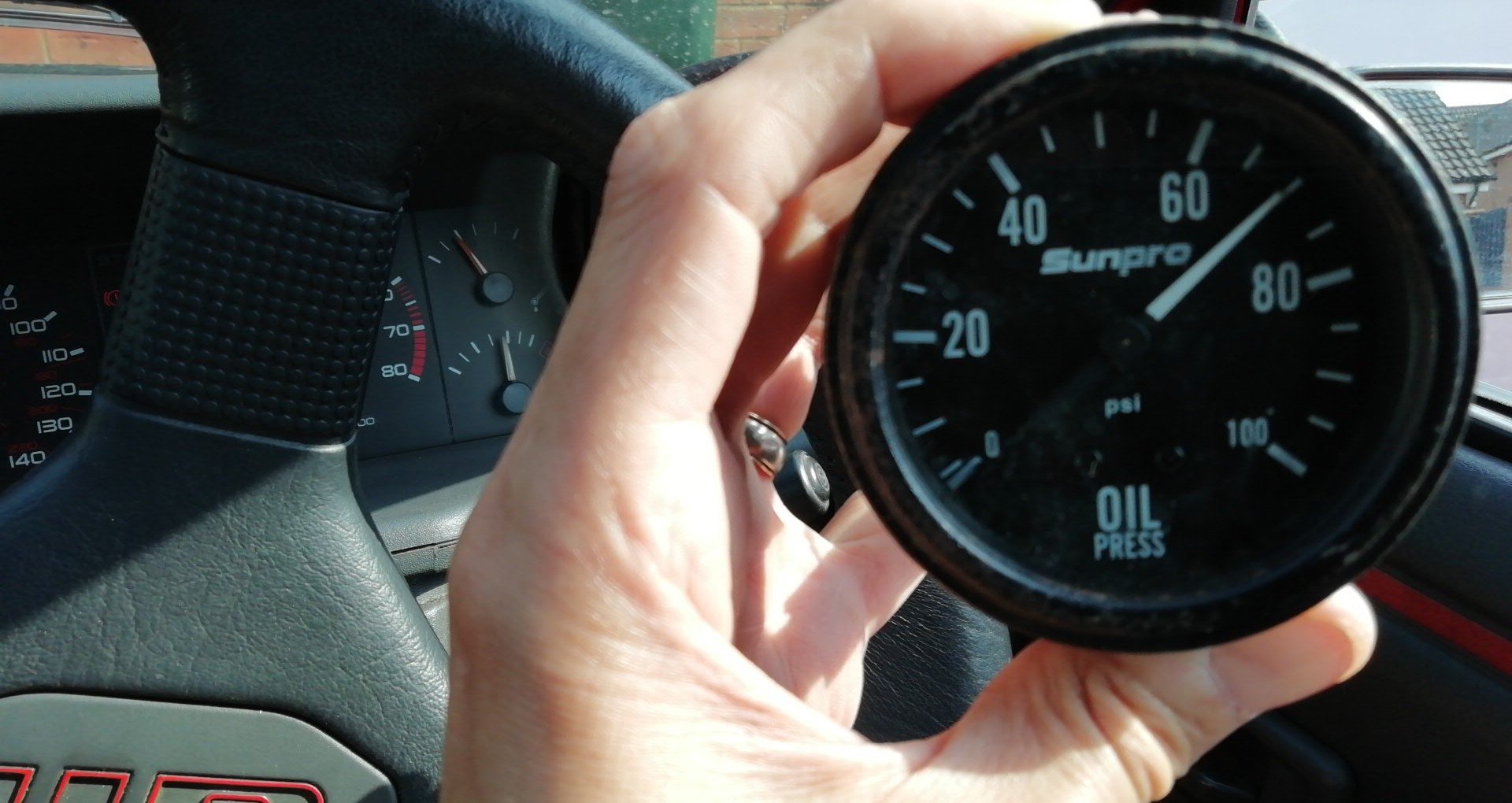

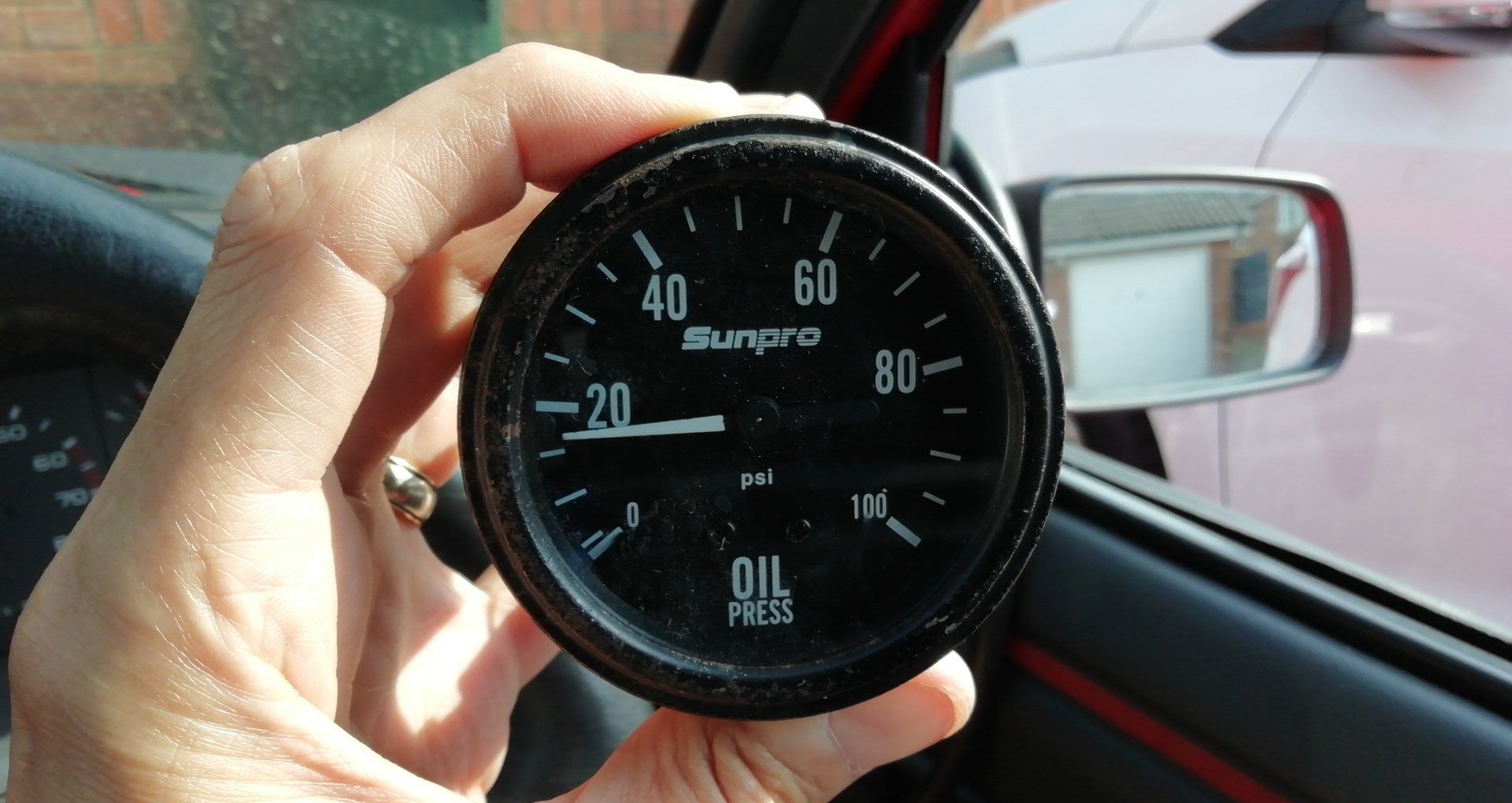

Ok so mechanical guage fitted here are the results.
26psi engine relatively cold after I drove it an hour before (idle)
Edited by Telf

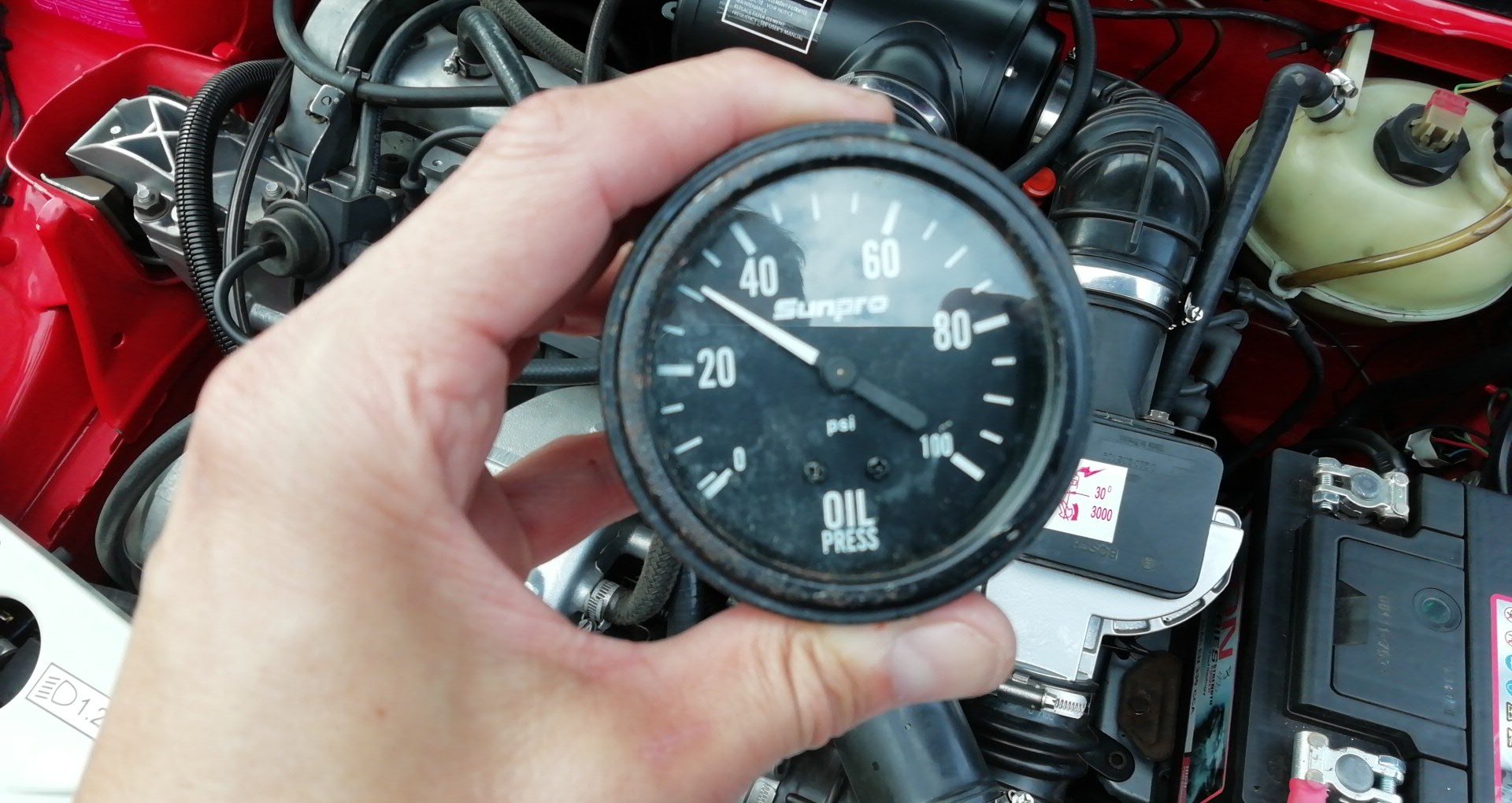

Engine after being driven and left idling on the drive . Fan is cutting in and out. Oil temp and water temp are pretty much the same as last night.
Between 15 and 17 psi
The STOP nor low pressure light have yet come on
Edited by Telf
At just under 6000rpm it's about 70 psi
I’d want to see 20psi hot idle. Try some better oil first of all. I wouldn’t put ECP Triple QX s*ite in my mower. Buy some Millers and try that.
Tom ok I'll try a different oil. Same grade 10W-40? So I take it that it's a little low but not catastrophic?
