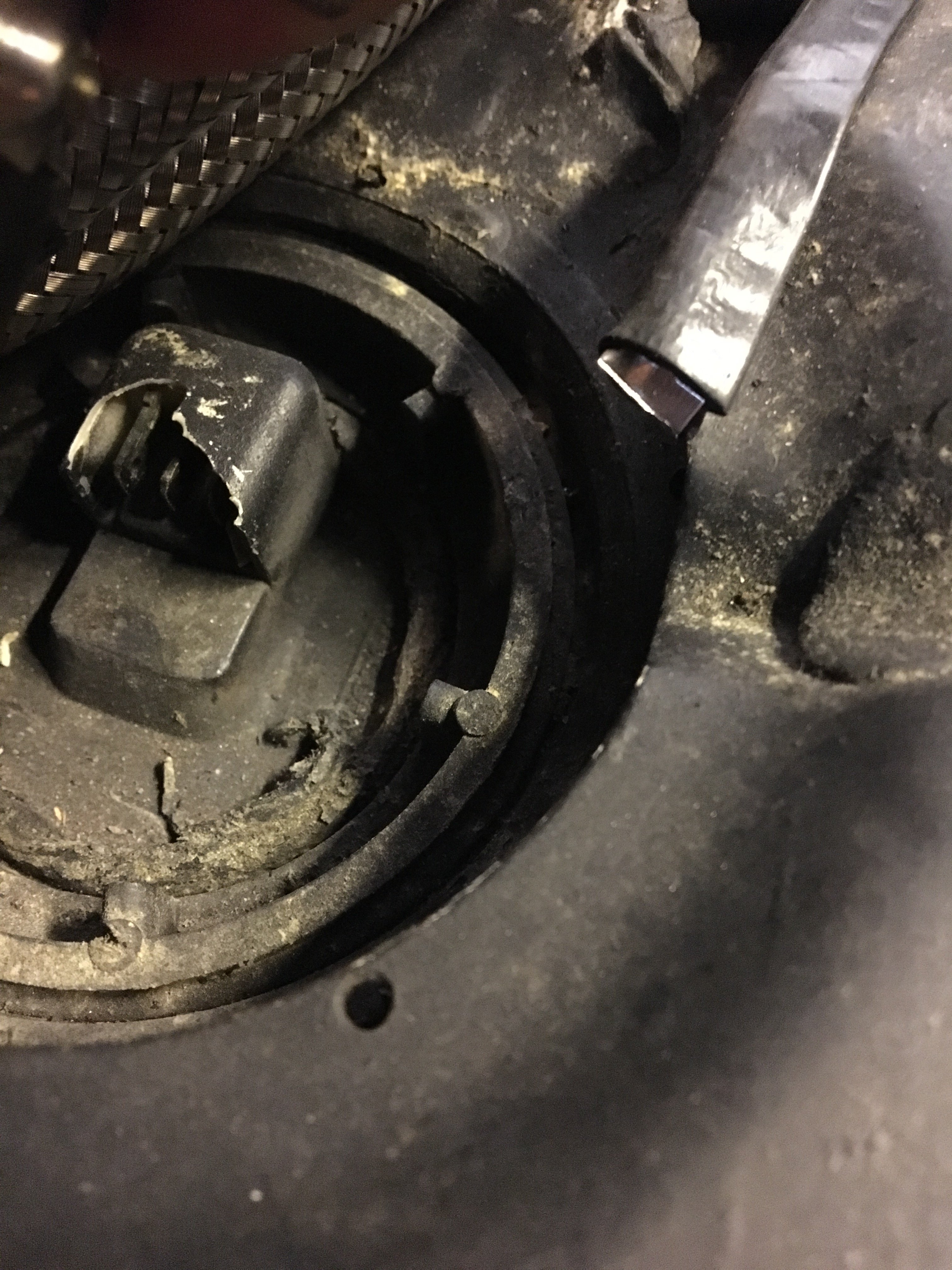

mmt 15 Posted June 10, 2019 Hi guys, how do you keep track of your fuel level? I no longer have the fuel level gauge in the car. The sender unit is however still in the tank. Could it be connected to some after market stuff without too much fuss? Thanks Share this post Link to post Share on other sites
boldy205 75 Posted June 10, 2019 This is a race car? I presume an aftermarket item will run fine with the sender unit, yes. Share this post Link to post Share on other sites
mmt 15 Posted June 10, 2019 Yes- race only. Any one know a gauge which Would fit. Share this post Link to post Share on other sites

jackherer 543 Posted June 11, 2019 Isn't it a three pin connector on the tank sender? The Racetech gauge needs + 12v, - ground and the signal (~, sine wave icon) wire runs to the sender in the tank then the other side of the sender (variable resistor/rheostat) goes to ground. The pins on the sender in the tank are for the gauge, the light and a common ground so now I think about it the light will need ignition switched +12v then the switch will ground it through the common ground pin. Share this post Link to post Share on other sites
mmt 15 Posted June 13, 2019 It is a 3 pin connector. Share this post Link to post Share on other sites
jackherer 543 Posted June 13, 2019 OK so one pin is a common ground, one pin is for the gauge and one pin is for the light. Get a multimeter on it and look for resistance, if the tank is empty you should see a low resistance between the gauge pin and the common ground and almost zero resistance (closed circuit) between the light pin and the common ground. Share this post Link to post Share on other sites
