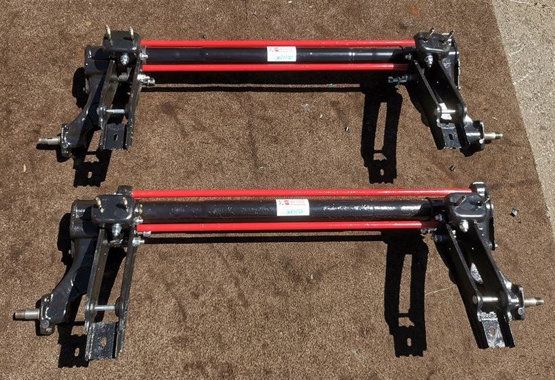

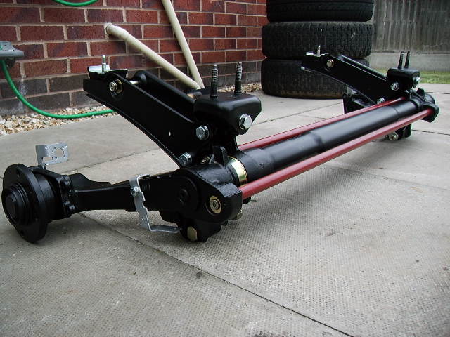

I failed to rebuild a beam during covid lockdown so it's now been done through Axles By Stef.  Stef was very helpful and there's no hesitation from me in recommending him. Photos of finished product taken from his facebook page in July.
I'm going to put some effort into extending the life of the 205 fleet so I'm now scouring the forum for advice on underbody protection and inner wing repairs (and suggestions for welders)......
