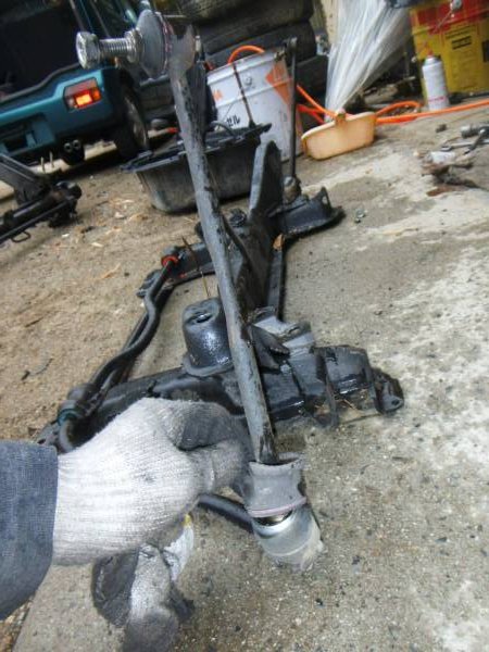

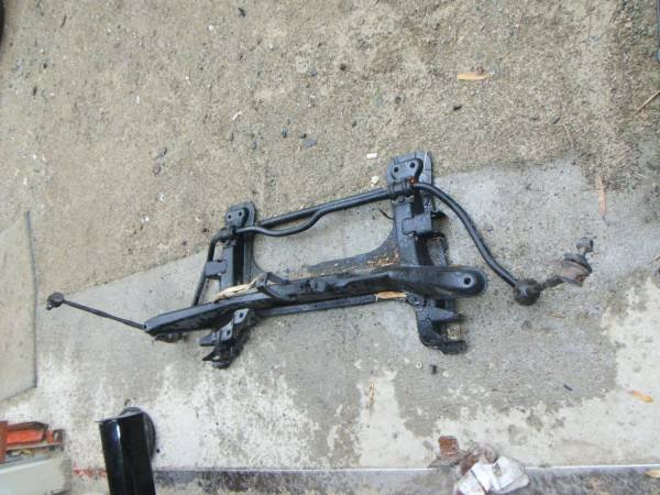

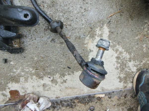

alanx 1 Posted May 6, 2019 Hi guys this is my first post. I am from Hong kong and I have a 92 GTI 1.9 and a 93 CTI 1.9. I am planning to overhaul the suspension of the 93 CTI and i found a subframe from a breaker. The breakfer statued its from a 205 Si but it looked like a subframe from a GTI to me am I correct? Thanks! Share this post Link to post Share on other sites
jackherer 543 Posted May 6, 2019 It has the rear wishbone mounts so it is a GTI subframe. 2 hours ago, alanx said: Hi guys this is my first post Welcome to the forum! (backdated to 2011 :)) Share this post Link to post Share on other sites

alanx 1 Posted May 6, 2019 2 hours ago, jackherer said: It has the rear wishbone mounts so it is a GTI subframe. Welcome to the forum! (backdated to 2011 :)) Thanks that would be a good upgrade to the CTI Share this post Link to post Share on other sites
