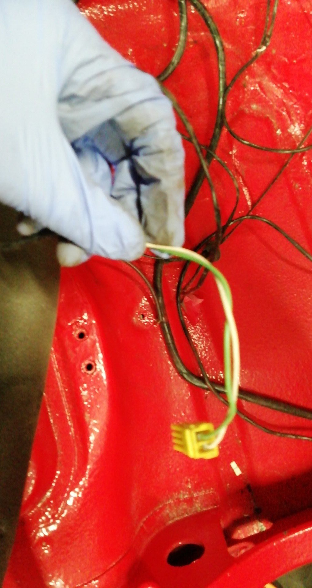

Telf 222 2 Cars Posted April 10, 2019 (edited) Cable 214 and 214a as pictured. Any idea what it plugs into please? Cable breaks off from a loom that runs from the passenger rear to the fuse box. I've no idea what it's for!!! Edited April 10, 2019 by Telf Share this post Link to post Share on other sites
soundguy 13 Posted April 11, 2019 Looks indicator-ish, but could also be a driving lamp connector. Share this post Link to post Share on other sites
Andy 105 1 Cars Posted April 11, 2019 Numbers are a puzzle . I have not managed to find them in the Haynes wiring diagram Share this post Link to post Share on other sites
Tom Fenton 1,524 Posted April 11, 2019 Speaker wiring I think 1 Share this post Link to post Share on other sites
B1ack_Mi16 67 Posted April 11, 2019 From my own investigation when I assembled the 205 last year. Speaker Left Front 211 211A Speaker Right Front 212 212A Speaker Left Rear 213 213A Speaker Right Rear 214 214A 1 Share this post Link to post Share on other sites
Andy 105 1 Cars Posted April 11, 2019 Ah. Did not think of that one. Excellent work. Share this post Link to post Share on other sites
soundguy 13 Posted April 11, 2019 oops. Sorry, I was waay off the mark. Share this post Link to post Share on other sites
Telf 222 2 Cars Posted April 11, 2019 Puzzled it out earlier but thanks guys. All wiring done now I think .. Share this post Link to post Share on other sites
