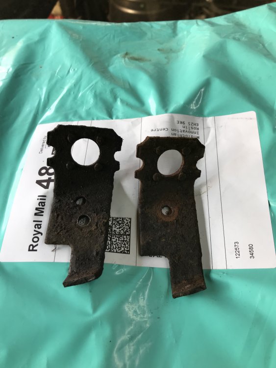

I am missing the brake line brackets for the rear brakes
Specifically  the bracket the supports the rigid pipe after the compensator as it joins the flexible hose (both sides) and the bracket on the trailing arms that supports the hand brake cables and I think the rigid hose
Looking on service box I cannot see them listed- does anybody know if there is a part number for these brackets or a picture of them would be handy so I can show the person who striped my car and axle down and has lost them.
any help would be great

Two I’ve got, off a 1.9, one has got an extra non standard hole drilled in it, other than that it looks like they are the same so not sided. Not for sale I’m afraid but they are very simple and wouldn’t take much to make something.
farmer
Stew has a new one of mine I will nudge him to make them if poss
