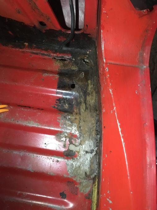

Danez 6 1 Cars Posted March 10, 2019 (edited) Might not be enough detail to say for sure but I'm wondering what you think. Obviously there's more rust to take back but it feels fairly solid where the rust in the corners are (Passed the screwdriver jab test) As you can probably guess a lot of it moves if i press down on it where it's bad. I personally think it can be saved it's not that bad...best methods for restoring it? just cut out and weld bits in?! Anyway here are some pictures cheers Edited March 10, 2019 by Danez Share this post Link to post Share on other sites
DamirGTI 362 Posted March 11, 2019 If you can weld , no problem at all . Cut the rusted areas off and weld in patch panels , other surface rust areas clean up and treat with rust converter . D Share this post Link to post Share on other sites
Andy 105 1 Cars Posted March 11, 2019 Agreed. The hard bit is making up new sections because of the ridges in the boot floor . The floor joins the rear cill via a return flange that points downwards . Remove all the rusty metal , in sections , carefully. Occasionally, boot floor sections come up on eBay. Might be worth looking for a good one that you could use to provide patches for yours . Andy Share this post Link to post Share on other sites
MrAndy 10 Posted March 11, 2019 It looks like it can be saved OK. They always get bad from the corners. I have the same situation in one of my cars and I also have a good spare floor which I will use. Anyway I have been thinking how have you usually solved the point where the bar goes from left to right under the car? Meaning, remove the floor and the bar together from the car or leave one or the other to car and replace the other one separately... -A- Share this post Link to post Share on other sites
