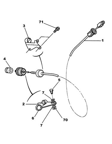

jackherer 543 Posted March 3, 2019 Is this the car with a slipping clutch from your other thread? You're not going to stop a clutch slipping with a new cable... I did just have a thought about it though, did you have the dowel rod present between the clutch arm and the clutch fork? (number 2 on this diagram) Share this post Link to post Share on other sites

jackherer 543 Posted March 3, 2019 The dowel goes between the clutch fork and the clutch arm, if you don't have that it's not going to work properly. I just found this photo: Share this post Link to post Share on other sites

jackherer 543 Posted March 3, 2019 The dowel pin thing isn't held in by anything other than the tension of the cable so if you've undone the cable it would have fallen off then! So it probably wasn't there in the first place, when you had to tighten the cable I suspect you were compensating for the missing dowel which wont work and might be why your clutch started slipping. It's just a pin with rounded ends about 1" long, you can improvise something fairly easily. Or it's Peugeot part number 212046 1 Share this post Link to post Share on other sites

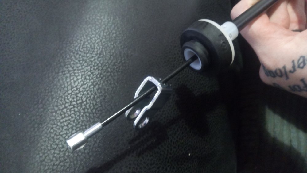

4ll5op 8 Posted March 3, 2019 this is the pedal end. its the rubber bit nearest pedal i cant remove was hoping there was a knack or certain tool someone uses Share this post Link to post Share on other sites
Tom Fenton 1,650 Posted March 3, 2019 Pull harder or try and get a screwdriver in and push the lip of the grommet through to get it started. It’s awkward in the footwell though. Share this post Link to post Share on other sites

jackherer 543 Posted March 4, 2019 100% yes. In the yellow circle in the photo above are the two parts either side of the rod just touching each other on your gearbox? If so that is definitely wrong and wont work properly if at all. Just find a bit of metal rod about 1 inch long and put that in there, you need something for sure. The old one is probably on the road somewhere after falling out. Share this post Link to post Share on other sites

jackherer 543 Posted March 5, 2019 They're probably about 8-10mm max. If you look at the clutch fork and arm where the rod sits there is a cup shape to receive it and it needs to be rounded to match that. Share this post Link to post Share on other sites
