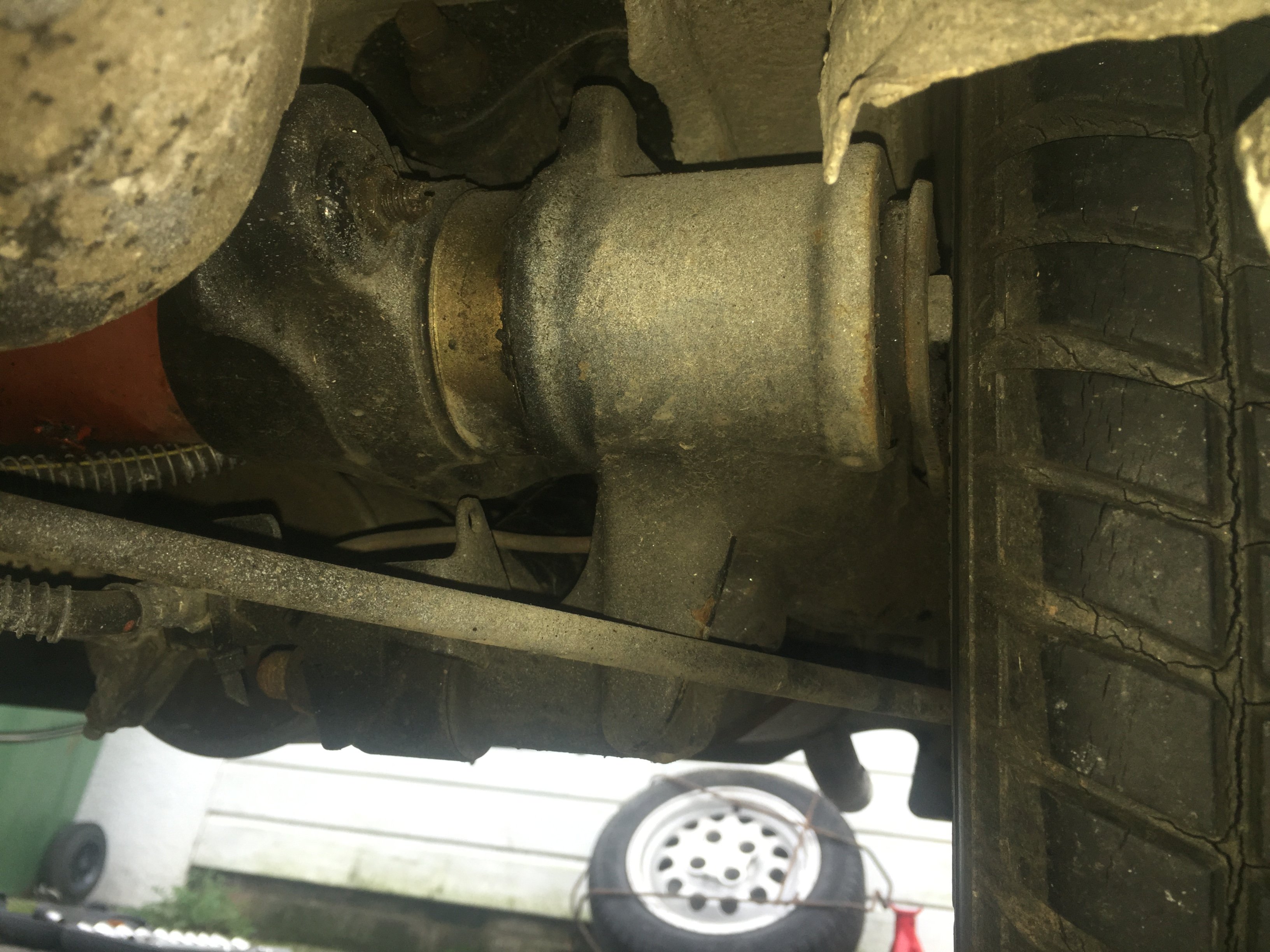

Harrybowling 1 Posted January 1, 2019 Hello hope I’ve posted this in the right place brought my first 205 a month ago now. Noticed a knocking coming from the back on the drive home thought it was exhaust. just had some time to give it the once over and noticed the tyre was rubbing against the bolt! It has been lowered and the bloke said the rear beam had a rebuild not long ago. Any one know what is going on please I have no idea. Many thanks! Share this post Link to post Share on other sites
SRDT 232 Posted January 1, 2019 Wrong screw, there is only a plastic screw here so that the thing is still clean when you want to extract the ARB. Also the ARB lever should be closer to the arm. Share this post Link to post Share on other sites
Ozymandis 103 Posted January 1, 2019 That tyres knackered, bin it and live longer. Anti roll bar end plate is assembled wrong needs to be drawn further in, and shouldnt have a hex head bolt stuck out, just a plastic plug to keep muck out. Share this post Link to post Share on other sites
Harrybowling 1 Posted January 1, 2019 3 minutes ago, Ozymandis said: That tyres knackered, bin it and live longer. Anti roll bar end plate is assembled wrong needs to be drawn further in, and shouldnt have a hex head bolt stuck out, just a plastic plug to keep muck out. Thanks for the reply lucky the tyres needed replacing anyway! Share this post Link to post Share on other sites
