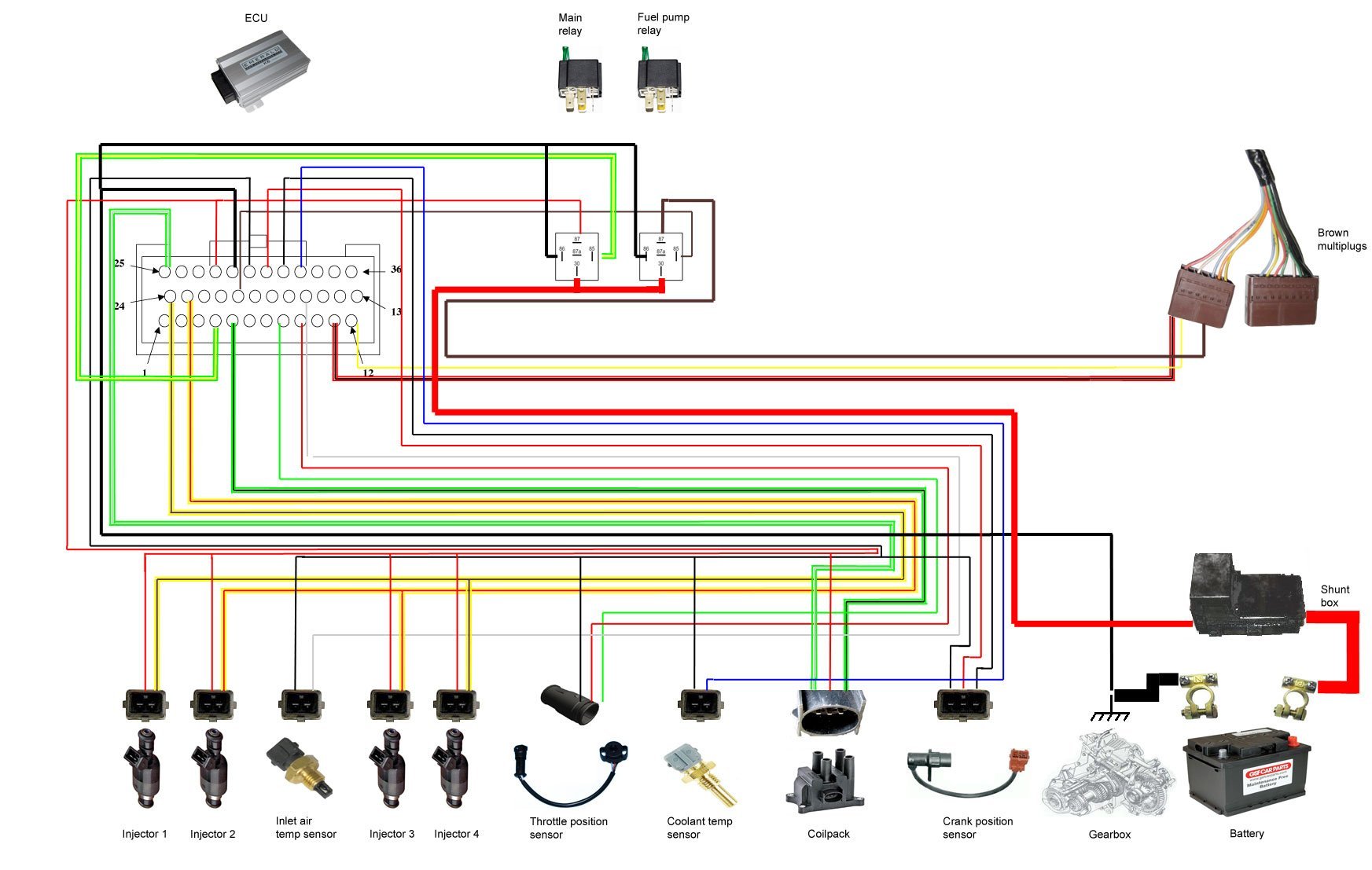

Telf 238 2 Cars Posted January 1, 2019 hah yeah the engines still not finished- ive some more updates to add. I've got a diagram that Jackherer gave me in regard to the engine loom on a standard 8V. Is that what you need- im making a new loom at the moment for a K3. Share this post Link to post Share on other sites

Telf 238 2 Cars Posted January 1, 2019 Diagram is from Jackherer whohas guided me through this whole process-cant thank him enough. This is second hand knowledge from him and just the info on what I've done with his help. Share this post Link to post Share on other sites
MrAndy 10 Posted January 2, 2019 The diagram is ephic!! I'm following all this threads with a great intrest and considering to do a engine/ECU swap some day also. -A- Share this post Link to post Share on other sites
ArthurH 12 Posted January 2, 2019 15 hours ago, Telf said: I've got a diagram that Jackherer gave me in regard to the engine loom on a standard 8V. Is that what you need- im making a new loom at the moment for a K3. Thanks Paul, the diagram is very useful, but it is more the under dash / fuse box aspects of the standard loom that I need the info on - specifically the switch pinouts Share this post Link to post Share on other sites
