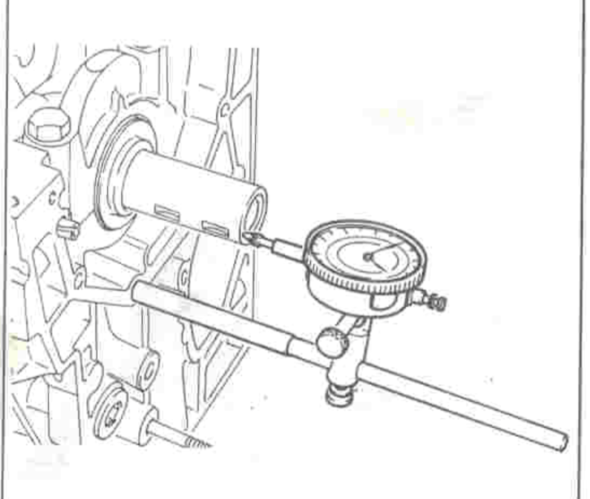

I would have thought a clock would be a better way of measuring float....
Unfortunately I don’t happen to have 0.07 mm in feeler gauges! 0.05 mm fits fairly well, 0.1 mm doesn’t.

So I had another look at it this morning.
Whilst applying pressure I manage 0.1 mm of movement on the clock and I can get the 0.1 mm feeler gauge in between the thrust bearing and crank. I’m happy that this is acceptable float; I’m not applying excessive force to achieve this and I don’t think it should be free float that is measured; it should be total float/travel.

This is the best way to do it. As you say, 0.07-0.27mm.1479143485_ScreenShot2018-11-28at7_56_45PM.png.72ba5049296da5798e7c31a493b32d7a.png
Grenouille
Thanks PeterT for your reply, I saw the same graphic elsewhere and lo and behold found that the upright of my mag base had the exact same thread as one on the block. I felt as if the stars had aligned when that happened!
