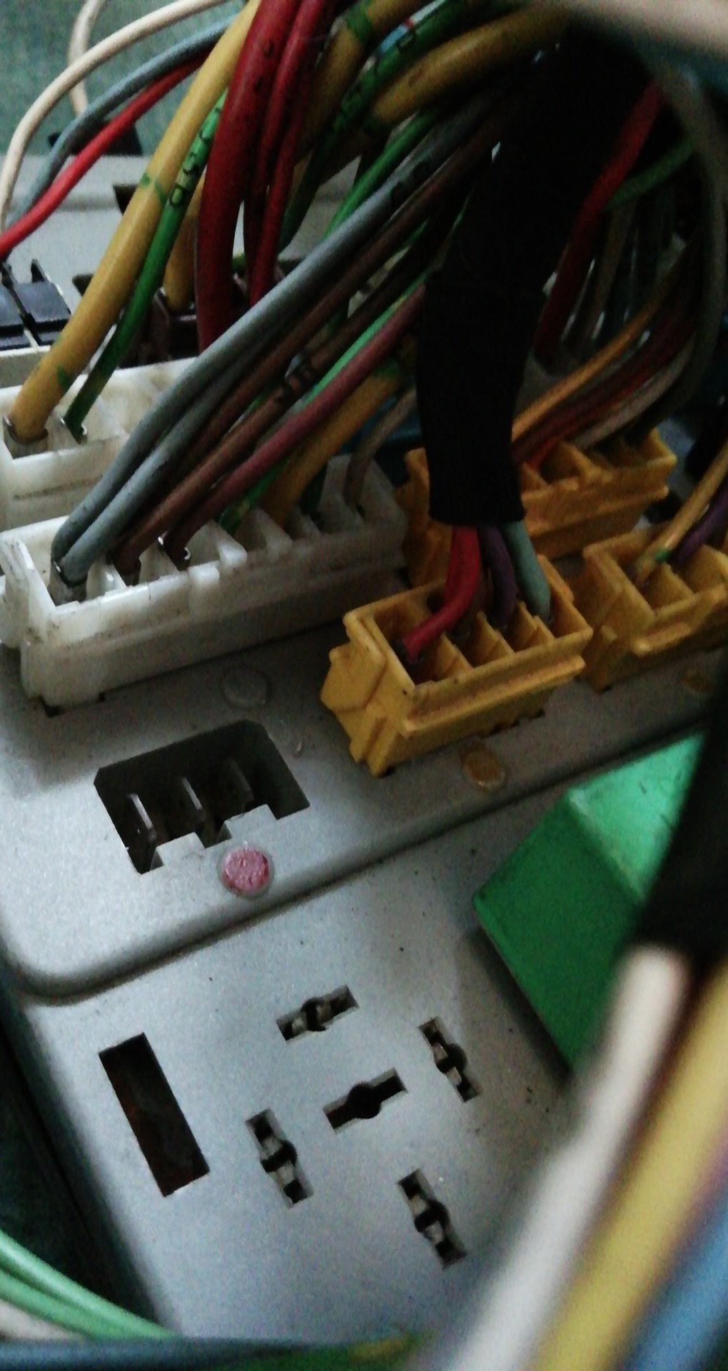

Telf 238 2 Cars Posted November 12, 2018 Number 1: ----------------- So here's the first one: socket in the corner of the fuse box. With every plug refitted there doesn't seem to be one here. Anyone any idea? I think it's socket X which seems to be for the ancillaries in the doors? Share this post Link to post Share on other sites

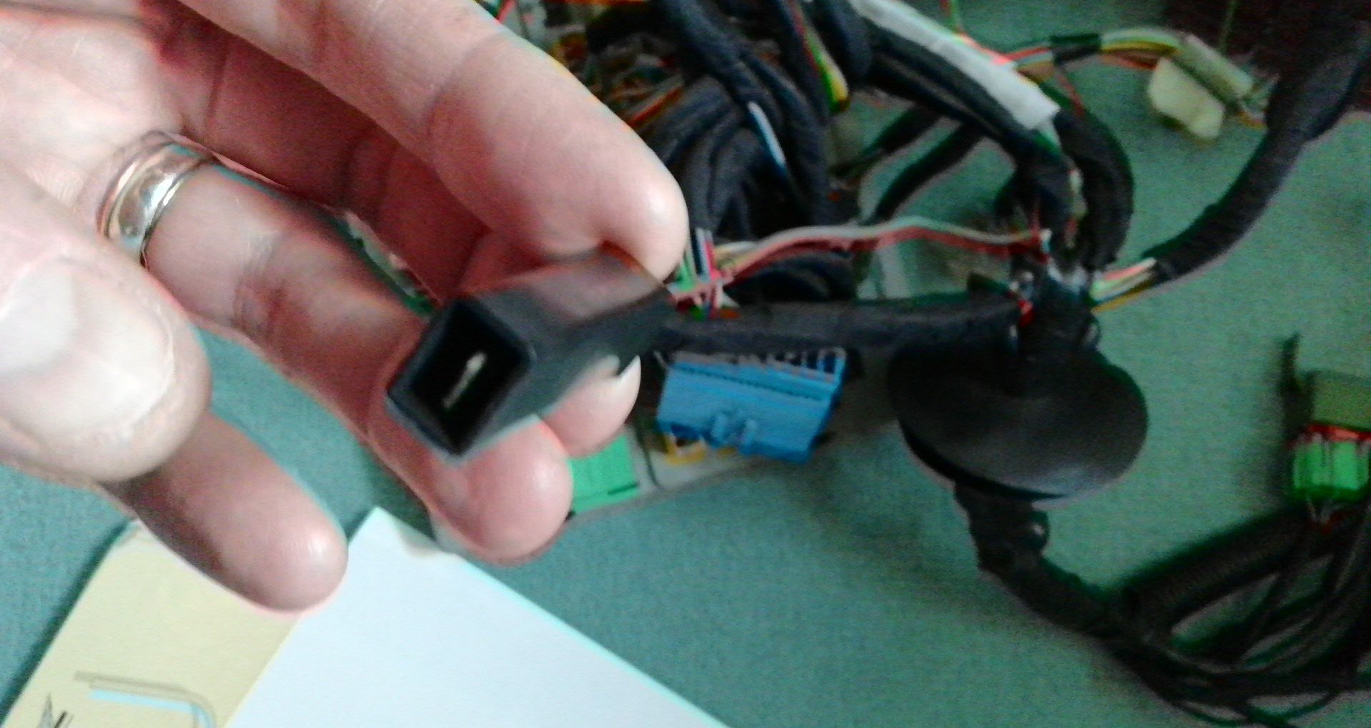

Telf 238 2 Cars Posted November 12, 2018 Number 2 ---------------- Heres number 2! A single spade connector coming on a short lead from the bulkhead seal . The code on it may read C9??? Share this post Link to post Share on other sites
Andy 105 1 Cars Posted November 12, 2018 For the number 1 question, according to the Haynes manual, one wire from socket X, number 100 goes to the central locking control switch. I have just checked my car, phase 2, with central locking but not remote , and socket X is unused 1 Share this post Link to post Share on other sites
