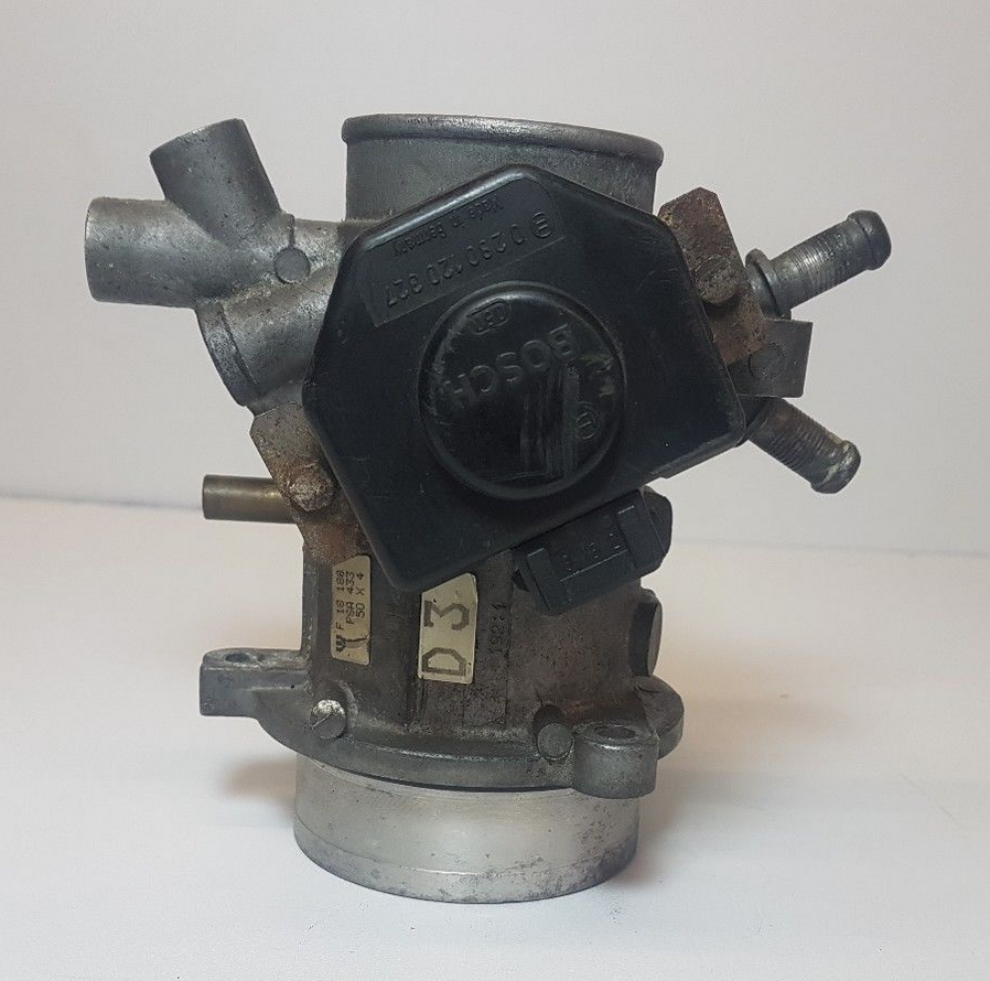

Im not sure the 8v tps would work, as its a on off switch from memory. The gti6 sensor has been done many times and uses an adapter plate to mount. Miles offers a tb adapter to run a complete gti6 tb, though a tad expensive for a cheap homebrew motor. You can probably make an adapter plate yourself (bonus of larger body and a modern idle control).
Not sure if you're restricted, but you're not mega £££ away from running throttle bodies...
jackherer
The 8v one is indeed a switch only, this is why Paul is looking to replace it. Is there no OEM TPS that will fit without an adaptor? What TPS does the MAP sensor based ECU from the ZX (MP3.1?) use?

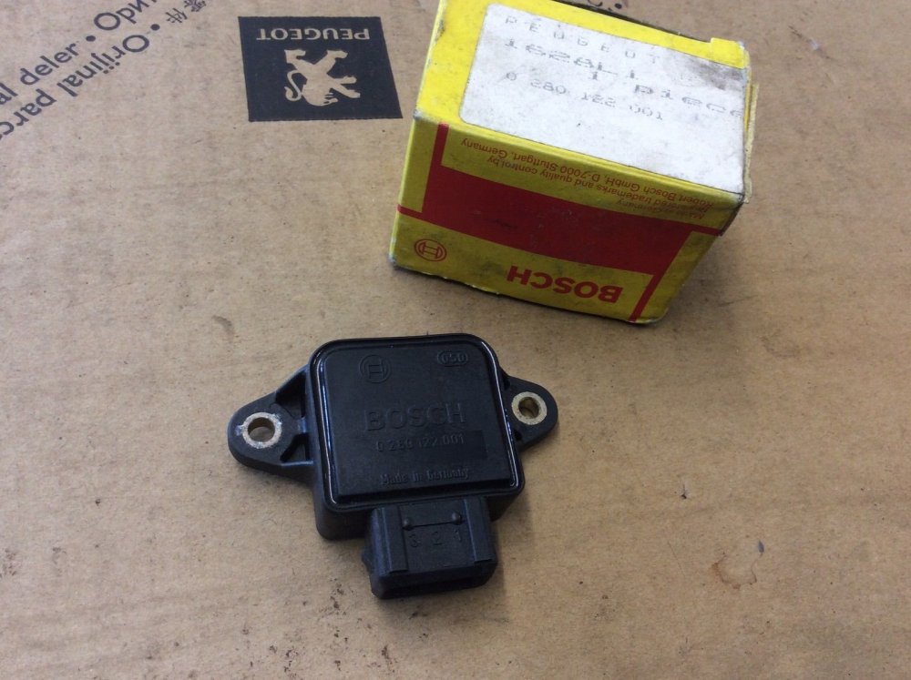

Further to that thought I just looked up the BX GTI part number, they changed from the 8v style switch to a proper TPS around 1993 but using the same Mi16 style throttle body.
The part number for the later BX is 1628 L1, does that mean it will fit straight onto a 205 with no adapter?
Anthony
Not sure about the BX one (the one in the photo above subjectively looks too small, similar to a GTi-6 style one) but I can confirm that the ZX 1.9i Volcane TPS has the same bolt spacing but a different fitting on the end of the throttle spindle (it's a flat rather than the D shape of a 205).  Infuriating really as the throttle body itself is otherwise identical to a GTi one and the inlet manifold is nigh-on identical to a late 205 GTi CAT inlet other than the map takeoff.

ive actually ordered the one pictured above that Kieran listed, Whilst im thinking about it does anybody have a Map for an emerald ECU for a 8V so I've got a starting point to get it running ?

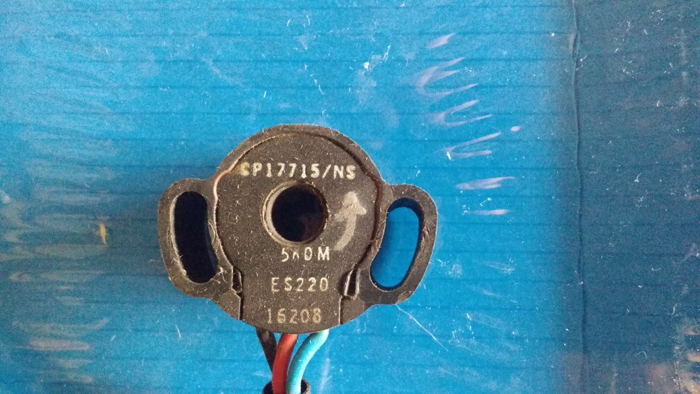

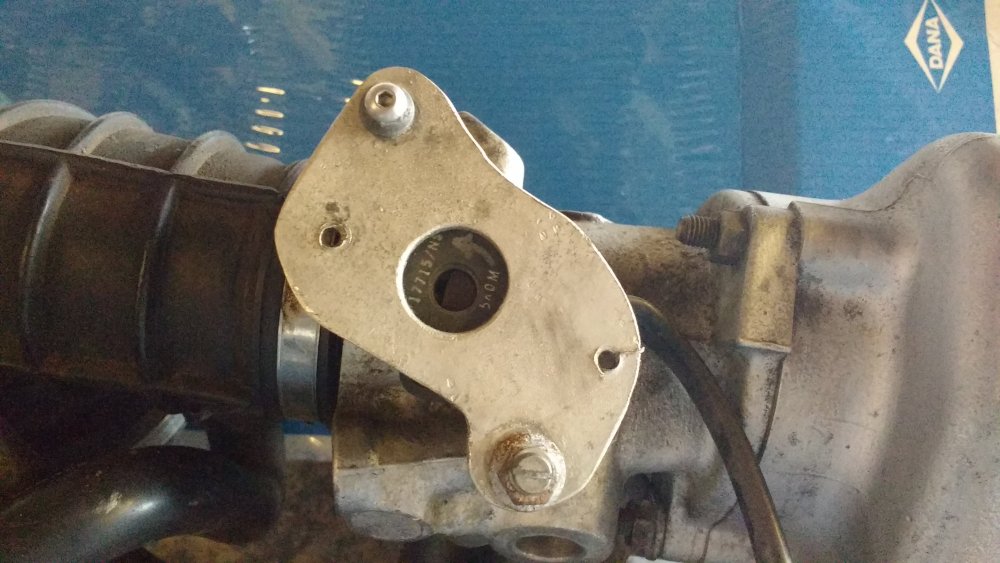

Having read this thread, I thought I'd better check which sensor my Son has fitted to his 8v 1.6.  From the photos, you can see the mounting is obviously homemade.  Do the part number help anyone identify it for me?   I was unpleasantly surprised having taken it off for the photo, that there is no positive location for the sensor in terms of rotation.  How critical is that?IMG_20190131_121257861.thumb.jpg.e2b64ac4318271c09c9b806afa04751f.jpgIMG_20190131_121524149.thumb.jpg.b5fd386495f61719903e4435d5c5c845.jpg
looks like a penny and giles type sensor commonly found on jenvey throttle bodies.
jackherer
It's the same fitment as the Colvern ones that Jenvey and Emerald supply. IIRC you have an Emerald which is why that will have been fitted.
Recently I discovered that it is a Rover part that they have based them on. I bought a brand new OEM Rover TPS for £17 delivered and it works much better than the £70+ Colvern ones ever did. I was going to buy one of the P&G ones you have but they are very expensive and two people I've spoken to who have them have had failures so I'm not sure it is worth the price. https://www.ebay.co.uk/itm/131592980347

Thanks Mei and Kieran.  So this is a 'proper' sensor, not just an on/off switch as per original fitment?  I can probably get it very close to where it was by lining up the part number through the mounting plate hole as per my first photo before I undid the two fixing screws (this could be a blessing as I discovered one was loose anyway :rolleyes:).

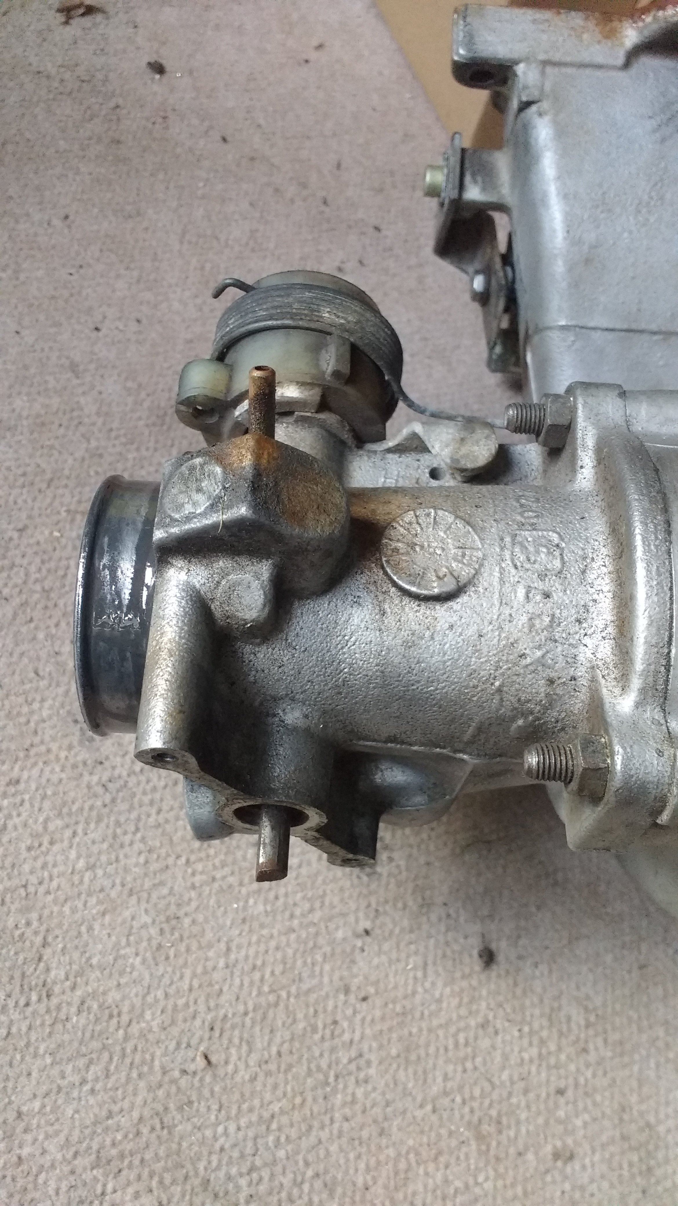

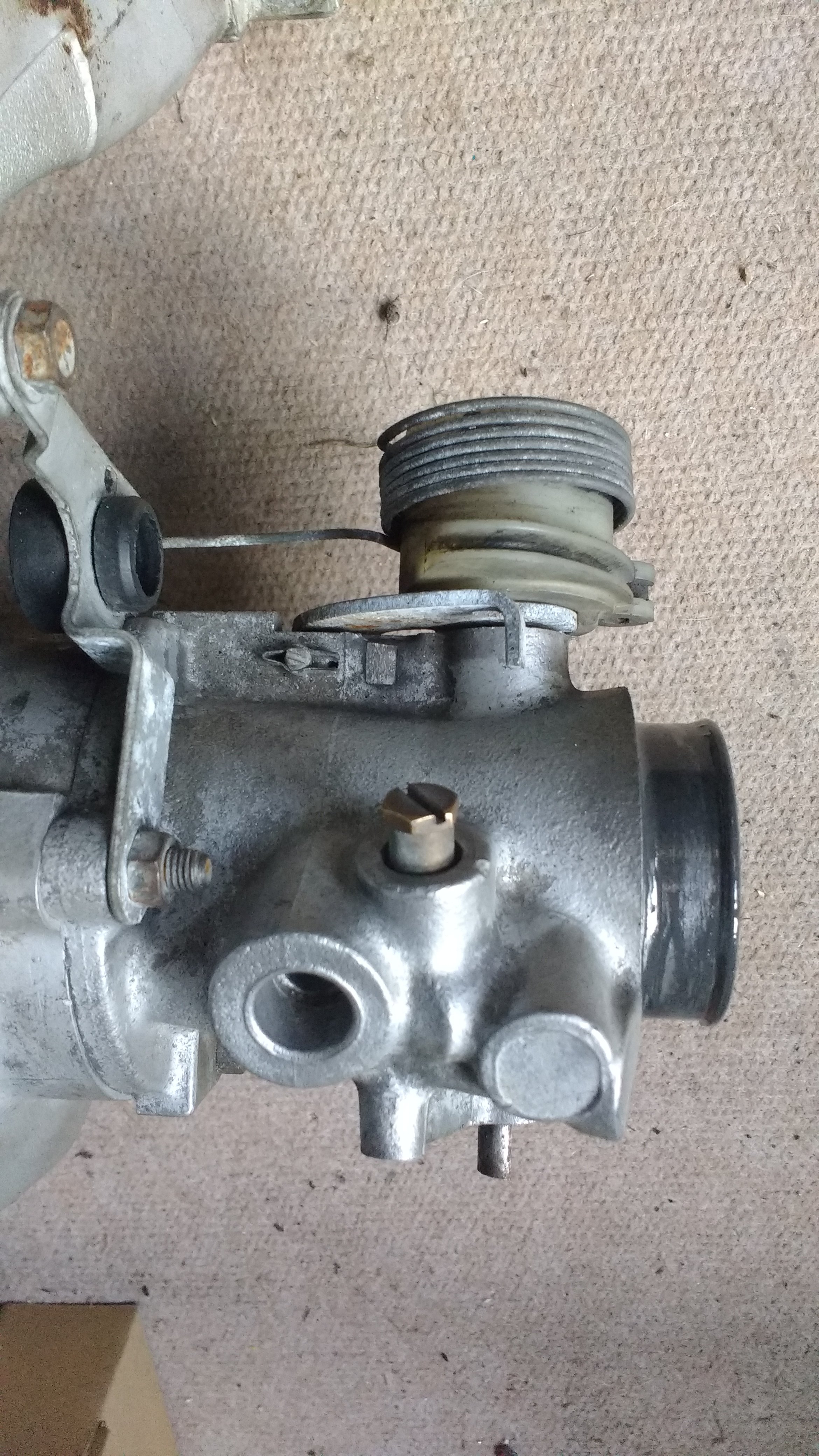

The throttle sensor probably wont affect the over sensitivity you're describing, for that to happen too much air must be getting past the throttle plate. Is that an original throttle? I think it is but it has maybe had some outlet tubes removed? And is the quadrant that the cable attaches to original too? This is an original TB and TPSwitch for reference:

Thanks Kieran And Mei.  Having see your picture of the standard throttle, I thought I'd better post my son's...
