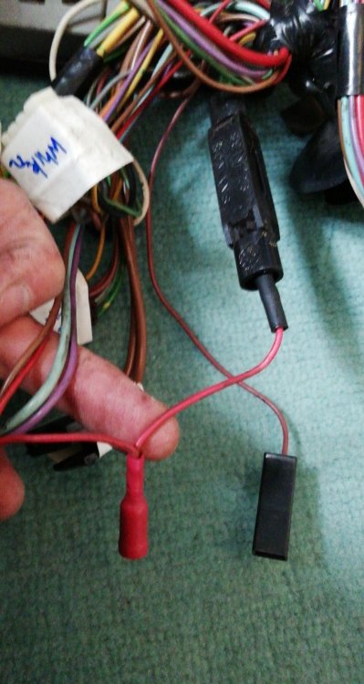

Telf 222 2 Cars Posted November 10, 2018 I'm just sorting the wiring in the fuse board area. Came across the block pictured . It has a SIEM label omit and contains a fuse. I'm presuming it's for the spots? It terminates at the yellow plug pictured in the fuse board Share this post Link to post Share on other sites

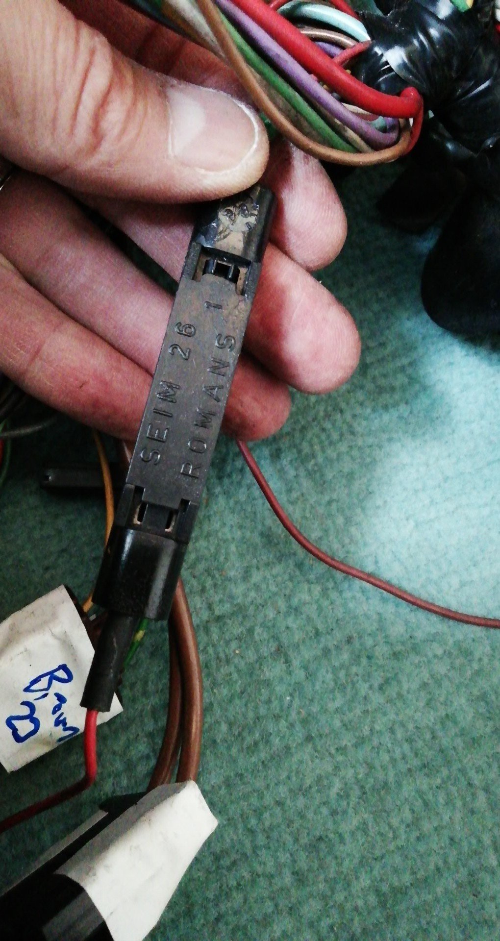

Telf 222 2 Cars Posted November 10, 2018 It's also got this gash jumper on it which I presume shouldn't be there! Share this post Link to post Share on other sites

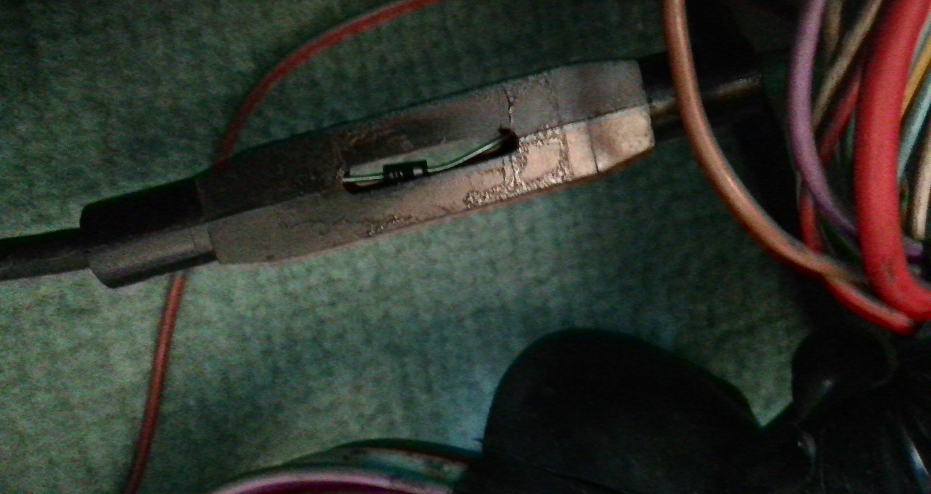

jackherer 543 Posted November 10, 2018 I can't remember what that is for but it's not the driving lights, it says 'SEIM' not "SIEM'! Also is it definitely a resistor? I seem to recall a part like that with a diode in, presumably to stop something being backfed...? The red DIY crimp connector is definitely not original. Are there any wire numbers visible? Share this post Link to post Share on other sites
Telf 222 2 Cars Posted November 10, 2018 Think the wire code is 32M Share this post Link to post Share on other sites
jackherer 543 Posted November 10, 2018 32A is an ignition switched +12v live feed so that is probably true of all wires beginning with 32. The badly crimped on connector was probably supplying power to an aftermarket device of some sort that only came on with the ignition. M is used for grounds (Masse en Français) so it probably isn't an M. That's definitely a diode. Share this post Link to post Share on other sites

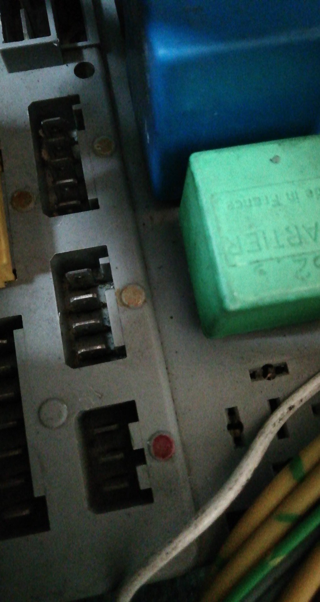

welshpug 1,622 Posted November 10, 2018 which pin of that yellow plug in the fuseboard does it go to? Share this post Link to post Share on other sites
