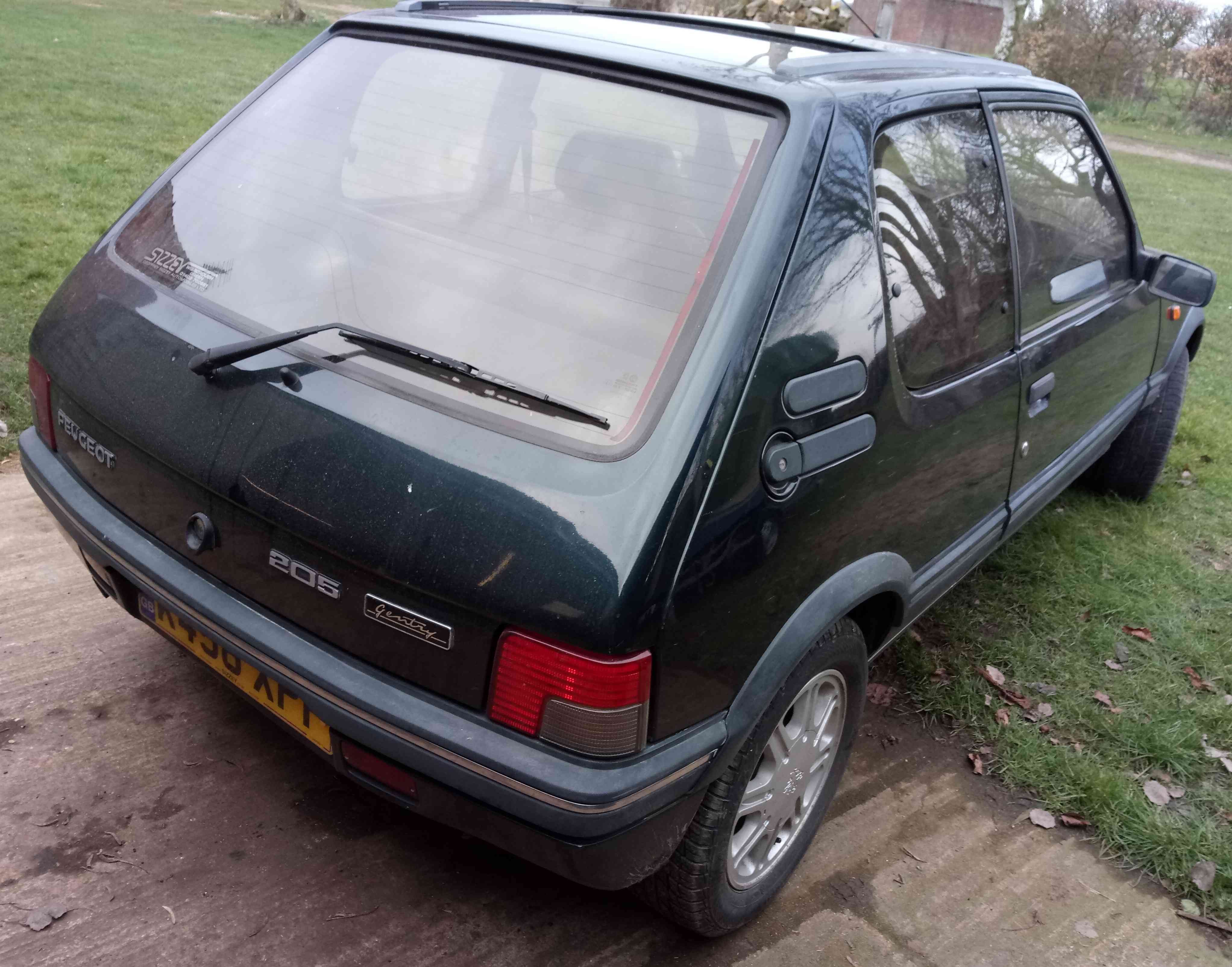

Crom 0 Posted November 7, 2018 I have quite a nice low mileage one of these and wish it was a manual. Would you change the box or the car? Share this post Link to post Share on other sites
jackherer 543 Posted November 7, 2018 25 years of boring drudgery and in an afternoon you could transform it into a proper 205. It's an easy decision but it depends on your experience I guess. 1 Share this post Link to post Share on other sites
Telf 238 2 Cars Posted November 8, 2018 (edited) Change the box! there are enough people on here to help you along if you get stuck- start taking it to bits and shout for help if/when it goes wrong. Edited November 8, 2018 by Telf Share this post Link to post Share on other sites
Crom 0 Posted November 8, 2018 Thats a good answer. What is the best source of parts to achieve this with the least grief? All suggestions gratefully listened to. Share this post Link to post Share on other sites
jackherer 543 Posted November 8, 2018 I would suggest a wanted ad on here! You can get some parts from e.g. Ebay. Make sure the gearbox you get has suitable ratios for the engine. It's not a huge list of parts you need really: Gearbox Flywheel Clutch Pedal box and clutch cable Gear stick and linkages Gear stick gaiter The only thing I'm not sure about is the subframe, I'm not sure if it will have the bracket for the gear linkage pivot or not. I just looked on servicebox and there doesn't seem to be a specific subframe for automatics so it looks like your one will be OK. There are two types of manual gearbox for the 205 GTI, BE1 (early) and BE3 (late) and you need the matching gearstick and clutch pedal/cable too. As your car is a later model it would be appropriate to go with BE3 parts. Share this post Link to post Share on other sites
Telf 238 2 Cars Posted November 8, 2018 Call round your local scrap yards. It's surprising what turns up or is sitting there waiting to be reused. Share this post Link to post Share on other sites
