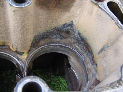

Telf 232 2 Cars Posted September 20, 2018 Miles supplied all my parts ( from pug racing)- he is a member on here. Haynes has all the info you need- get a workshop manual.(orange covered one) On my head I just had the seats cut with a 3 angle cut, and skimmed the head. The liner seats are ok (as I understand it) as long as the angular face are intact- the worst corrosion I saw on the 2 engines I stripped was in the corner of the block I had to reject a block because of this. If you strip the block and find damage seek advice on the forum before proceeding. 1 Share this post Link to post Share on other sites
Telf 232 2 Cars Posted September 20, 2018 (edited) heres the offending rot I found. And heres a link to my build thread. tom also had a great thread which helped me a lot- but I cant find the link now! Edited September 20, 2018 by Telf Share this post Link to post Share on other sites
