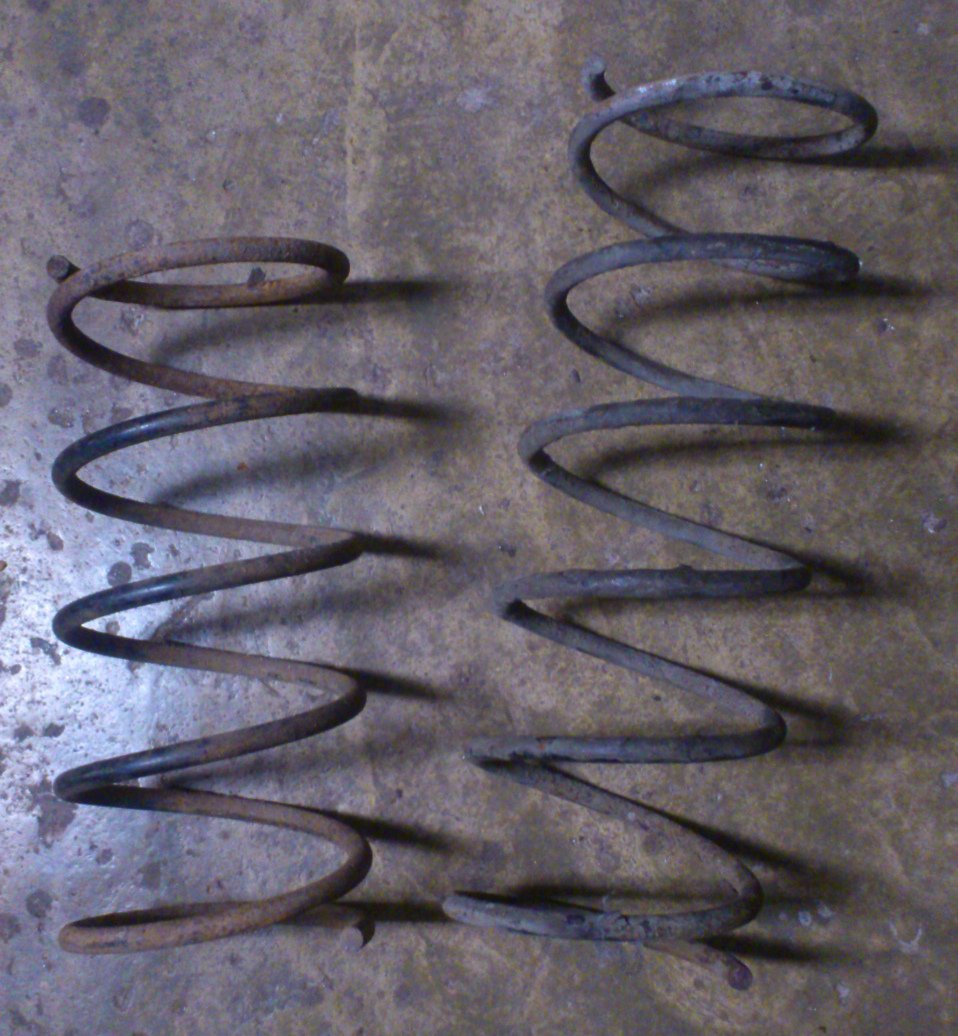

chobot 0 Posted July 16, 2018 Hi, I'm not sure if it helps, but there is picture of my original springs from my XS in comparison with ones from some base 1.1 model. XS are much shorter. Also I noticed that XS springs have similar length as 1.9 GTI but seems little bit softer. My XS is version for german market - TU with monopoint fuel injection, which also could have different springs than carb models. Share this post Link to post Share on other sites

205nut 0 Posted July 3, 2022 Hi, I'm just trying to resolve question of coil spring identification for my GT, same as XS. I relate to the challenges faced by other authors. When I search for springs based on different engine variants on various online shops to try to confirm whether some KYB springs that I inherited, part no. RA1542, are the correct ones, that one seems to be quoted whatever the engine spec. Of course this can't be right as we know XS (and GT) have a stiffer suspension setup. The coils on my car have 5 and half turns like the photo in an earlier post and the KYB RA1542 have more turns at 6 and half. So I'm reckoning these aren't right. Thoughts anyone? Share this post Link to post Share on other sites
