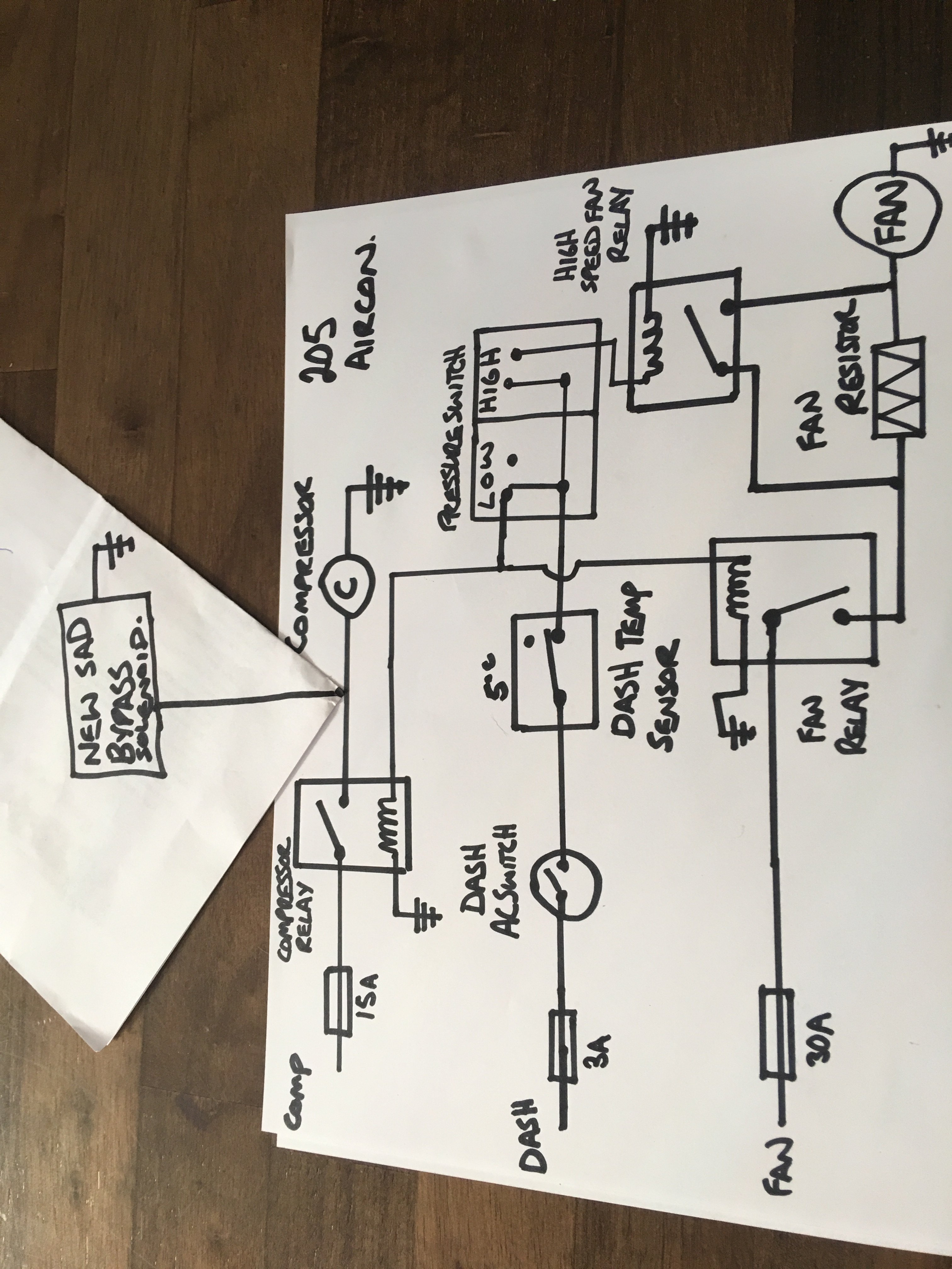

Beeluff
Ahhh I didn’t know that sort of solenoid existed!!! But yes the fine tuning of that type with a screw would be perfect.....
and yes, I’ll post a schematic, I suppose the theory of this all works so I could just add this last bit in parallel with the compressor coil and do the schematic and do it now??..... although I might wait till it all actually works, just in case there is a sting in the tail haha!!!! ;)
Basically i did it with 3 relays, a sensor in the evaporator behind the dash for stopping it freezing up, a high and low pressure switch/sensor, an illuminated ac switch on the dash, and 2nd radiator fan from a diesel that comes on half speed when the Aircon is initially switched on and full speed if the high pressure switch is activated (when the condenser needs to get rid of heat).....
it it works perfectly without any ecu....... except for this idle issue lol!!!!!

I’m Going to give this a go over the weekend.
ive quickly drawn up a schematic of the wiring side of things, and where the new solenoid will join into it all..... it’s not a brilliant drawing lol, but the basics are there!! :)
