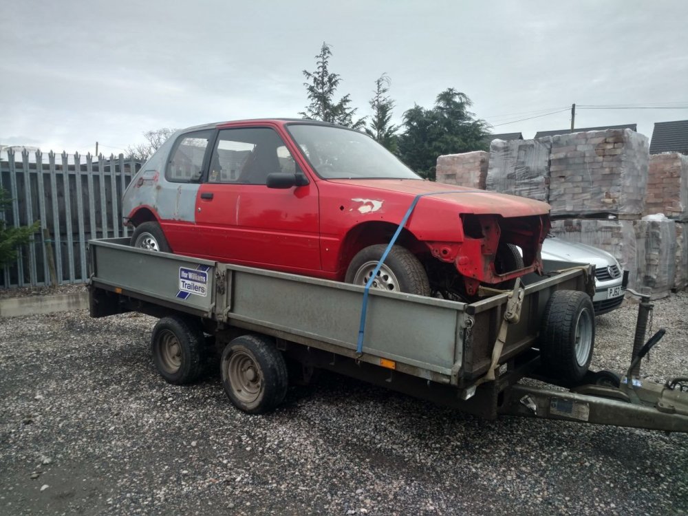

Nobbly 22 2 Cars Posted June 7, 2018 Hi 205'ers, I have been meaning to do this for a while having gone through the same process with my old VW camper a couple of years ago ( http://forum.earlybay.com/viewtopic.php?f=2&t=69499 ), I found it a great way of recording what I'd achieved and the help and advice received made a huge difference! I always wanted a 205 when I was a 'yoof' in the early 1990's, but (working in a Ford dealership) tended toward the blue oval (RS1600i, 2 x S1 RS Turbo, Capri Mk2... wish I still had them, I'd be well off now!). Even then I knew the Pug was a better car than the Escort, but I wouldn't admit it, even to myself. So, I stumbled on a bit of a 205 project about a year ago, a chap had started the resto but needed space for other projects (RS2000 Mk2, De Tomaso Pantera,...). It was quite local and at a price I was happy with to get me into 205 land. Basically it was: A 1.6 phase 2 from 1991, 79k with no history. (However, looking at the condition of the interior, engine and gbx internals and the body I'm as sure as you can be this is genuine) It had had a bump in 2004 and was written off Cat C - the damage was minimal and limited to the o/s/r 1/4 panel and rear bumper. The tailgate fitted was non-GTI. Engine, front suspension and interior already stripped out. Engine had been stripped, vapour blasted, all new parts (cylinder liners, bearings, gaskets) were supplied. Crank had been checked/polished and the head fully rebuilt. Gearbox not touched. Rear beam (seized), also not touched. Front suspension had been overhauled with new brakes, wheel bearings and the subframe p/coated. The shell was in good condition, tiny bit of corrosion on the n/s inner wing and boot floor needed 2 x 5cm square patches. The guy had already wire-wheeled the underside - which i was very happy about! Here she is as bought... 1 Share this post Link to post Share on other sites

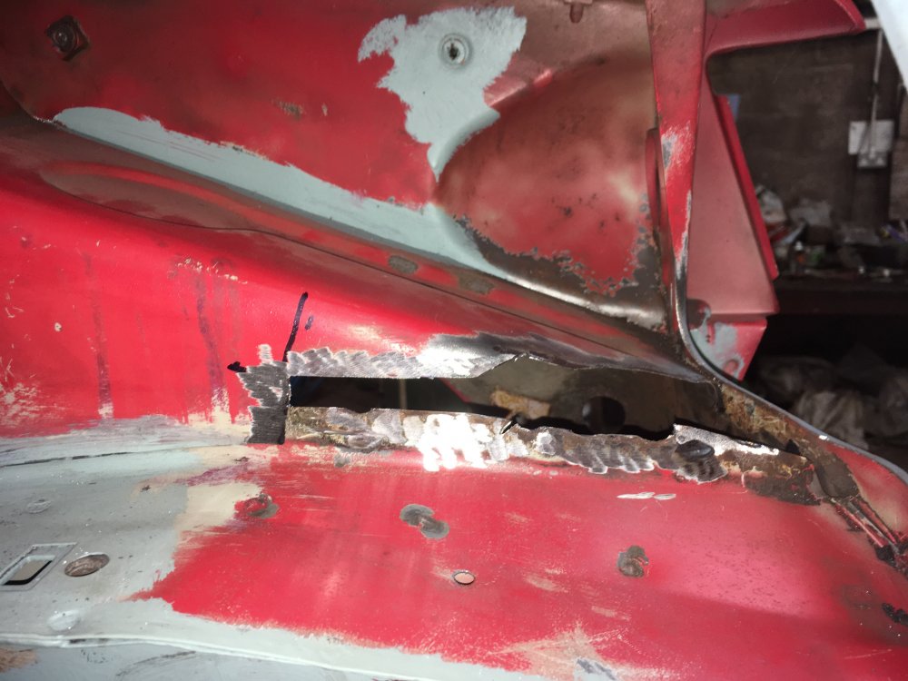

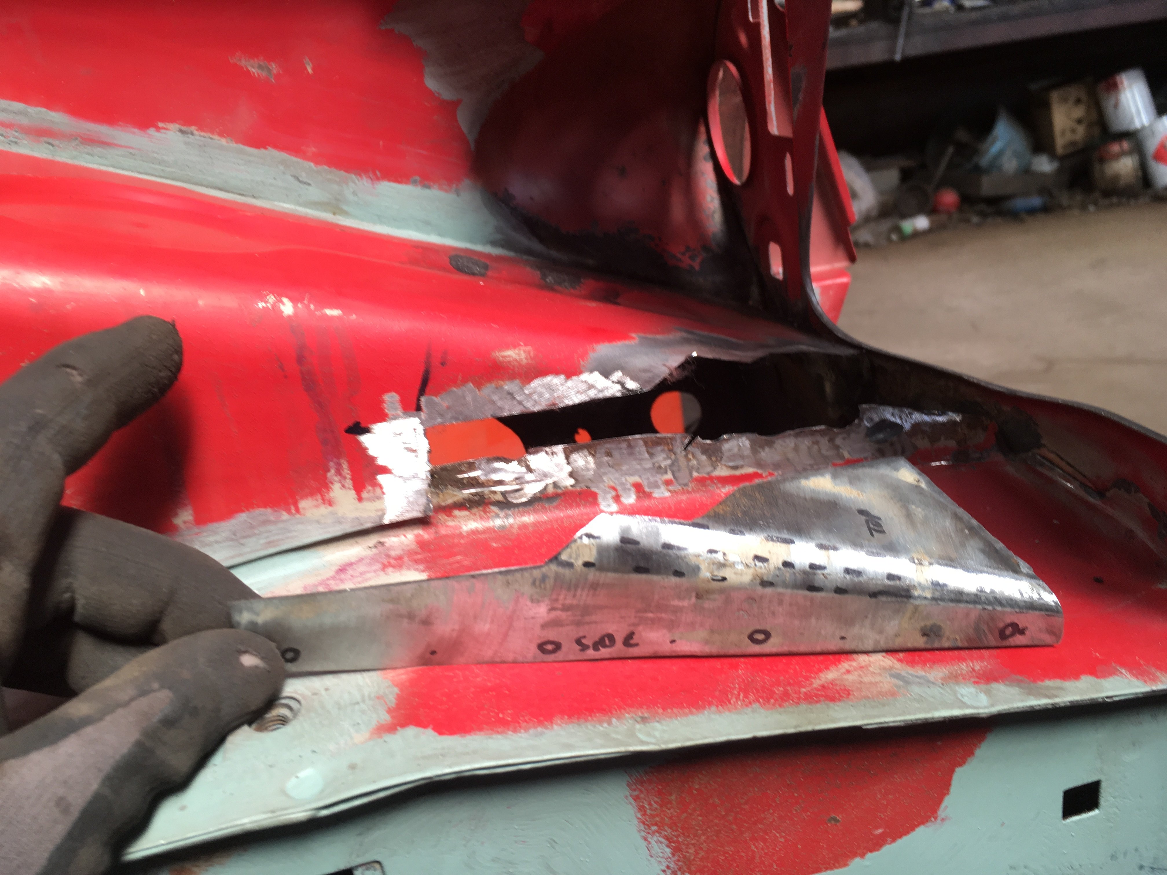

Nobbly 22 2 Cars Posted June 7, 2018 So I got it home and started tearing bits off, fixing the rust on the inner wing and boot floor. I found a bit under the rear seat too that when prodded was a bit 'soft', so fixed that. All in the welding and making good took about a day - light relief after a VW camper I can tell you!! Share this post Link to post Share on other sites

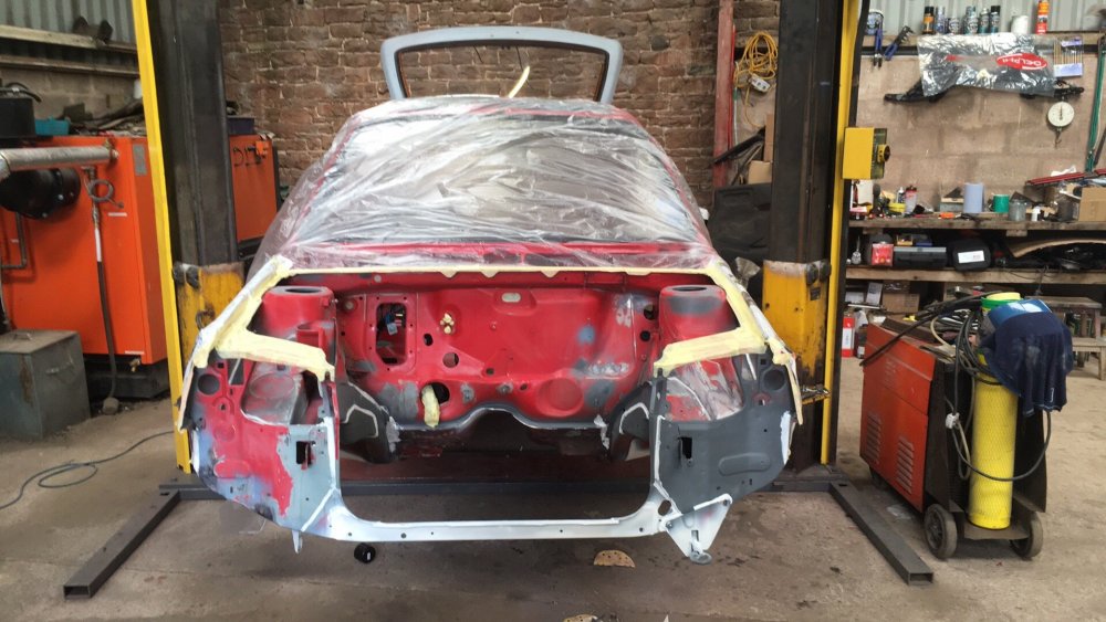

Nobbly 22 2 Cars Posted June 7, 2018 After a bit of scraping and wire-wheeling I could see progress in the engine bay and under the back-end Share this post Link to post Share on other sites

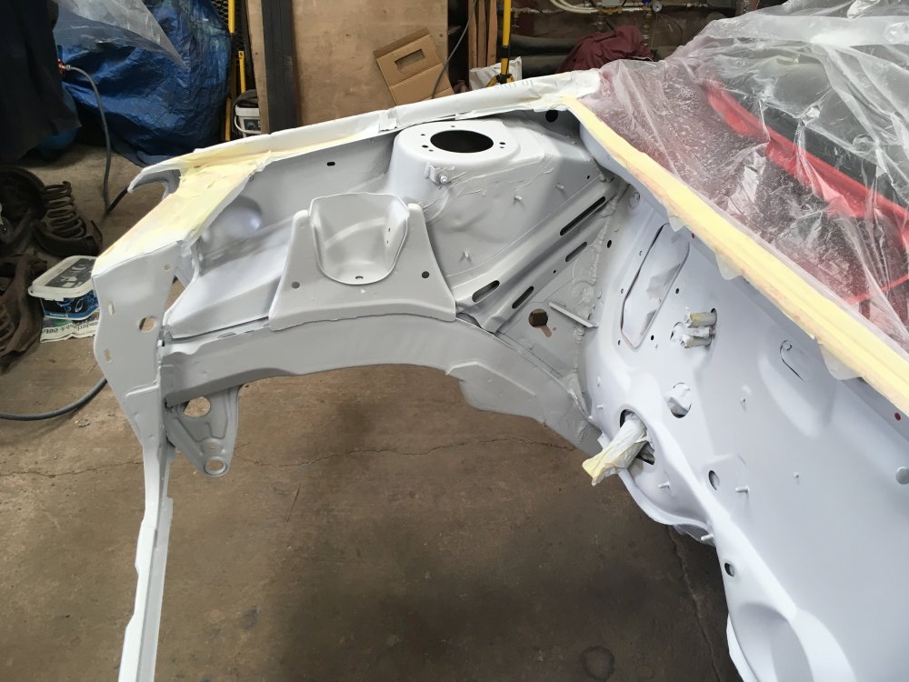

Nobbly 22 2 Cars Posted June 7, 2018 (edited) Then it was time to get shiny... IMG_2047 by David Noble, on Flickr IMG_2049 by David Noble, on Flickr IMG_2050 by David Noble, on Flickr Phew, image hosting thing works!! Edited June 7, 2018 by Nobbly add photo Share this post Link to post Share on other sites

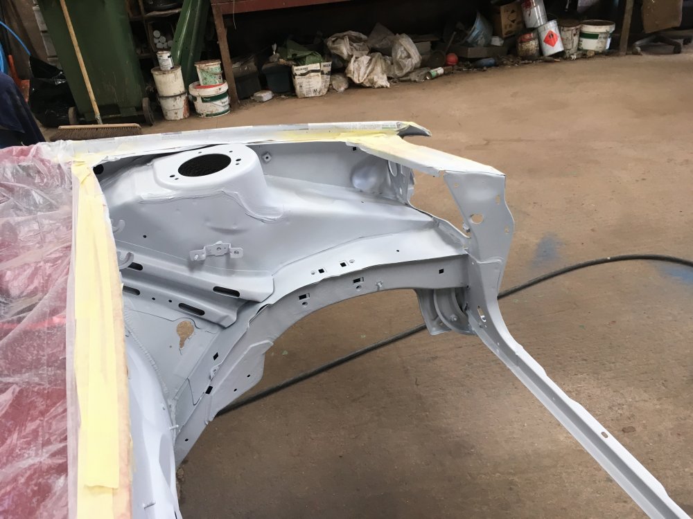

Nobbly 22 2 Cars Posted June 7, 2018 repaired bit from underneath, tidy! IMG_2057 by David Noble, on Flickr General shininess... IMG_2054 by David Noble, on Flickr IMG_2062 by David Noble, on Flickr Share this post Link to post Share on other sites

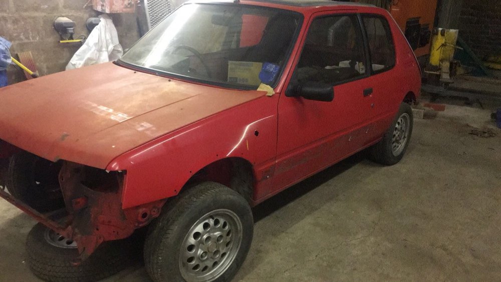

Nobbly 22 2 Cars Posted June 7, 2018 Then the front suspension went back in so I can get her to the paintshop where the experts can sort the minor dings and the dents in the 1/4 panel - it's hilarious that this could write the car off! IMG_1997 by David Noble, on Flickr While I get cracking on with this... B9F125F7-96D4-4673-8051-7139987CF373 by David Noble, on Flickr 1 Share this post Link to post Share on other sites
