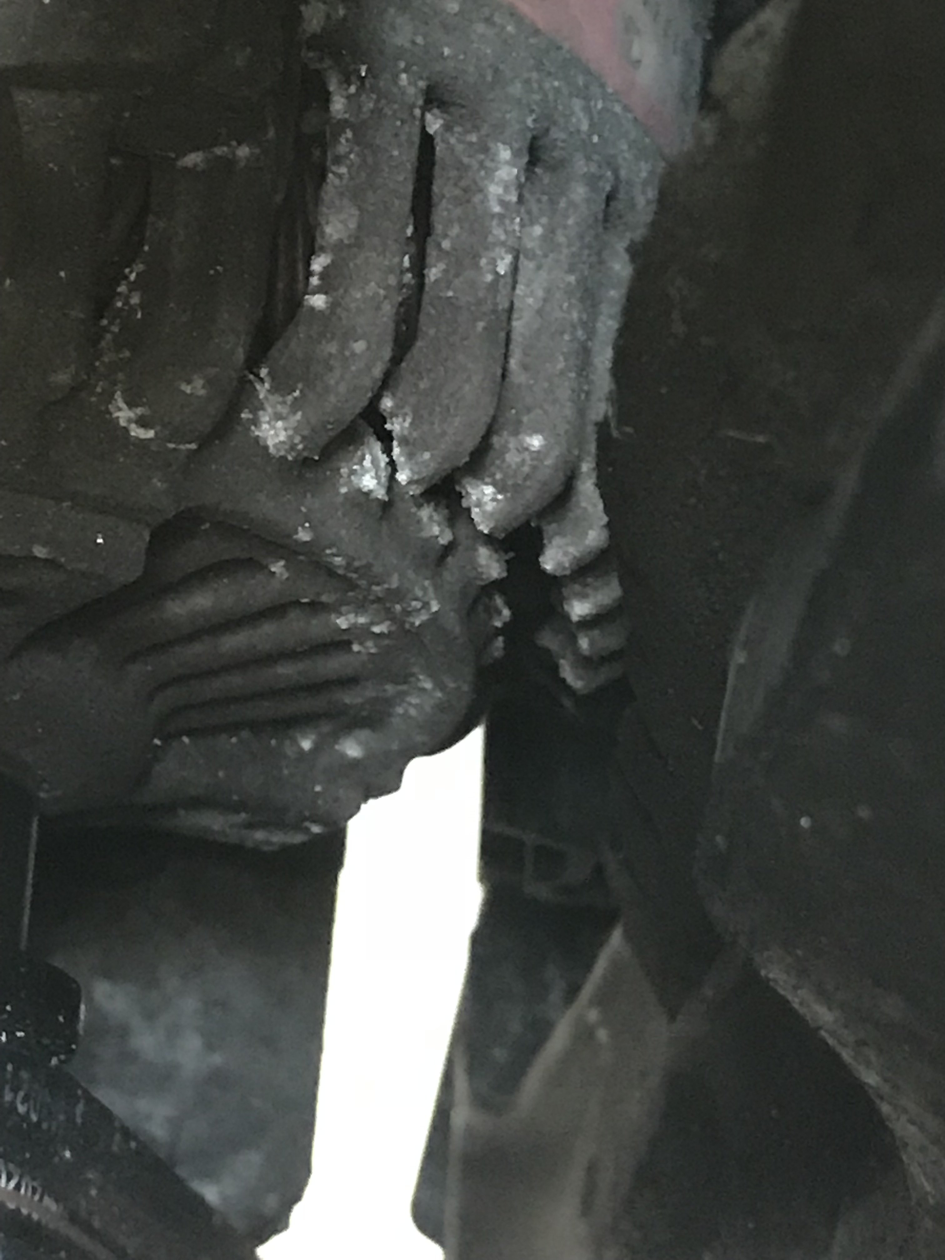

So after eventually getting the starter off yesterday, which was an absolute PITA of a job, i tested the starter with a battery and jump leads.
It spun up ok about a dozen times and the pinion moved forward etc, so i assume it's ok.
A wee bit of head scratching (and tears) and i found my alternator has collapsed.
I'm hoping this is somehow jamming and stopping the engine turning over properly.
I'll get the aux belt off and see if i can spin it....... another nice job to look forward to as the full front end of the car has to come off to change it.

right, I took aux belt off and it engine spins ok...... it must be the alternator.
