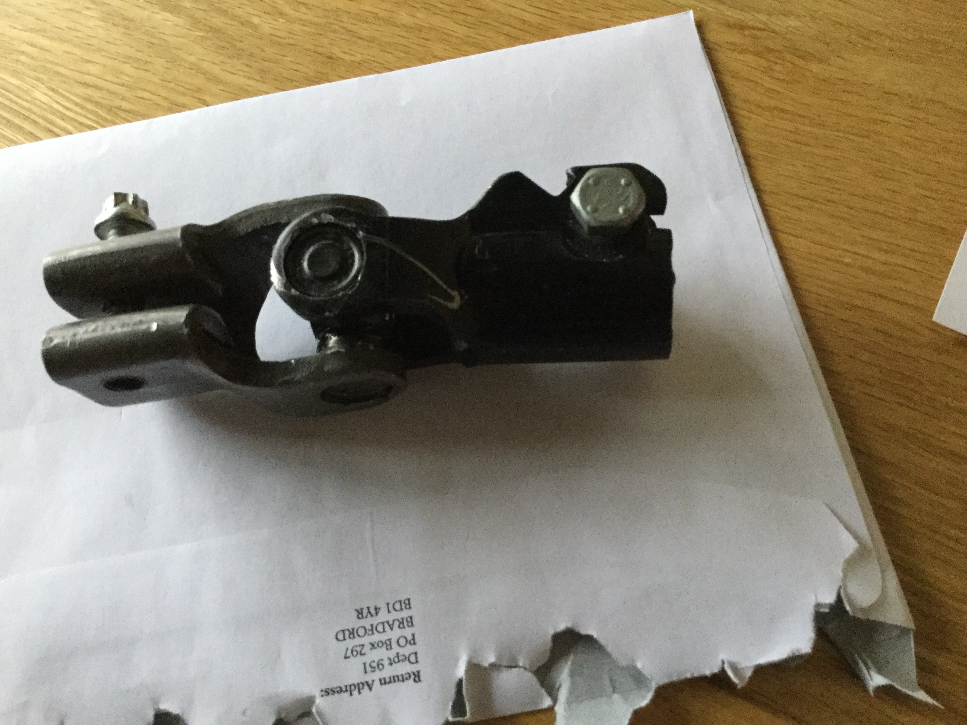

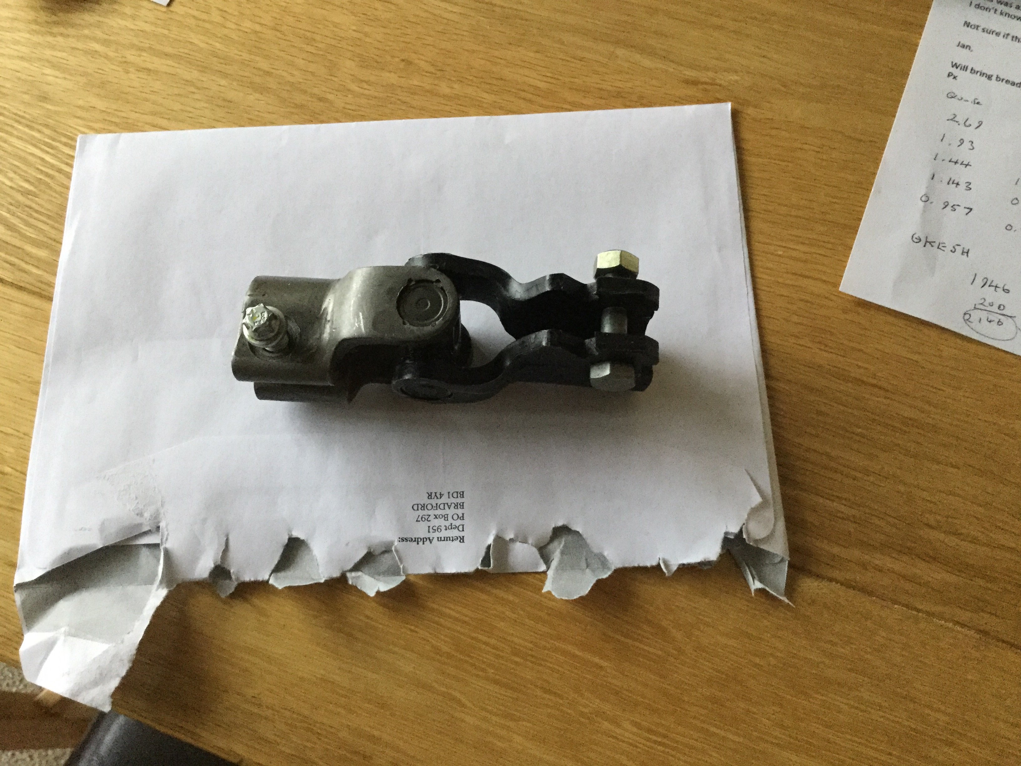

Hi. I have done this bit. Believe it or not, you can mate the upper part of the Corsa UJ to the lower part of a 205 uj by carefully driving out the bearing cups. See attached photo. All you would then need to do is to cut down the lower column as it will be too long. To that end, the Corsa B epas would be easier to use as it is shorter below the motor drive than the ‘c’ column

Worked a treat that uj tip! Thank you!

That is work in progress but i have a plan. Take the lower part of the 205 pas uj and fit to a non pas 205 uj then shorten and weld up..
205 pas uj has far too much vibration damping rubber than the non pas.

You'll find a couple of indents which hold the bearings in place. Tap these out of the way with a punch or use a dremel to grind them away. Tap the bearings out carefully..and reassemble.

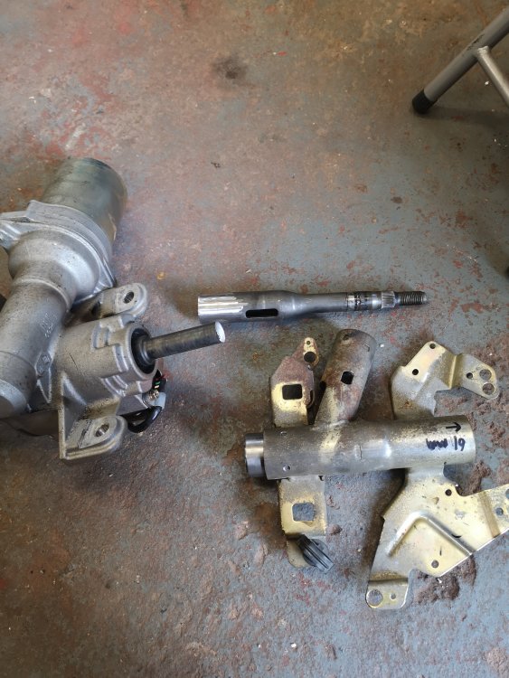

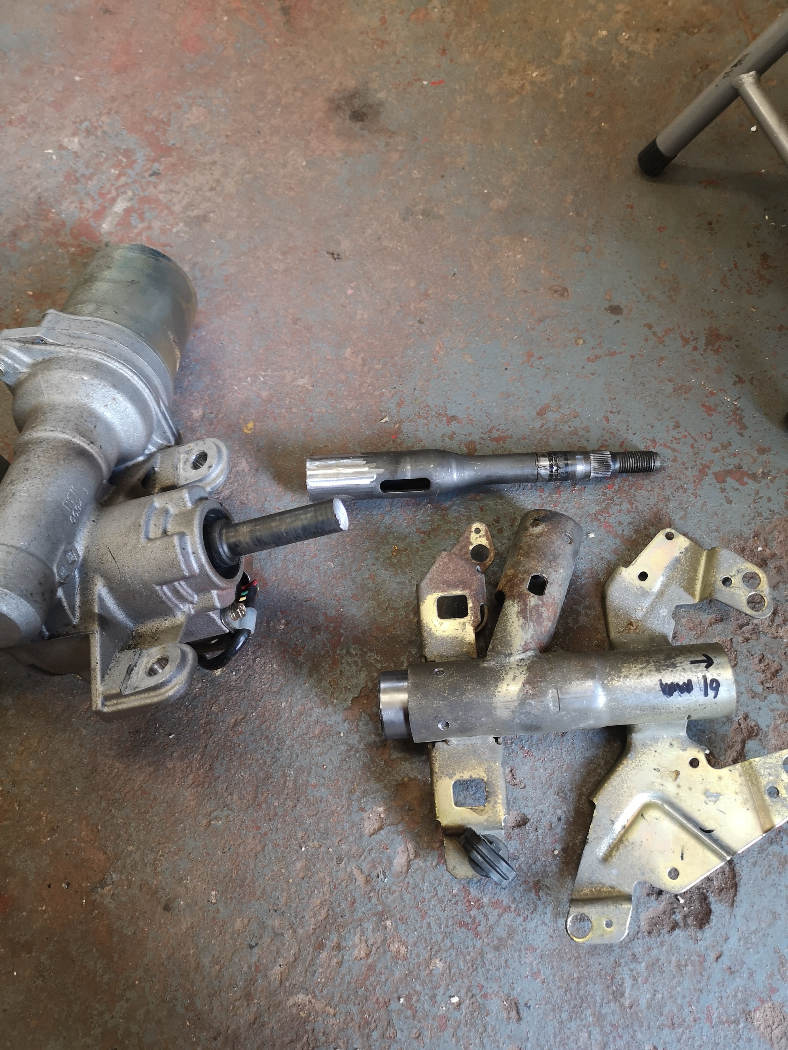

IMG_20190926_150627.thumb.jpg.1f42ab90091a7ca21580d28e3f696724.jpgt
This is where I'm up to so far, the top part of the 205 outer column will now interference fit into the ally housing of the corsa one. off to the machine shop to get a piece turned to fit the top half of the 205 inner over the corsa inner.
205 one appears to have a slight taper in it so it's beyond my skills.
still not 100% sure whether to weld them together or get a good interference fit with a roll pin or something. I guess I'll ask the toolmakers what they think.

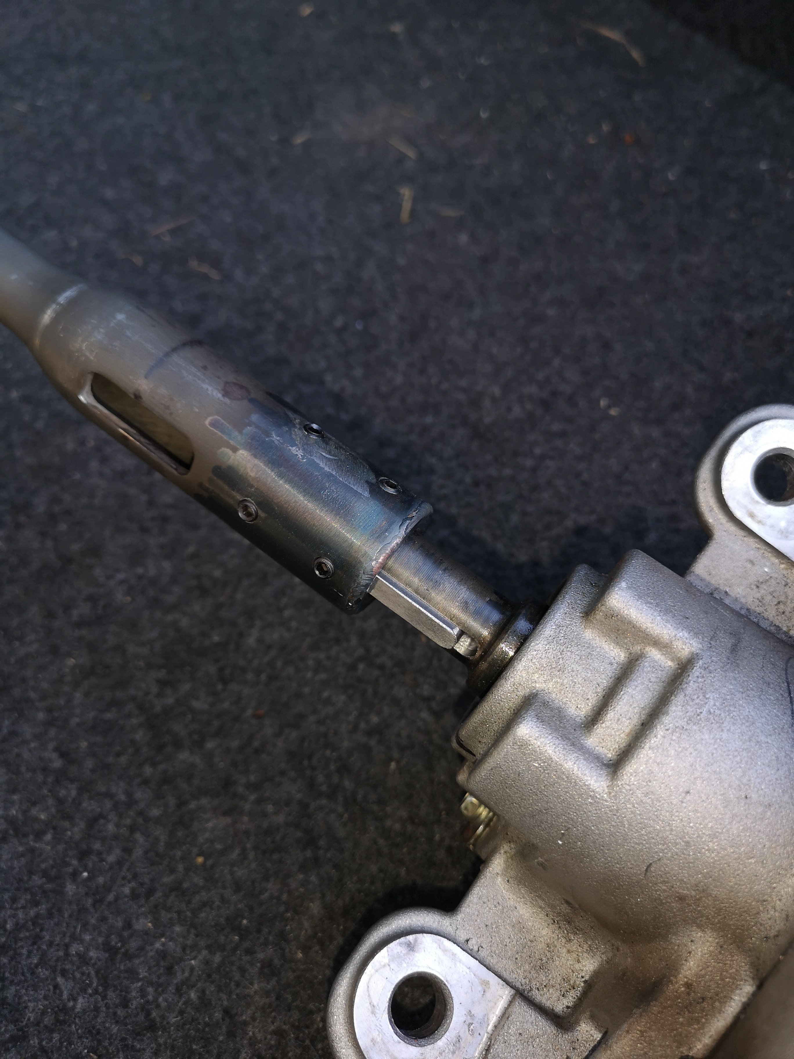

Dropped it off the machine shop, they were not terribly happy about working on a steering column :(  However I persuaded them to carry on and their plan is to turn a bush to fit in the 205 column stub and weld that in.   There will be a keyway inside the bush and they are going to broach a keyway onto the corsa column.  At least that way it can be removed in the future if needs be, plus I'm not sure welding the corsa inner column would be a good idea whilst its all together and I've no idea how far into the motor and workings the heat would penetrate.
Spesh
IMG_20191008_154512.thumb.jpg.7dde289fd5d54cf2ddcae9dcd8e05ef3.jpgworked out ok
