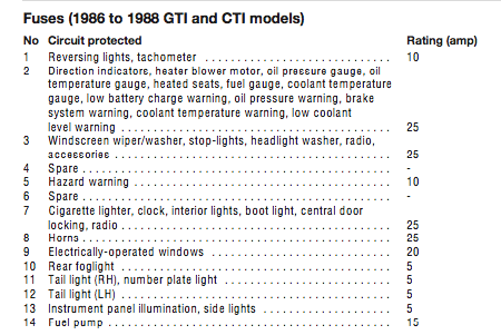

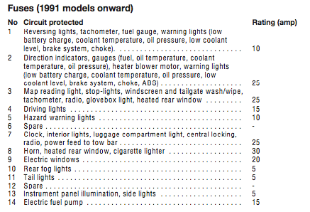

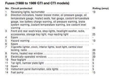

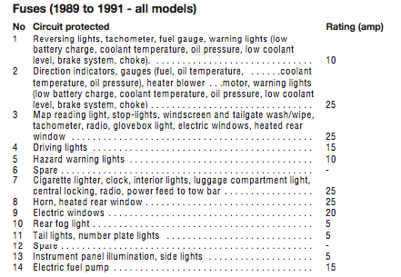

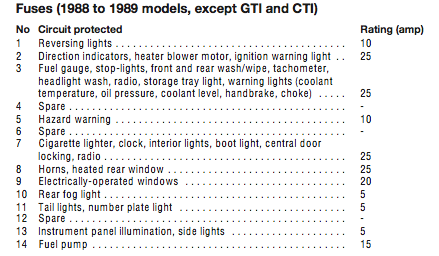

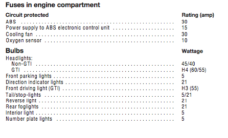

Hello all,
Has anyone got a good diagram of the fuse box showing what each one does?
many thanks
There are lists in the Haynes manual, it varies depending on year and spec.
5a5fc2db9e083_ScreenShot2018-01-17at21_34_47.png.f98a33859d97d3a250e0ce379751588f.png5a5fc2dd08632_ScreenShot2018-01-17at21_34_39.png.e4be4e93ed3808e1daacdc33f09ae7c4.png5a5fc2de394ff_ScreenShot2018-01-17at21_34_30.png.216c5e9b1f4f99b3ac28946d6e44559d.png5a5fc2df51ded_ScreenShot2018-01-17at21_34_23.png.7659bc207b4ff338584e91bc067874d4.png5a5fc2e05d256_ScreenShot2018-01-17at21_34_12.png.6417f3f897610b8410fd9c83718c5684.png5a5fc2e173277_ScreenShot2018-01-17at21_34_04.png.a1fb7ecf947197ab8098107c92571986.png5a5fc2e28ea44_ScreenShot2018-01-17at21_33_56.png.1d9fdcad623dc89df6a73baaf6badf2b.png
