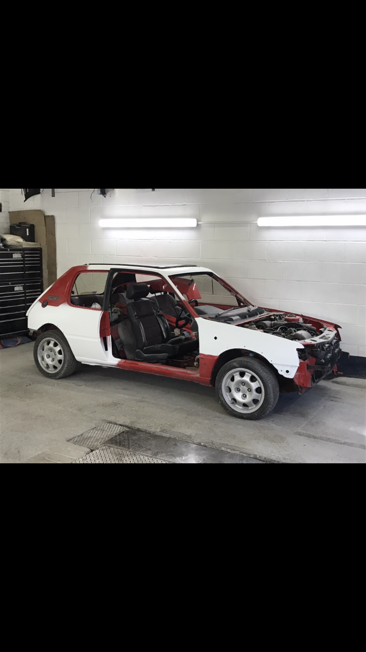

Hi, I’m in the middle of restoring a 1990 1.9 in Cherry Red. I imagine I am going to be on here a lot picking all of your brains for help and advice. One thing so far I’m slightly stumped on is having sorced 2 brand new genuine new doors I need to try and figure out what kind of Rivnut I need for the exterior door handle to bolt to. Cars going into Paint at the weekend so will hopefully start with the rebuild over Christmas. Any replies are greatly received. Thanks, Matt.

No just above the door handle hole to the right hand side is a rivnut with a thread in. Must be a bolt that goes through the handle into it. Stripped this car about 2 years ago and then got busy with other ‘paying jobs’ so it’s been put to the back.
