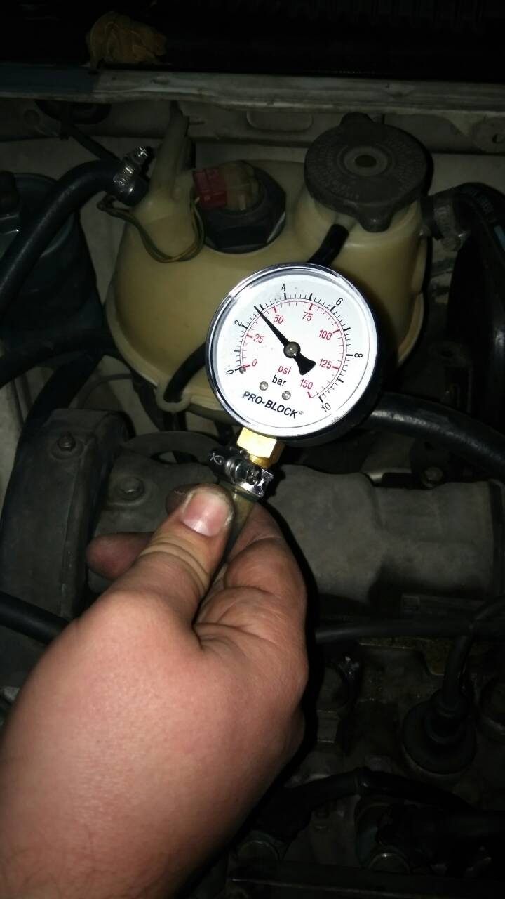

Best to check with gauge at outlet from pump, there will be a small loss after fuel filter but not that much
Doesn't really matter, anywhere between the pump and reg is a suitable place to test.
I have a modified filter top banjo bolt with a pressure take off so I can quickly test any 205.
pedjoni
Hi everyone,
Definitely fuel pump problem. Today checked with profi fuel pressure gauge, samo like on mine. Low pressure. Around 1.5 b.

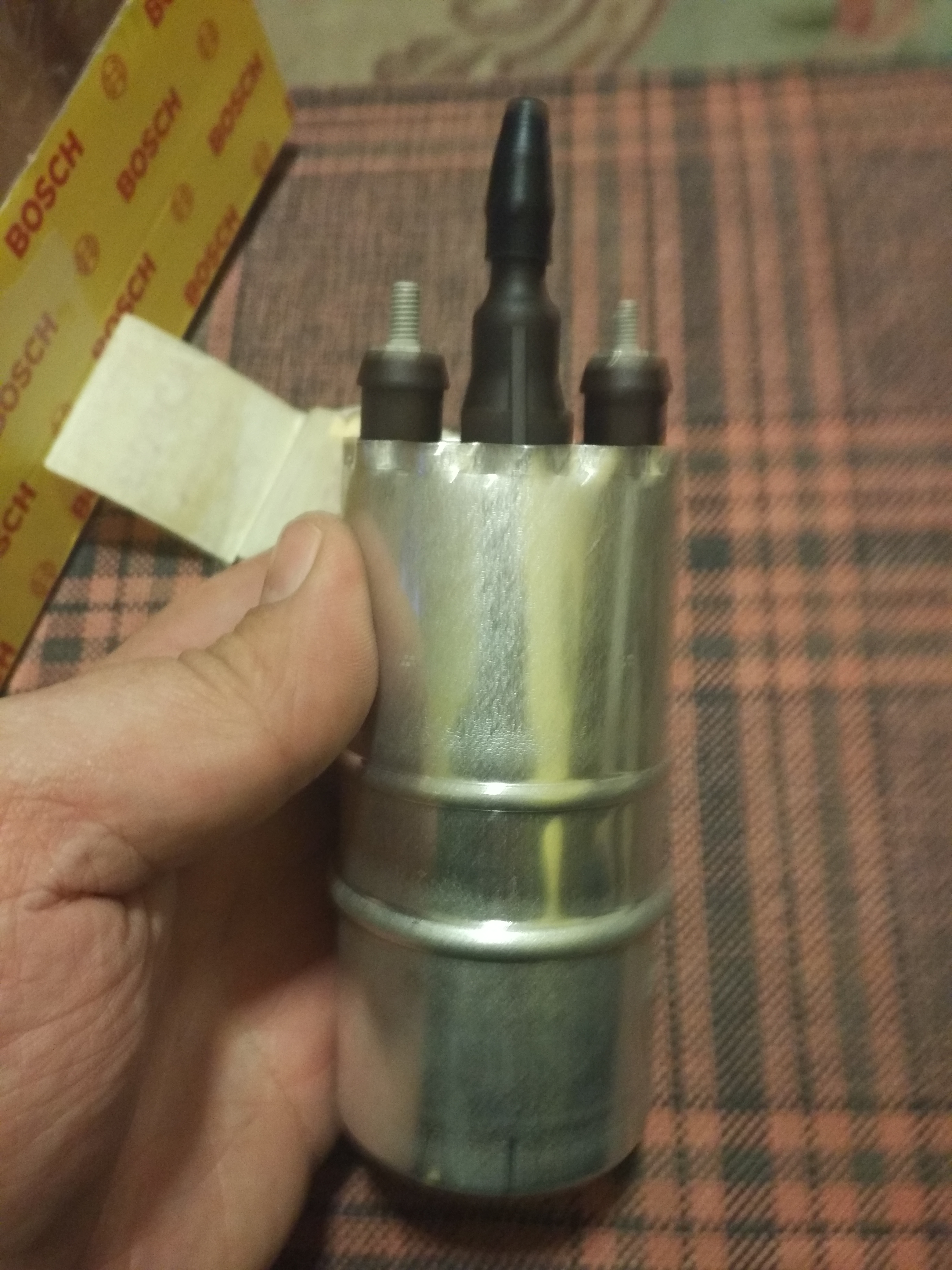

Can you tell me which replacement pump to buy??? In my country I cant find bosch one...
Thanks in advance
pedjoni
Thank you all for replies. I fixed it. New fuel pump solved everything. I managed yo find new bosch fuel pump in part store near by me. Litle bit expensive but totaly worth it. Fuel pressure now is 2.9-3.0 bar. :) Cheers to everyone. So if someone has similar problem, it was bad fuel pump.
