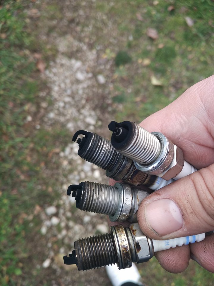

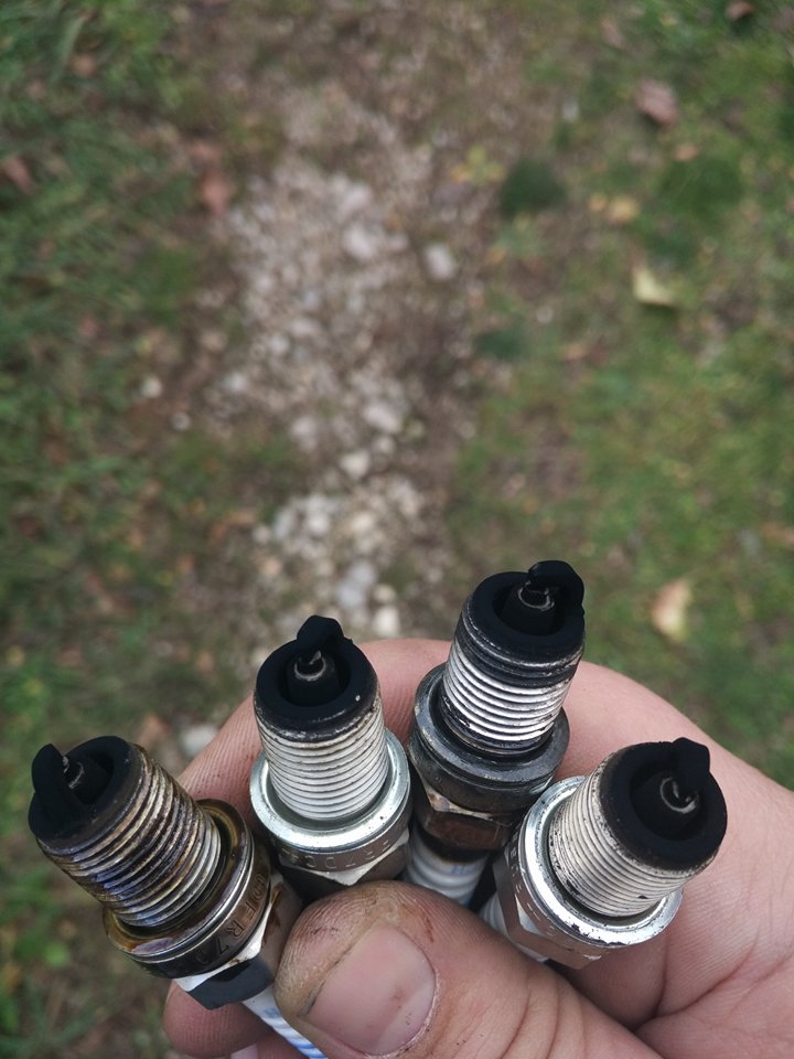

But now I have other problem, car is running too rich I think. It goes well, all the way to the redline, no strugling or hesitation. But my fuel economy is very bad...
I ve checked spark plugs today, i saw carbon build up very much. Runing rich I pressume?

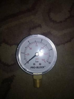

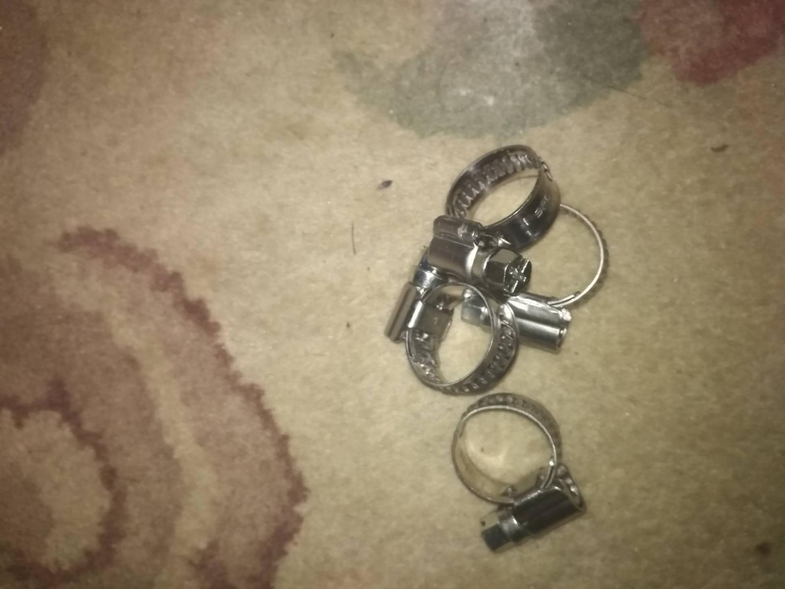

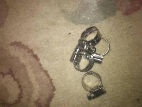

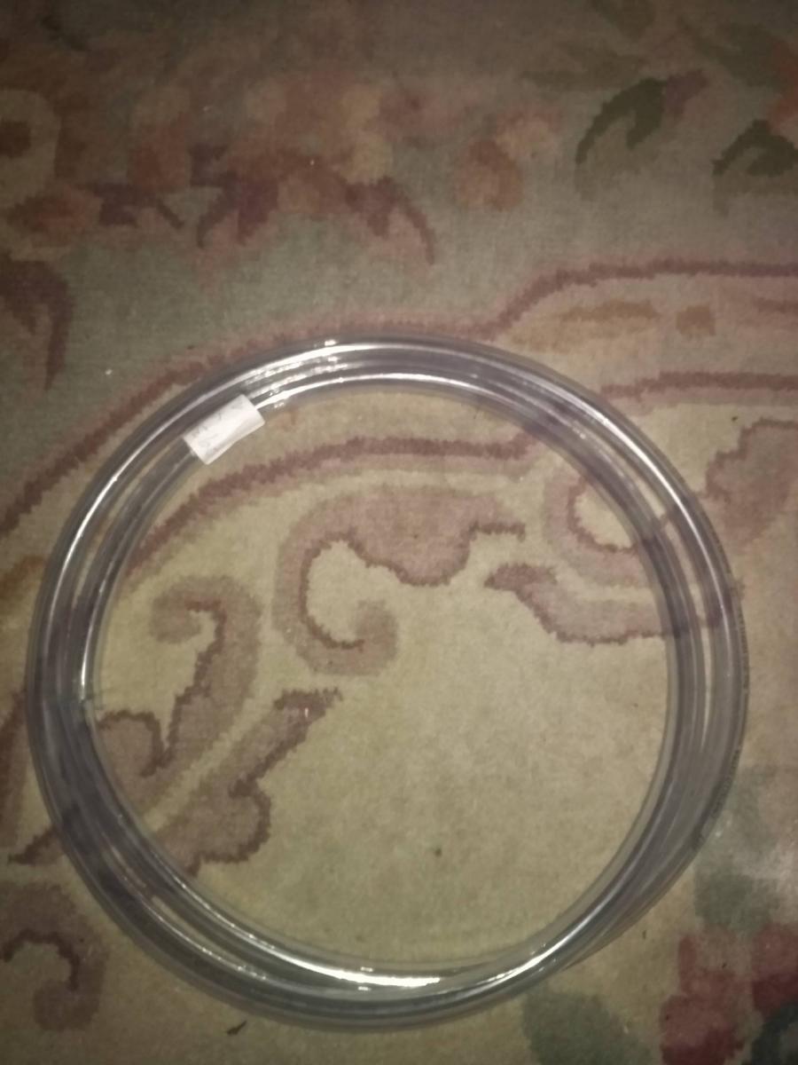

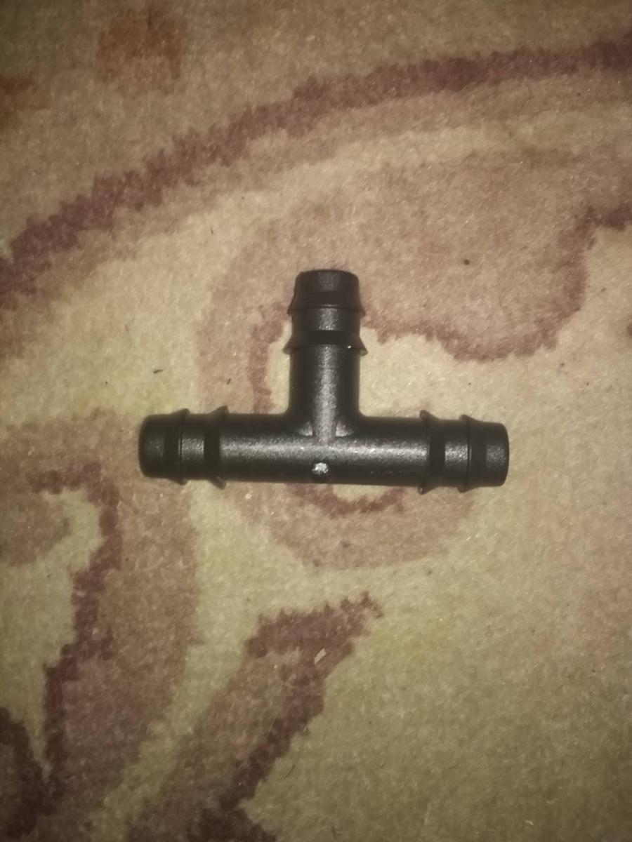

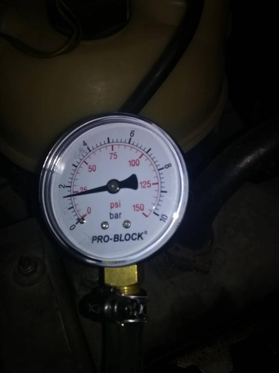

Today I bought parts for check fuel pressure. Not so good.
1.5 bar so fuel pump is bad ??? But car goes very well, very strong aceleration. I am confused.

PhilNW
At that pressure mine was running very rough whereas the plugs suggest the opposite
Does the pressure vary with engine revs? There should be a small variation
Try slowly clamping the return pipe to see if the pressure varies.also do the same on the feed pipe
Possible it's a dodgy gauge of course
Edited by PhilNW
wicked
Note that the fuel pressure is regulated against the pressure in your inlet; if it is -0,6 bar at idle and you measure 1,5 bar, the actual fuel pressure is 2,1 bar. (which is on the low side). Keep that in mind before you draw conclusions..
Second note; never trust the lower range of a gauge. If you want to measure 3 bar accurate, your gauge should have a max range in the 5 bar ballpark.
Edited by wicked
yes 1.5 is too low, should be 3 bar.
wicked
3 bar + MAP (~-0.6) = 2.4 ish bar at idle.
Replace fuel filter; put back the original pressure regulator and measure again. If still low; replace the pump.
Note that DFZ pressure regulators are 2.5 bar iso 3 bar; don't grap the wrong one.
you should disconnect the vac line when testing btw.
Rob_the_Sparky
Any reason to have the car even running when testing?  That way you do not need to disconnect the vacuum.  (might need to supply 12V to the pump though to ensure it is running)
Bigger question would be why is it running rich with a 1.5bar pressure, it should be running horribly lean.  Either:
that reading is wrong,
there are other problems masking the reading
or someone has been hacking the car to make it run not knowing what the root cause of the problem was.

Well, I bought new pressure gauge, maybe it is wrong. On the car now is AFM which nobody touched. It is on factory settings. Car runs fine, aceleration good all to the red line. Only problem is at idlee. IT idle too low. Screww on the throtle body is almost all way out to keep it going without stalling. Fuel consumtion is terrible. it is well over 15 l for 100 km... When I press gas pedal hard, there is black smoke like diesel engine, past 5000 rpm. also notice unburned fuel bang from exhaust.
Today I bought starter spray, to fing maybe vacuum leaks. I was spraying aroung inlet manifilod, injectors, throtle body.... No0 rpms changed, so I gues no vacuum leak also...
If fuel pump is bad, under pressure, I assume, car wouldn t acelerate good????
Also when I disconected return line from FPR there is no fuel, line is completely dry o.O
Fuel filter is new.
Thanks all for replays
Edited by pedjoni
when are you checking the return line?  with engine running?
where did you install the pressure gauge?
pedjoni
When engine is running. I conected gauge between fuel filter and fuel rail???
