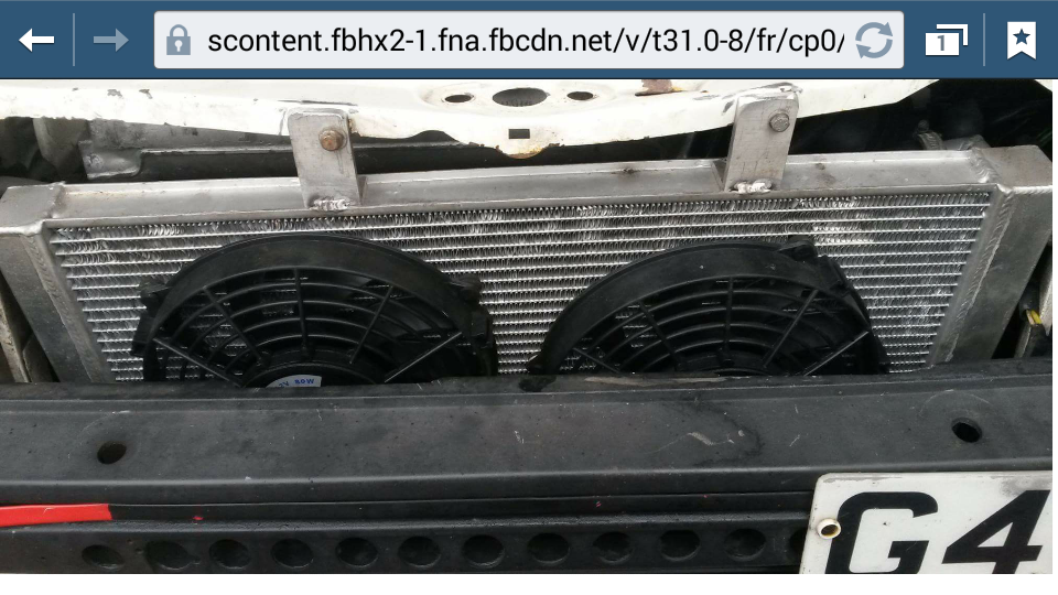

changingman 7 1 Cars Posted August 3, 2017 Hi , I've got a bit of an issue in as much as I am not sure which direction my fans should be turning, clockwise or anti clockwise. I am wiring In a switch so I can turn them on and off manually from inside the car as the sensor that told the fan when to come on and off didn't always work. It's a track car so I want full control over it. I've wired in a switch but all the existing wires to the fans are made up of half a dozen bits of different coloured wire joined together and I have got new wires run but I don't know which way the fans should turn. The fans run in either direction if I reverse the polarity of the wires. Thanks Liam Share this post Link to post Share on other sites
Simes 248 2 Cars Posted August 3, 2017 Depends if they suck or blow. By your picture I'm assuming they blow, check with the manufacturer. Btw The sensors are £9, I bought one last month. I hope that there is a relay in there somewhere....... Share this post Link to post Share on other sites
changingman 7 1 Cars Posted August 3, 2017 Depends if they suck or blow. By your picture I'm assuming they blow, check with the manufacturer. Btw The sensors are £9, I bought one last month. I hope that there is a relay in there somewhere....... Cheers, I think cold air is drawn from the outside and blown onto the rad so that ties in with what you said. And no relay, just 30 amp wiring, 30 amp switch on the dash and a 30 amp inline fuse. I openly admit I know very little about auto electrics !!! Cheers Liam Share this post Link to post Share on other sites

petert 641 Posted August 3, 2017 Normally you can flip the fan blade over, depending on whether you want it to suck or push. The direction remains the same. 1 Share this post Link to post Share on other sites
changingman 7 1 Cars Posted August 3, 2017 Normally you can flip the fan blade over, depending on whether you want it to suck or push. The direction remains the same. That's interesting to know,thanks. Share this post Link to post Share on other sites

pug_ham 245 3 Cars Posted August 4, 2017 It's wired in now all bar connecting the spades onto the fans which takes seconds once I found out which way the fans should run!! Run the fans & see if you can feel air being pushed through the rad with your hand on the other side, if you can that's the way they need to be wired, iirc this should be with the fan spinning clockwise as you look at them, assuming your fans are mounted in the same orientation to the original ones. g 1 Share this post Link to post Share on other sites
changingman 7 1 Cars Posted August 5, 2017 Run the fans & see if you can feel air being pushed through the rad with your hand on the other side, if you can that's the way they need to be wired, iirc this should be with the fan spinning clockwise as you look at them, assuming your fans are mounted in the same orientation to the original ones. g They are in front of the rad behind the grille. They are sucking air and blowing it onto the rad so it all good I believe!!! Cheers. Liam Share this post Link to post Share on other sites
Henry Yorke 270 3 Cars Posted August 5, 2017 Dangle a piece of toilet roll in front of the grille to confirm what way it is blowing. It is amazing how many can get wired up wrong. Also shielding around the rad would force more air through the rad and help your cooling issues Share this post Link to post Share on other sites
welshpug 1,737 Posted August 6, 2017 most decent fans will have a direction of rotation arrow, and different blades for pull and push. Share this post Link to post Share on other sites
Simes 248 2 Cars Posted August 6, 2017 Also shielding around the rad would force more air through the rad and help your cooling issues And / or put them on the other side and suck the heat out. Share this post Link to post Share on other sites
