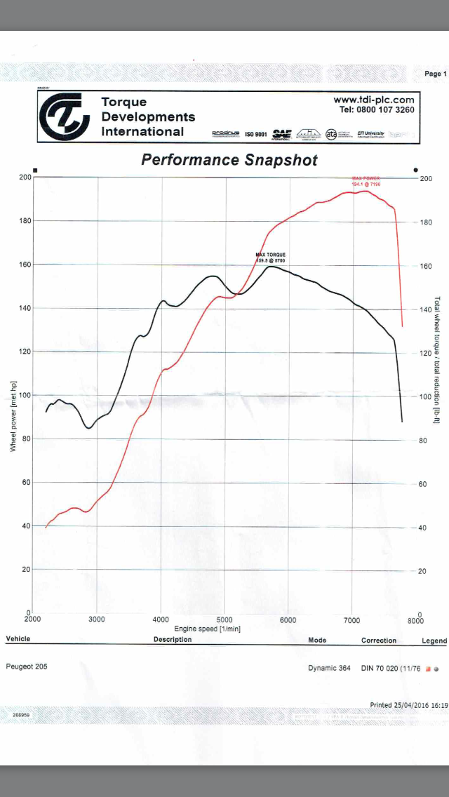

SweetBadger 104 Posted July 28, 2017 (edited) Mi16 engine revved to 7800rpm, did about 15 track days, 40k miles and a whole race season on a standard MI clutch, no problems. Gti6 race engine (lot more power 8000rpm), started killing mi clutches after about 20mins on circuit. I put this down to a combination of a solid rear engine mount, and an accelerator pedal height that made it very difficult to heel-toe (= the odd unavoidable big downshift). I'd fit a standard MI clutch and see how you get on - try to be easy on the drivetrain on downshifts when on track. See here if you want a clutch that will definitely do the trick and put up with race/track driving (not cheap though) http://forum.205gtidrivers.com/index.php?showtopic=168781&hl= Edited July 28, 2017 by SweetBadger Share this post Link to post Share on other sites
blandy 29 Posted July 28, 2017 What power is your gti6? Think I'll give the mi16 a try then just have to work on technique a little Share this post Link to post Share on other sites
SweetBadger 104 Posted July 29, 2017 The graph is attached: 194 @ hubs, approx 220 flywheel Share this post Link to post Share on other sites
blandy 29 Posted July 29, 2017 So similar to what I'm looking for then Share this post Link to post Share on other sites
