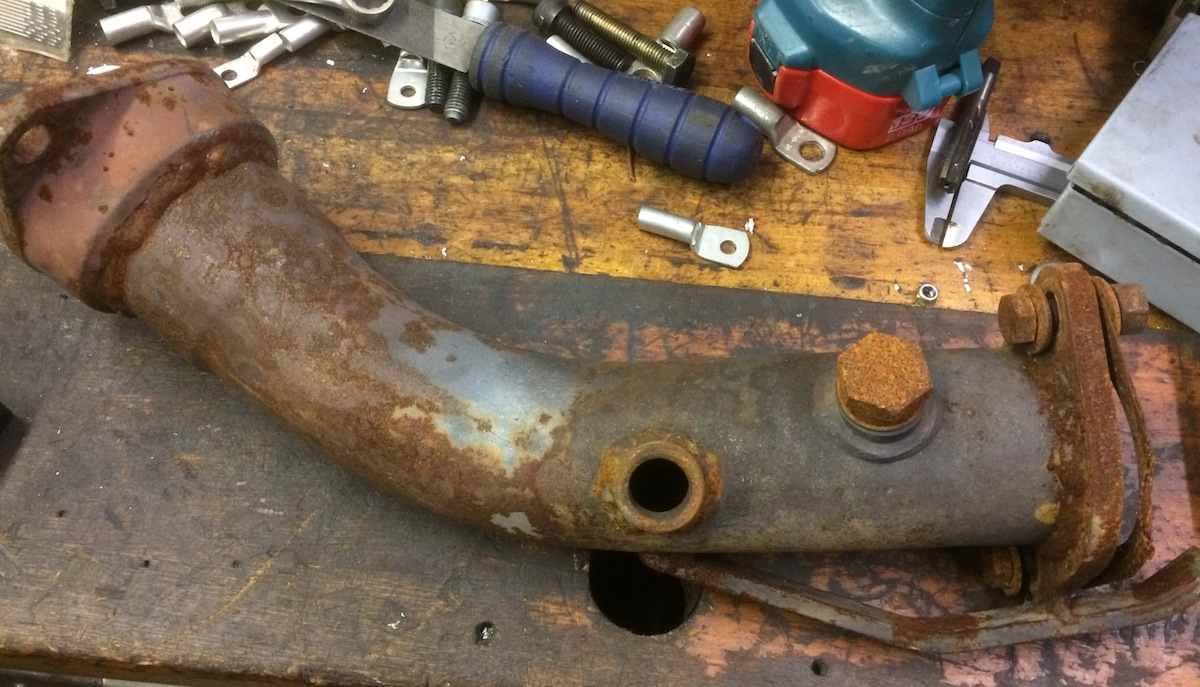

Here is mine, 195 x 325mm as per your sketch. I think mine started life as something else, maybe an XU10J4, thus I added the extra lambda bung in the correct position.

Thanks Peter, but I think Miles' are different now. I spoke to him and the "X" dimension is 22", which i'm pretty sure will be too short for me, I've still to check, hopefully tonight.
I'm gonna measure up what I need and he'll get his exhaust man to keep a bit of length on it for me so I can marry it up with what I've got.
Thanks for looking anyway for me.
