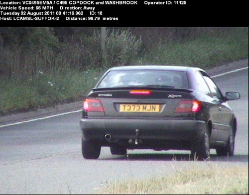

jackherer 543 Posted October 4, 2017 Under heavy braking the rear end is unloaded so I don't think you'd have an issue with the tube flexing. In theory that is true but I have a photo of my old Xsara VTS under very heavy braking that was kindly supplied by a policeman parked at the side of the road in a van... It did have a pretty ropey rear beam but the static camber wasn't excessive and the ride height was normal, however under heavy braking the wheels were at a crazy angle and tucked in the arches! 2 Share this post Link to post Share on other sites
DamirGTI 345 Posted October 4, 2017 Pretty good shot for an policeman ! Does look strange , worn beam mounts/bushes possibly ?! D Share this post Link to post Share on other sites
jackherer 543 Posted October 5, 2017 (edited) Pretty good shot for an policeman !He had a special camera in his van designed for taking photos of fast moving cars! Does look strange , worn beam mounts/bushes possibly ?!It was definitely worn but the point I'm trying to make is that there was weight on the rear under heavy braking so the beam is definitely loaded under those conditions despite what you'd think would happen due to dynamic weight transfer. Edited October 5, 2017 by jackherer Share this post Link to post Share on other sites
Anthony 1,003 Posted October 5, 2017 The braking effort of the rear brakes makes the rear trailing arm rotate upwards (ie suspension compress) going forwards and rotate downwards (ie suspension extend) going backwards. Pull the handbrake whilst moving (obviously not too firmly with drums!) and you'll see. Interesting just how much it has squatted down at the rear in that picture though Share this post Link to post Share on other sites
DamirGTI 345 Posted October 5, 2017 (edited) Lucky over here we do not have such modern photography equipment (not yet at least !) , though instead we do have an s*** load of interceptors which are a bit tricky to spot especially at night .. Interesting this about suspension load , yes one would first think it'll load the front axle and unload the rear while braking hard .. must dig my book of wisdom to see what's up with that . D Edited October 5, 2017 by DamirGTI Share this post Link to post Share on other sites
