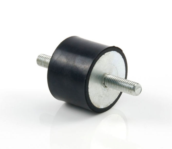

joris_andriesse 8 Posted March 17, 2022 Does any of you know the width of the mount and the thread size of the bolts? Same question for the gearboxside mount, does any of you know the measurements from that one? I want/need to drop my engine a little bit to get enough clearance under the bonnet for the throttlr bodies airfilter and I'm thinking of trying a vibration damper with the right measurements, since that's way more affordable than the Vibra-technics engine mount (which looks amazing btw). Share this post Link to post Share on other sites

petert 549 Posted March 18, 2022 14 hours ago, joris_andriesse said: since that's way more affordable than the Vibra-technics engine mount (which looks amazing btw). Just dig deep and buy the race version. It will solve all your problems. Additionally, it has M12x1.75 on the top, rather than M10x1.5 top and bottom. Share this post Link to post Share on other sites
