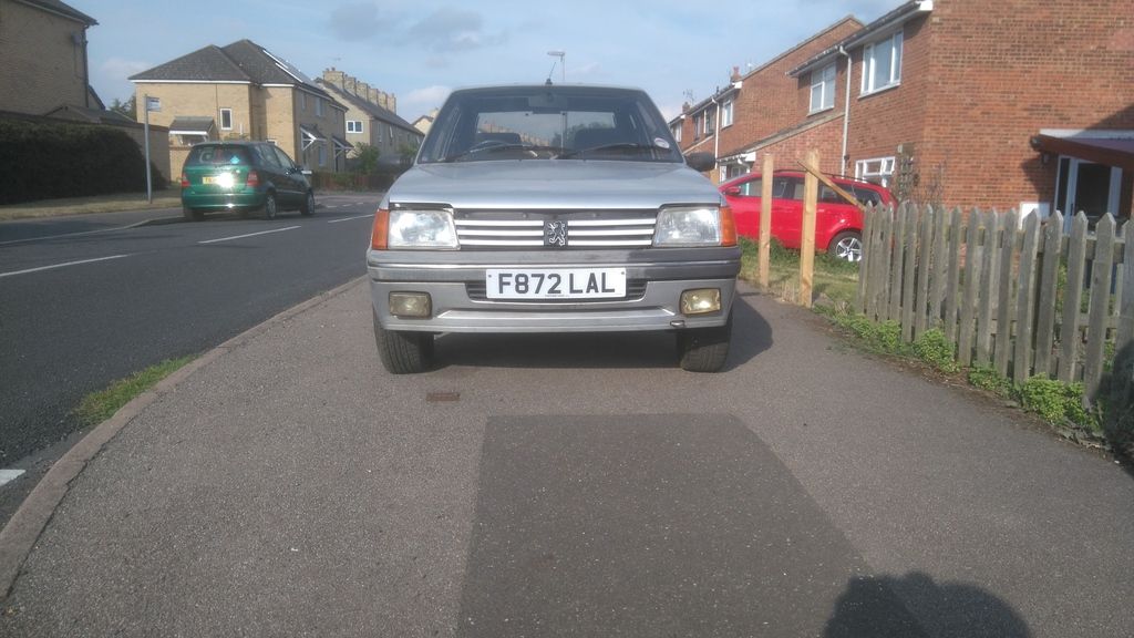

juice willis 2 Posted August 7, 2016 Thanks for the suggestions, got some time off work so will be able to get it in the air again. 1 interesting thing: I thought there was camber both sides but after putting a spirit level on the wheels it seems only the offside is out. It's miles out, must be nearly an inch over the span of the wheel. Something must be seriously wrong, I've done some measuring both sides and can't seem to determine what it is. The wishbones were bought as a pair from the local motorfactors, from what I can see the strut looks straight so bit scuppered. Share this post Link to post Share on other sites

juice willis 2 Posted August 16, 2016 I haven't put the old struts back on. The fact that I haven't yet seen it with the original steelies doesn't help. Im thinking that like you say they are original height but look different with the pepper pots on. The main thing is the ridiculous amount of camber. I'm going to get a pic up just to show how bad it is Share this post Link to post Share on other sites

juice willis 2 Posted August 20, 2016 I realize this thread is getting rather long winded so will try to wind it up. The front is as so: * New bottom arms * New track rod ends * New top mounts, bearings, rubbers, Billstein B4's * Correct hubs I'm fairly certain there has been this amount of camber since I bought the car. It is sitting on pepperpots which have temporarily replaced the 13" steelies, which I think have made the problem more obvious. Any final thoughts on this? I'm pretty much giving up at this stage. May take it to a garage or even better would pay a local 205 enthusiast to come and have a look! I have a mechanic friend that teaches at the local college who had a look and is as stumped as I am. Share this post Link to post Share on other sites
toolie72 67 1 Cars Posted August 20, 2016 Take wheel off and stick photos up off struts, wishbones etc That way other eyes can look for faults before you spend money Share this post Link to post Share on other sites
