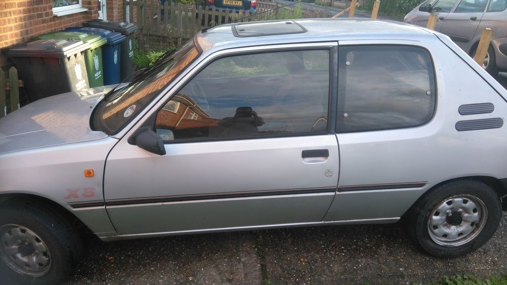

juice willis 2 Posted June 24, 2016 (edited) Thanks for all the useful information. I'm not extremely experienced when it comes to cars hence my input to this forum has been lacking compared to the help I have received. Looks like I will swap over the brakes from the XS to the GTI beam, i like the idea of having compensators. Although I'm sure I could add some from wherever they are on the gti onto the xs if I went for the GTI brakes? Anyhow I just picked the car up, it needs a good clean and someone has blanked the nearside door lock but is actually in pretty tidy condition. The wheels unfortunately will need a complete refurb as they look like a toddler has got hold of one of those silver markers used for Christmas cards and tried to color them in. The previous owner has done a fair bit of engine work on it and it runs beautifully. I had to hold myself back on the way home whilst grinning from ear to ear as it handles like crap. The rear has pretty much no movement whatsoever. I am planning on spending the next available weekends on tidying it up and sorting out the few things that need doing (had to unplug fan as it was running constantly, some dash lights not working) however It has been pretty well cared for so hopefully will be able to have some fun in it this summer. I may do a thread on my progress in the restoration section of the forum. Also who was it selling some OE XS decals? Cheers http://i347.photobucket.com/albums/p446/thaguewtomtek/DSC_0106_zpskx3xcfym.jpg http://i347.photobucket.com/albums/p446/thaguewtomtek/DSC_0107_zpsd0hwg7n9.jpg Edited June 24, 2016 by juice willis Share this post Link to post Share on other sites
