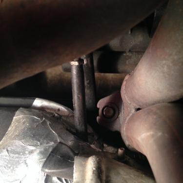

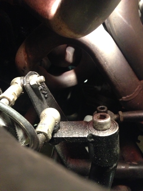

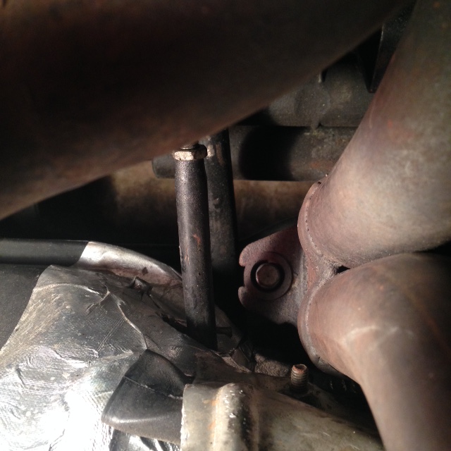

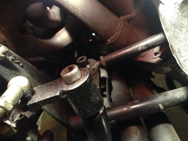

Pics of my 205 gti6 with Miles re-angled manifold with Satchshift.
Edited by Castorkid
blandy
That's brilliant thank you. Looks like I know what I'm buying next
Anthony
Unless I'm missing something, isn't that just the standard GTi-6 manifold and you were wanting pictures of the Miles/Pug Racing 4-2-1 Maniflow style manifold with a Satchshift?
blandy
Ah yes lol yeah it's the 4-2-1 I'm after I already have a reangled manifold
looking at it there's less intrusion than a standard shifter linkage and both rods are well to the left of the tunnel.
