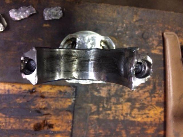

Autopsy complete. I suspect the cap from conrod #3 broke in two, as there is only part of it remaining. The two rod bolts snapped, remains of which are still in the main part of the rod. The remains of the two bolts and large part of the cap are missing. The engine kept rotating, maintaining oil pressure, until John shut it down. The crankshaft is in surprisingly good condition and should survive a regrind, thank goodness. Piston #3 is cracked (circled) and has substantial bruising (circled) where it has been smacking into the head. Mains bearings and remaining three rod bearings were perfect.

Rebuild what you had if you have spare parts or maybe move on to EW10J4S?
why did the cap and bolts break though?   seized / spun bearing?
Look at #3 rod journal. Other than a few dings, it's perfect. The remaining bearings are perfect, indicating there was oil pressure until it was turned off.
Andy
So not a bearing failure. Back to a rod failure then . Slightly disappointing given that you clearly went to the expense of fitting forged steel rods to avoid such difficulties . As we say in this part of the world........ bugger
wicked
If the bearing had spun, the crank journal would have more damage imho.  Think the cap was done with the continuous high revs...

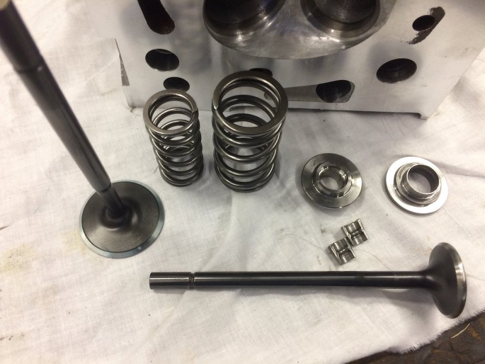

After many hours of fitting, fettling, cams in, cams out, etc., I'm finally ready to assemble our big head. It features long stem oversize valves, Z1000 collets, Supertech SPR-H1022D double springs, Z1000 titanium retainers, open 33mm buckets and no shims.
  • Haha 1
Andy
Impressive. No shims. Please explain . Have you ground each valve stem to the exact clearance ?
Yes and no. A combination of seat cutting, base circle changes etc. meant the shims would have been 1mm or less. I was able to source buckets with thicker pads which made up the difference. It was very fiddly and time consuming but worth the effort.
Andy
I see. That must have been a job . Getting each one exactly right must have meant many iterations. Impressive
