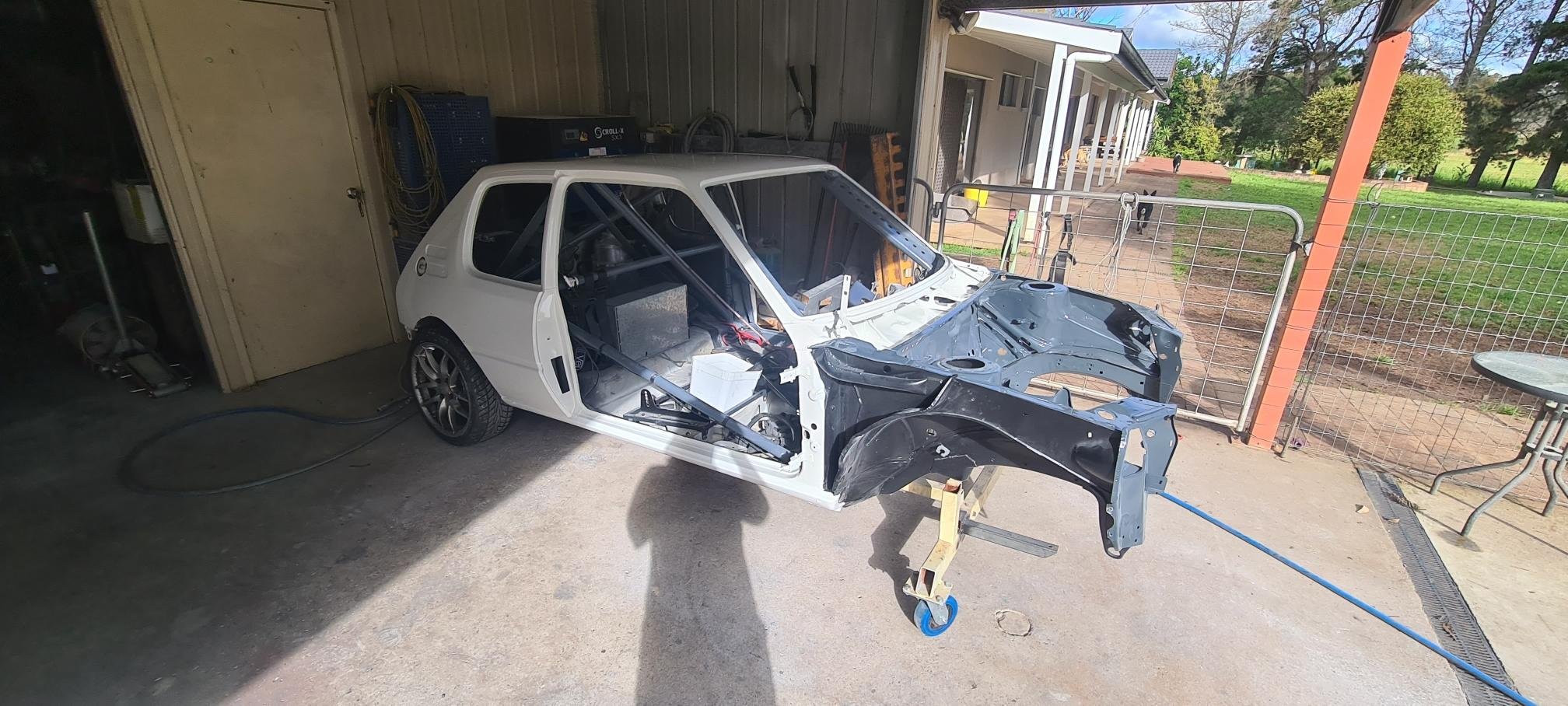

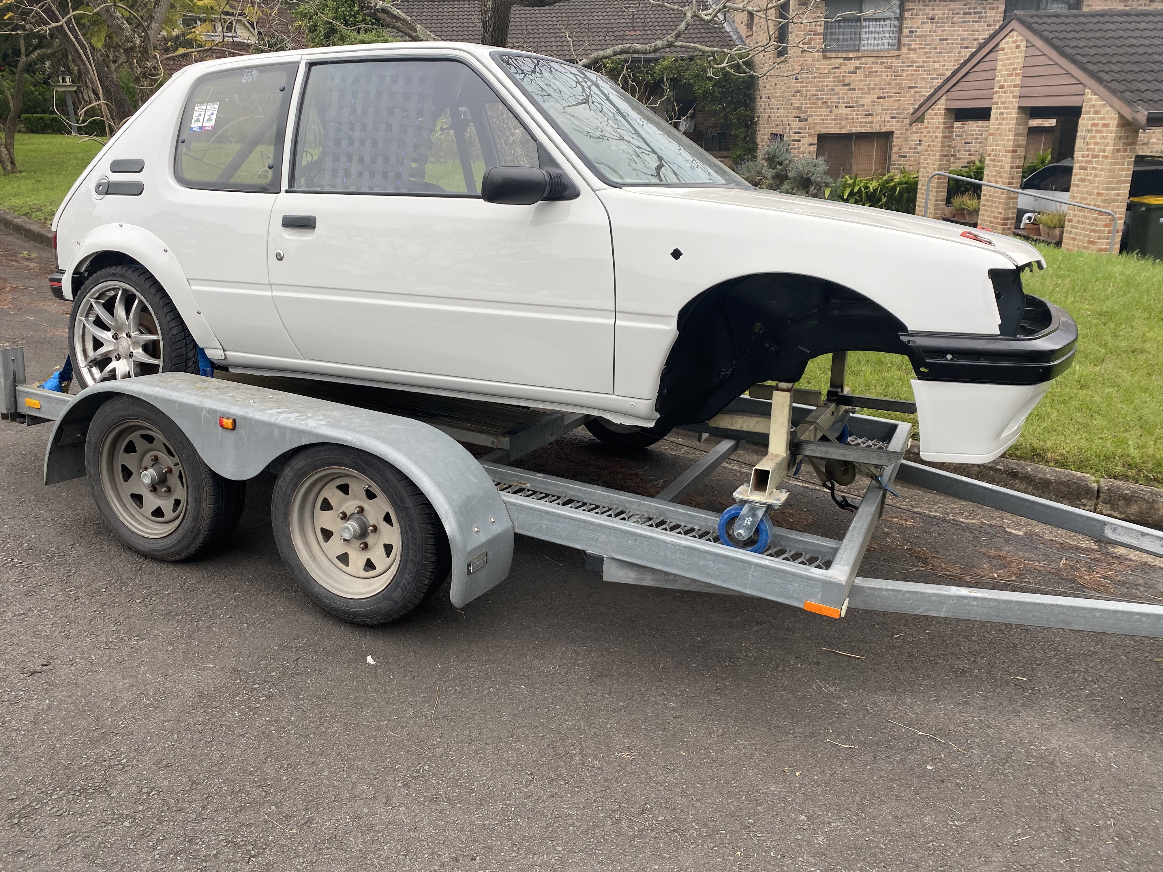

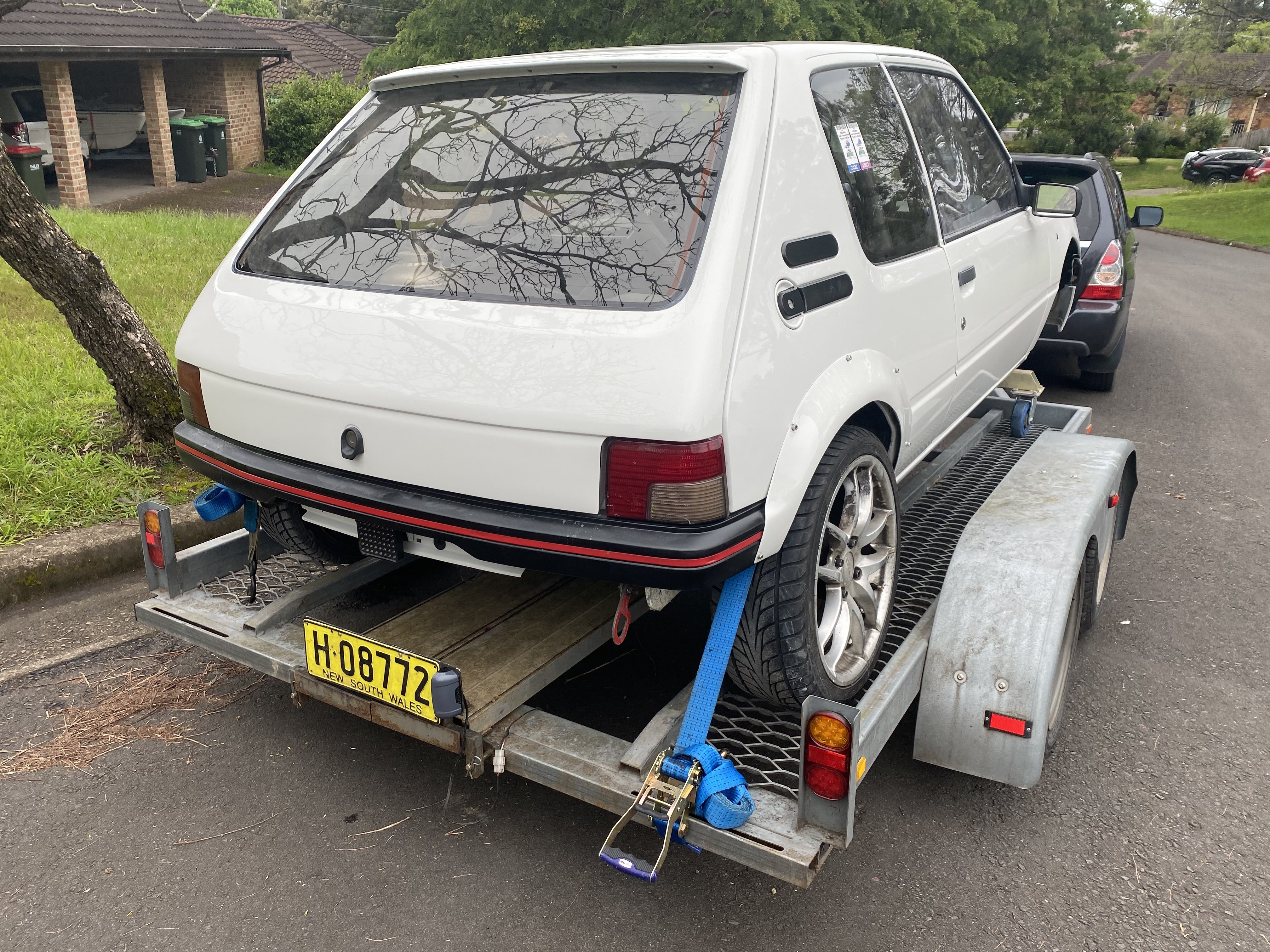

It’s been a while but the wait is worth it. I picked up the 205 from the repairer today. The front has been replaced (thanks to a donor) from the firewall forward. So much work. It’s also had a full respray and looks superb. Too good to race?
  • Like 6
mmt
Great news. Have fun thrashing it once again - after all it is a race car. :-)
andy0075
" Too good to race? "
.....too good not to be raced ! :D

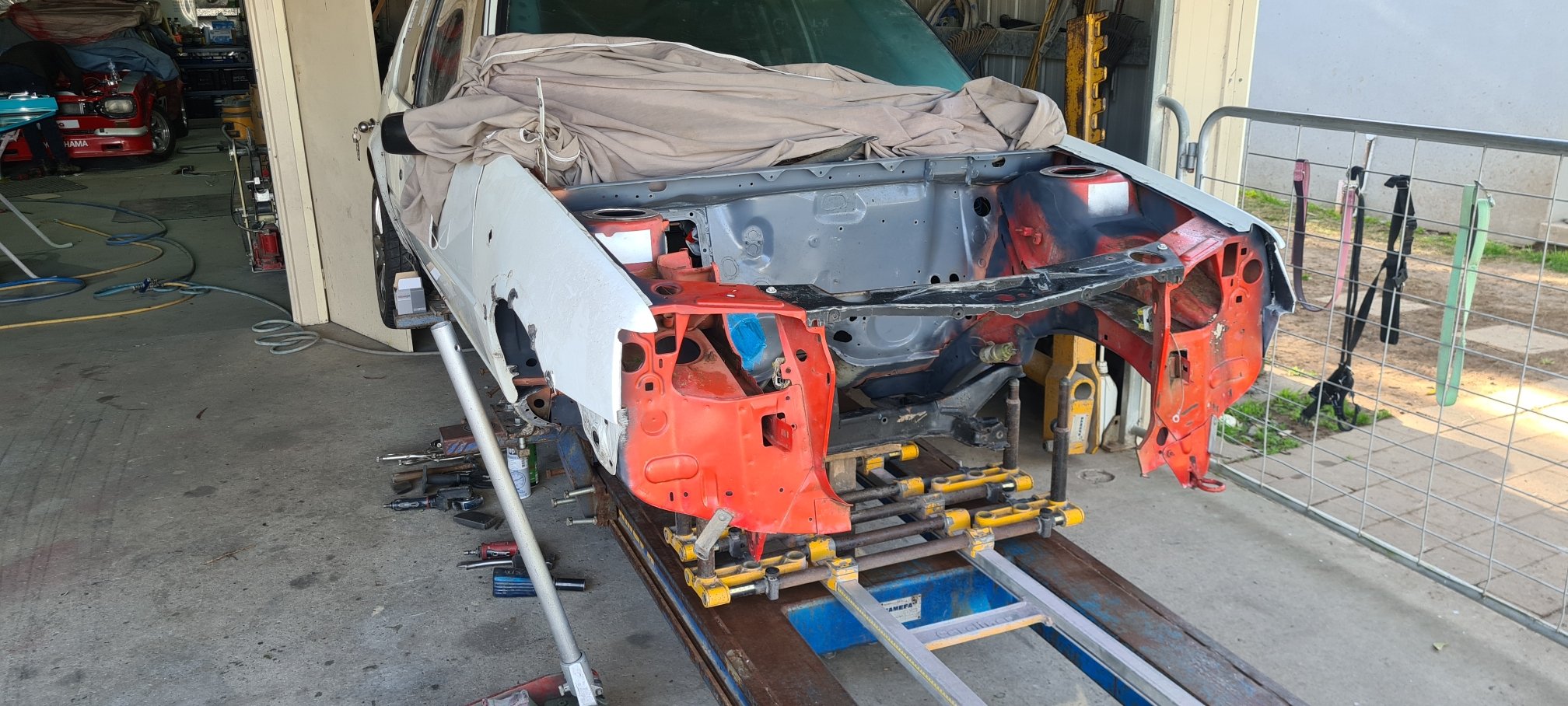

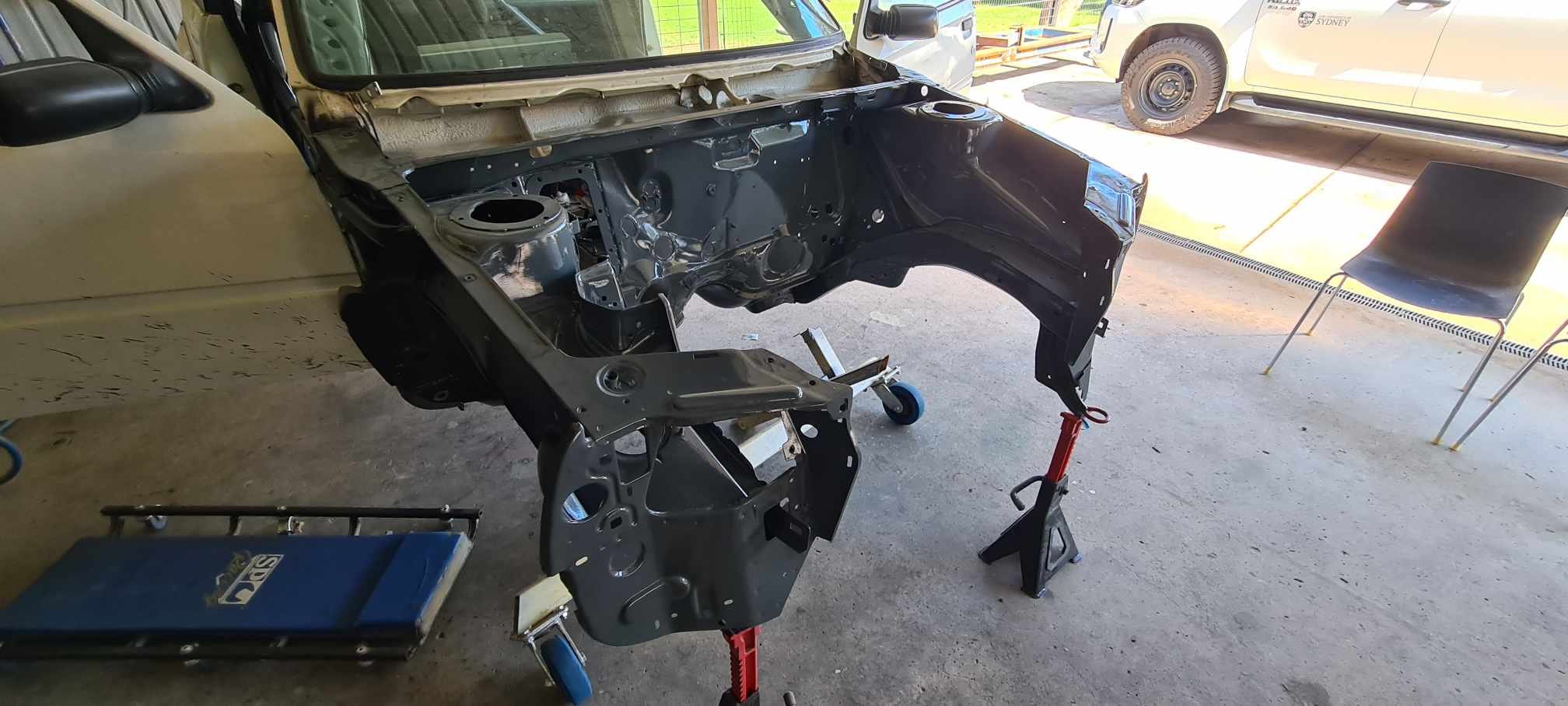

A few more pics. The damaged front end was removed by drilling out all the spot welds. The entire front was removed from the red shell and placed onto my car, on a jig to ensure it was still in spec. It came out perfect. The rails go right back under the footwells. Approx. 20kg of sound deadening was also removed in the process.
Edited by petert
  • Like 4
DamirGTI
Seems like the red 205's are the most common donors of the front end and overall bodywork bits for repairing crashed ones ! :P (i've also red one cut into pieces and stuffed in the shed for "stitching up" my project 205's needing "arms-and-legs" ! .. when the time comes ...)
Looking great , neatly done job B) ... always nice to see them fixed after the crash especially nowadays .
Will have to do the same job on one of mines , as one chassis leg is mangled badly along with the strut tower .. opposite side leg/tower is also suspicious thus i might need to do both sides too .
Are the chassis rails replaced complete in full length on the floor base or in section/"half way" ?
Was it much "off" when placed on a jig ?
if you have more pictures of the repair i'd like to see please :) (can send me on PM if you don't want to post them here ..)

20kg of sound deadening!? Where was that hiding? Or was it just in the the underseal?
Just all that underseal/deadening, from the front to the rear of the front seats.
mmt
That is a lot of dead weight to get rid of. How did you remove it?
9" grinder with a special wire wheel.
mmt
Thanks. Sounds like a very dirty and tough job :-)

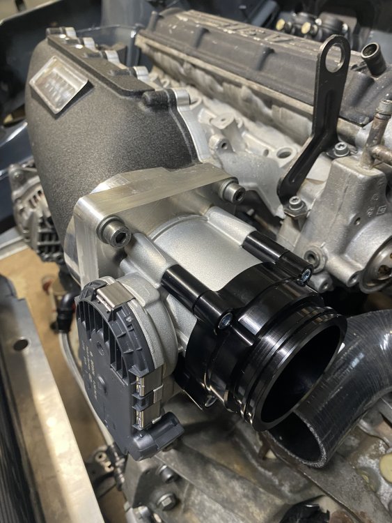

Some progress today. I made an o-ring spacer to adapt the Bosch throttle to the Skunk2 manifold. Also added the Plazmaman clamp.. Ready to make the hot and cold intercooler pipes now.
Edited by petert
  • Like 2

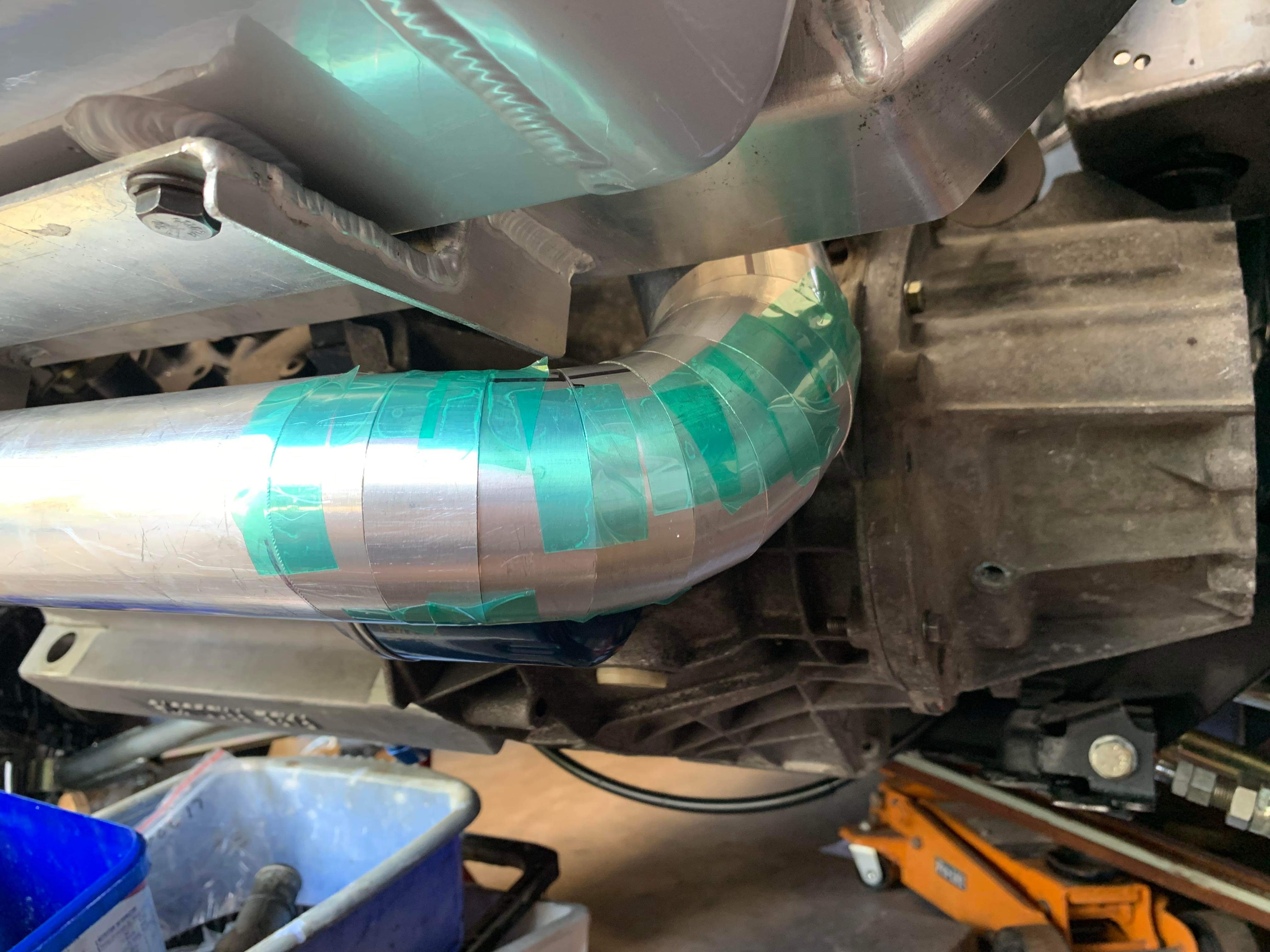

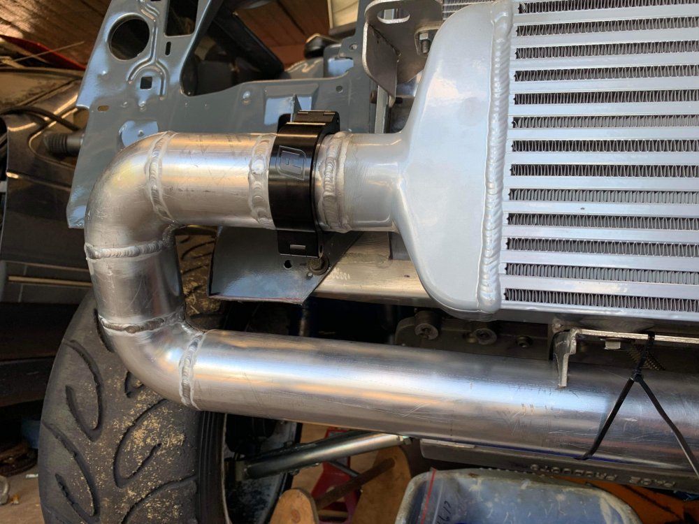

Some pics of the cold side of the intercooler. My son did a great job with the pie cuts.
  • Like 3

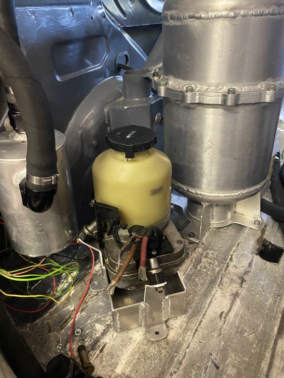

Whilst my son is still ticking along with the intercooler pipes (nothing happened in December), I've been pushing on with oil pipes. I decided I didn't want engine oil running through the firewall any more. Thus I've put the return & supply pipes for the dry sump tank under the car and enter via one of those round holes in the floor. Yes, the dry sump tank is still in the cabin, over the left rear wheel, but I can now put a passenger seat back in, if desired. It also provides natural cooling of oil.
Adding the turbo over the gearbox, meant the Mi16 PAS pump had to go. I've only heard bad stories about full electric steering and plate diffs, so decided to stick with the reliable GMH Astra electric pump. I'm also fitting this over the rear LH wheel, so again, the pipes have gone under the car.
Edited by petert
  • Like 2
mmt
Wow just WOW!
Spesh
Hey peter, I used epas (corsa b)  on mine with a 3J plated diff, no particular issues unless I'm missing something? curious as to what it is the problems?
Apparently they get very upset at full lock.

A bit more progress today, in the way of a bracket/tub to support the Astra electric PAS pump. If only they hadn't cut those wires off so short!

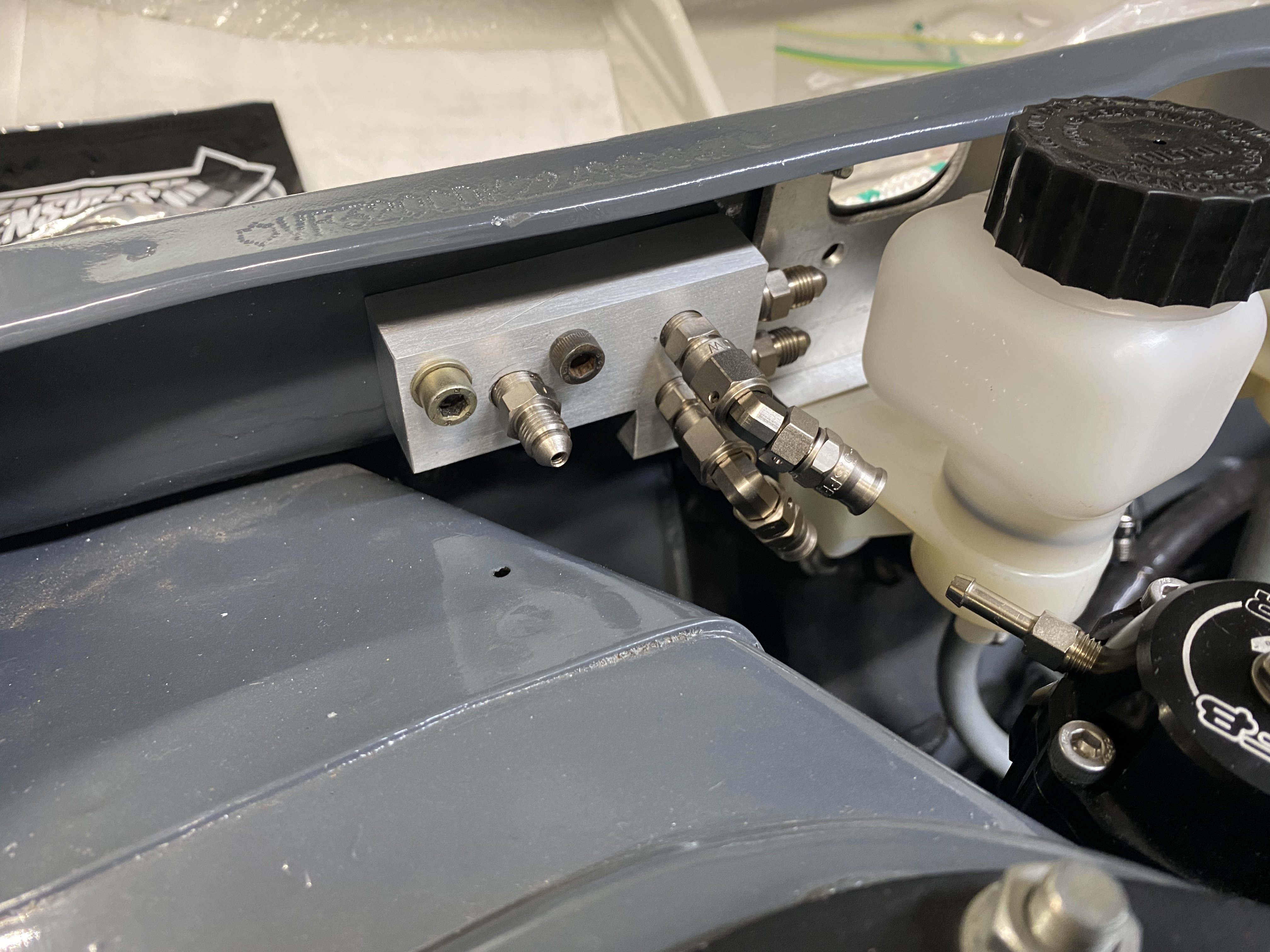

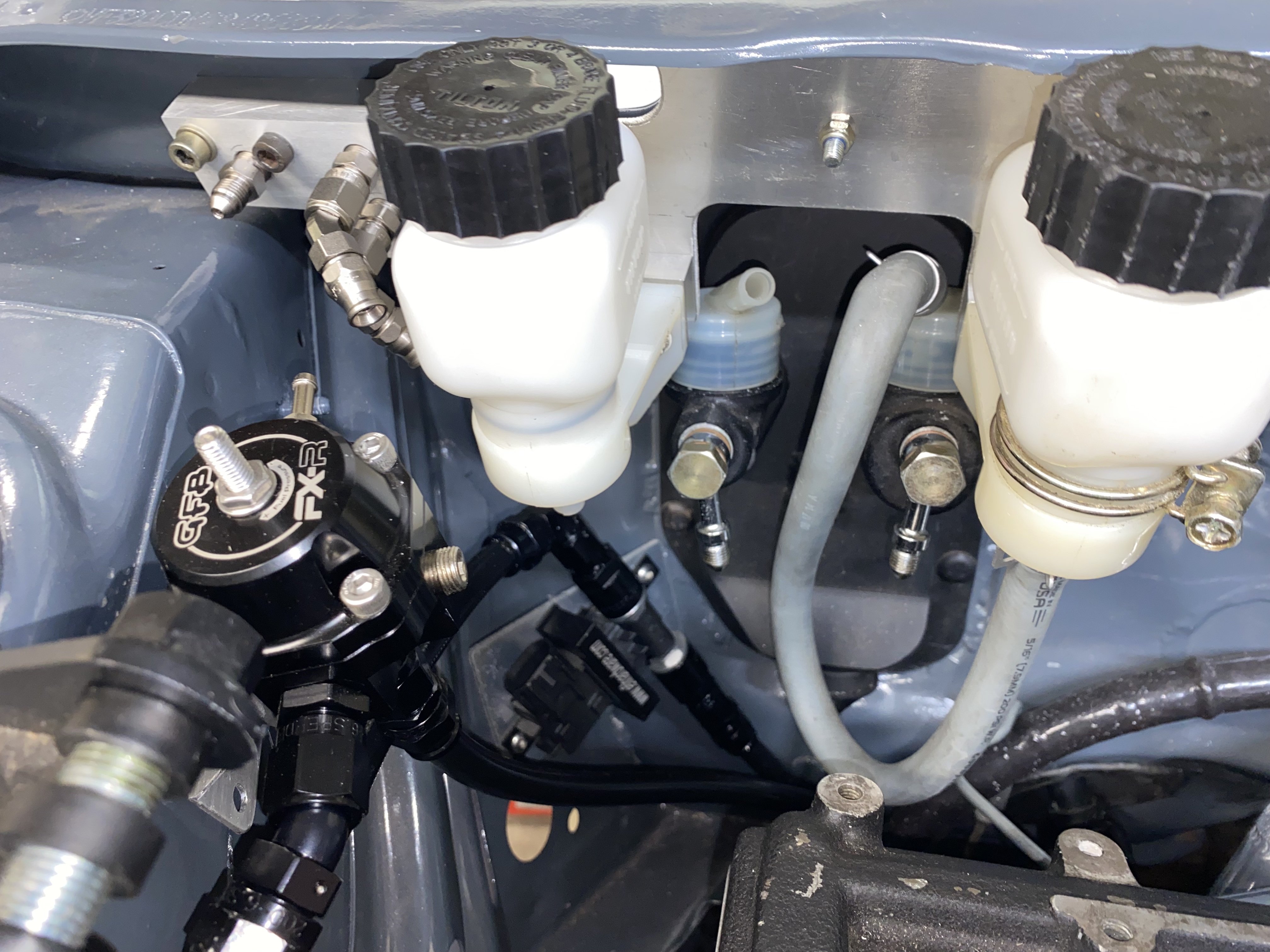

Work has been slow, but steady. Progress though on the brakes. My son wants to have data on brakes. So it was necessary to add pressure sensors for front & rear circuits. It's getting very busy in that corner and this is what I've come up with. That aluminium block accepts fluid in/out via 4AN flexible lines. Two sensors screw in from the bottom. The hole behind the two master cylinders is where the harness will pass for the brakes, fuel pressure and flex sensor.
Edited by petert
  • Like 4
mmt
Looks great. Real pro work.
