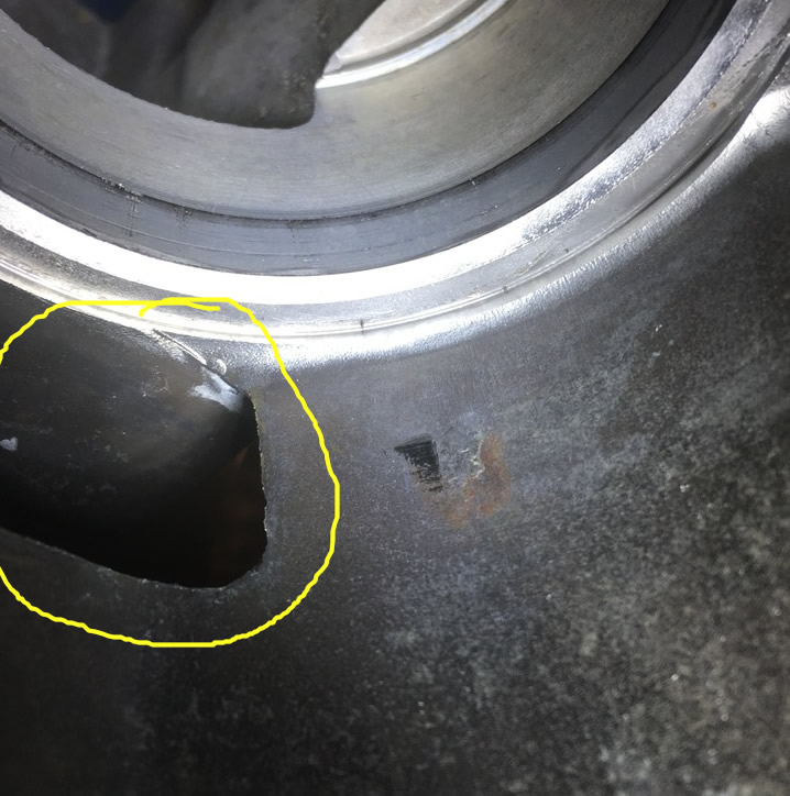

Shane17 7 1 Cars Posted December 29, 2016 Cheers Andy, I was actually quite surprised how many parts are still available for the engine. I've got as many new bolts as I could plus the timing belt and tensioner. So today I actually did some things....... mainly cleaning then p#ssing about with liner protrusion! Numbers two and three slid in relatively nicely and protrusion was good, numbers 1 & 2 were just doing my head in I put them in and took them out god know how many times because they just didn't go in right and was as if they were interfering with something pushing them off balance leaving one end with like 2mm and the other almost right, after looking I discovered that the liners were touching the inside of the block where it bulged..... You can just about see but it does contact, below is the inside of the block with liner removed, you can see where the liner has scuffed the inside of the block I think this is because my liners are 83.5 and they just kept the liner thickness the same OD not allowing for the 0.5 as this is about what I needed to take off, I used a dremel with a grinding tool to carefully remove some material around the scuff area on the block.... I assume this is ok, I didn't want to take it off the liner! After taking the material off the liner just dropped straight into position and bang on for protrusion, note that I had to do the same at each end of the block as they are symmetrical and both liners were doing exactly the same thing so that's why I knew it wasn't the seats. The light is a bit crappy but the liners are in with good protrusion and the whole block scrubbed clean, fingers crossed will be getting this built up in the next few days. Another awesome bonus UPS found my package and delivered it today it's late but so glad it arrived, also got my loom and ecu from sandy so it's all getting here I just need to find the time and make it happen. Gotta love a bit of shiny sparkly engine bits Share this post Link to post Share on other sites
Shane17 7 1 Cars Posted December 29, 2016 Just going back to the liners touching the block...... do I need to allow a a bit of a gap here? It's hard to tell how tight it is Share this post Link to post Share on other sites
welshpug 1,722 Posted December 29, 2016 (edited) the liners look like they are smooth on the outside but with a defined edge? o.e were almost pineapple like, you'd be fine to take a tickle off the corners. I would relieve them till they aren't touching, you need to ensure they seat correctly and squarely or the headgasket and liner seals wont have a chance of doing their job properly. you can see in your picture number 1 and 2 aren't sitting straight like the other two, though this in itself isnt a concern, it doesn't look right Edited December 29, 2016 by welshpug Share this post Link to post Share on other sites
Shane17 7 1 Cars Posted December 29, 2016 Yes they are, and sort of bulge vertically, I need to dig out my o.e ones to see if they had reliefs so that they would avoid this section. Like I say I think that because I have gone 83.5 Westwood didn't allow for this, Andy has 83mm ones and hasn't seemed to have a problem. I'll relieve a touch more when I remove them for the build. Am I safe to still take more off the block? It's next to a waterway. I assume it's not best to take some off the liner? When they were all in I checked on both axis up the centrelines and each liner for difference and all read good, I am going to double check tomorrow, I checked the block deck before putting the liners in and flatness was all good. I'm pretty happy with these and feel pretty confident it's putting the crank in and pistons/ rods that I'm a little nervous on, and cleanliness is constantly bugging me especially now I'm removing metal. Share this post Link to post Share on other sites

welshpug 1,722 Posted December 29, 2016 I'd rather take some metal off the liner, easier to clean up and less impact on strength.they're obviously a lot chunkier than the original ones as they aren't cast, it would have taken a few more machining operations to make sure they fit in every block which I guess they decided not to bother with. Share this post Link to post Share on other sites
petert 630 Posted December 29, 2016 You need to clean up this area with the dremel. Last thing you want is some of that breaking off and entering the oil system. Share this post Link to post Share on other sites
