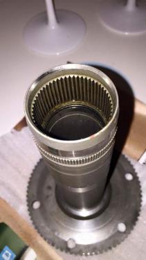

Since I cannot afford the reinforced center diff shafts from www.atdperformance.com,I wonder if any other proven methods at hopefully a much lower cost is available?
I did find some comments on one citroen forum but it did not state any details. So currently my plan is to find out what type and size the original cut splines are - does anyone have this information?
and then I will source the appropriate spline tool in order to extend the "male" part by min. 50 mm with hardened steel to allow for more overlap between the 2 Axle´s - hopefully sorting the torque transfer problem
Anyone tried this approach with luck?
help is highly appriciated - thanks :-)

Probably better to utilise a far stronger stock drive train from a different manufacturer, mitsubishi has been done.

but pure torque will snap the splines - agree with Tom

Making the splines longer won't help you, as by the end of the engagement they'll be taking basically no torque anyway due to the spline flexing ahead of them, that's why you find most spline connections are only the same length as the diameter.
Basically the twist that's happened above in the pic happens normally under load across the entire spline - obviously not to that extent - but making them longer just means the end has bent before the longer part starts taking load.
You'd be better making a new part with closer spline tolerances - they're a bit loose on the OEM stuff, in fact they're looser than my driveshafts on the buggy and those are deliberately loose so they slide on the spline.
I've come across this approach before on a different application - clutch output shaft was male spline, gearbox input was male spline, and there was a female splined coupling to join the two. In high output engines, the coupling had a habit of stripping. The solution was to make the male splines slightly oversize and press the coupling on & off a few times so there was zero play in the joint. Bit of a pain to do but once done, it cured the problem. Could be worth a try here.

imaS
This is a nice Finnish upgrade :P
How much abuse that got, and what was the torque output of the engine? Looks like it broke from the weld after twisting?
The Finnish solution has worked well in my stock Mi16x4 but that does not have much torque. Though all of it is used quite often...

B1ack_Mi16
It was a T16 trying to do a burn-out on all 4 wheels from stand still in 1'st gear, so maybe not strange that it let go.
But as expected the weld area seem to be the weakest point.
My guess is that the ATD shaft would have been able to hold this. However once one get to 2'nd gear and upwards there's much less likely to get problems..
