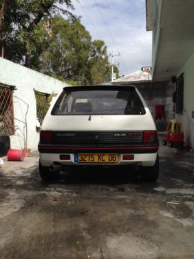

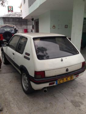

Hi , I got my car a few weeks ago ... Veey rare car in my country ... I juat started cleaning it , very good condition but no engine .
Mr_bugatti
I will post some pics ... Let me figuer out how to do it from my cellphone
Mr_bugatti

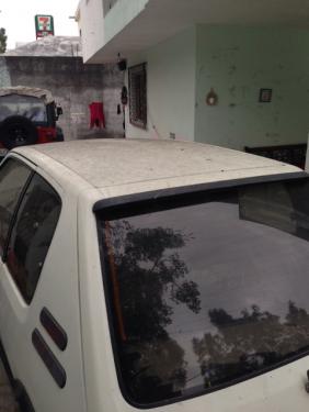

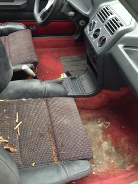

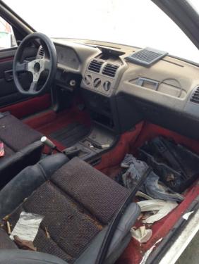

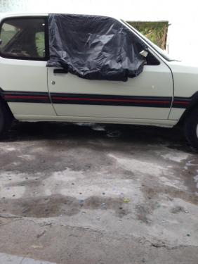

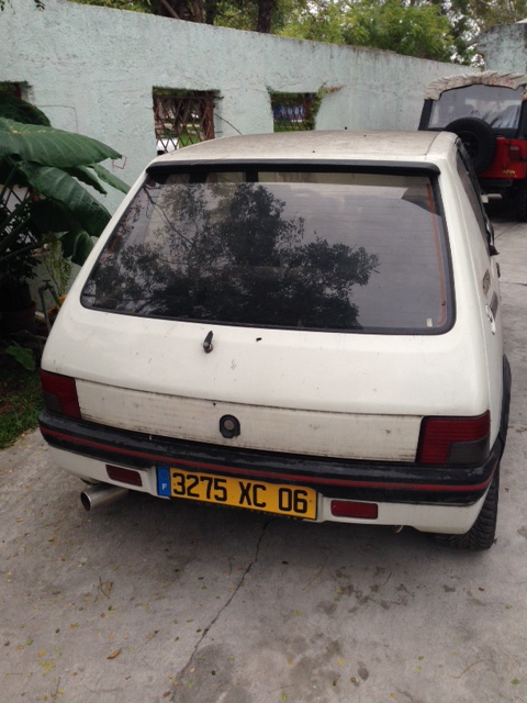

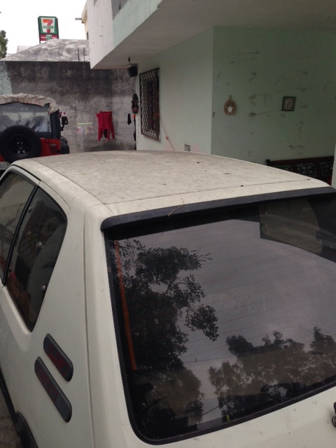

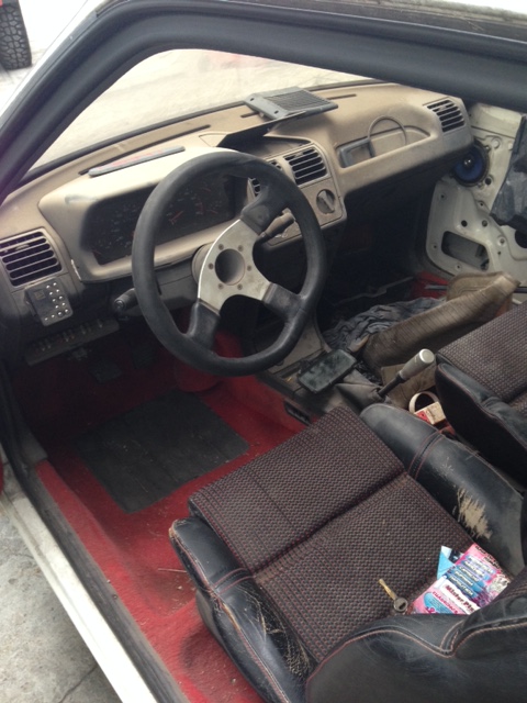

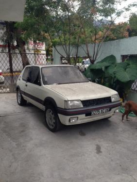

here are some pics ... the car is very solid , no rust ...
  • Like 2
camgti
Awesome man! Great find. It must be super rare in Mexico!
Looks like a solid shell. The interior needs a good clean! Its lucky that the dash looks to be good.
What are your plans?

Hi, thank you all ... I will be needing a lot of help , would be great if someone can help track right side window glass and ship to mexico , I saw a afew on ebay but sellers do not want to ship . The car es pretty much complete ... no engine , the block is there but no pistons no head , intake and all other parts are in the trunk ... want to just try and fit any other engine ... still dont know what will be an easy swap , I do want to use the original trans ....
