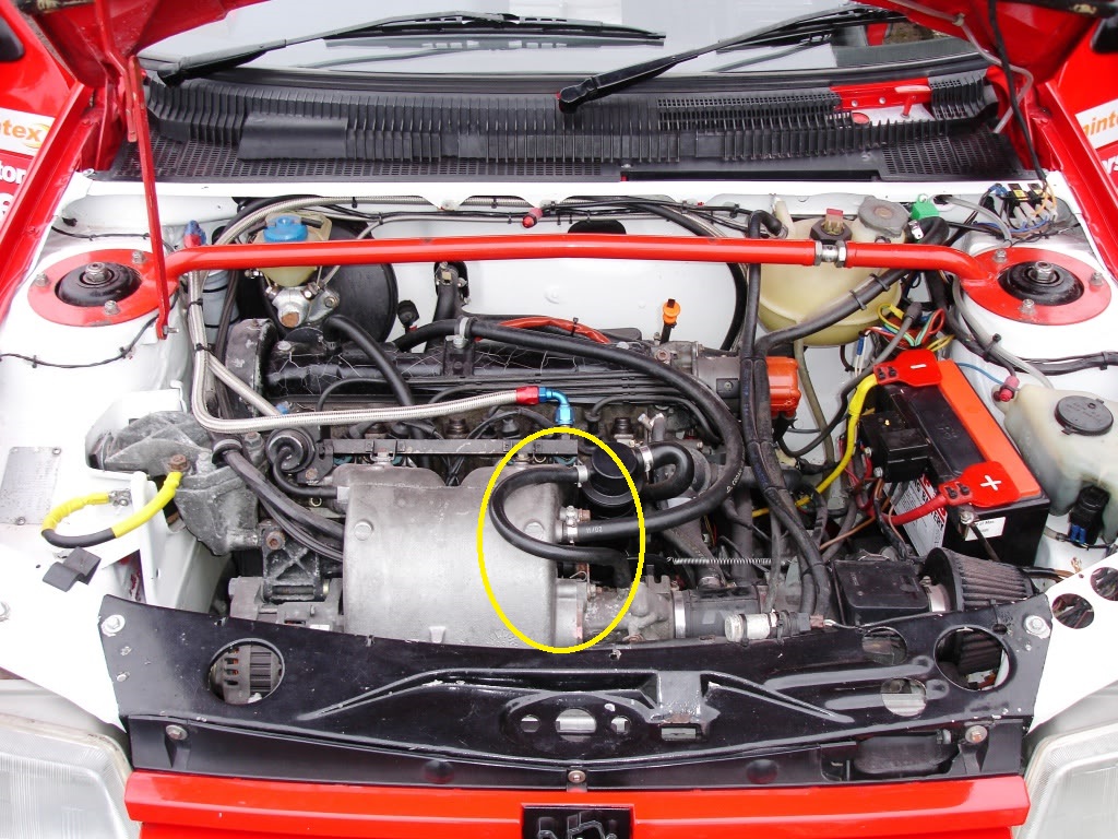

Hi everyone,
Can you tell me, this pipe that goes from oil cap to throttle body, what is for ? When I disconected it from oil cap, and try to blow, air won t come across... I checked pipe, it s ok ... It seems it is clogged on throtle body... Can it affect poor idle?
Thanks...‹
idoari
This pipe is for the oil breather, it allows the crackcase to recirclate oil vaupors from the oil pan to the intake manifold - just like a modern pcv valve.
This pipe needs to be clear, i think it's could efect performance and fuel economy.
PhilNW
the blocked hole in the throttle body needs to been cleaned out, I had to drill it out with a very very fine drill
It provides a vacuum which takes all the vapours from the crankcase, in my case the blockage caused the crankcase to pressurize and cause oil leaks
Because of the small amount of air it takes it can affect idle speed and running

If used in competition blank it all off as it just sucks any oil vapour back into the engine
pedjoni
I ve done it.. Get air through. Cleaned out everything . Now it s ok... One question. Is the same engine 205 1.6 gti and 309 1.6 gti ? They looks same... ???
