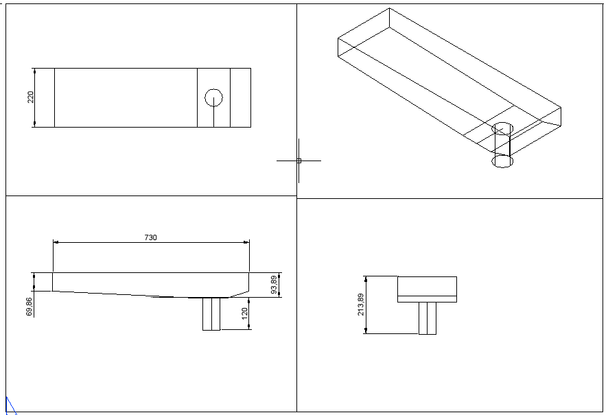

This is wise. Even if you put a fuel cell in the cabin, the fill and exit points are still exposed, meaning the driver's area still needs to be separated with a flame proof wall (in some racing categories). Keeping the original tank and adding a surge tank under the car overcomes these obstacles. Here's one I'm making at present which fits in the spare wheel area. It has additional capacity to get the overall fuel capacity to approx. 65L for an endurance race.
