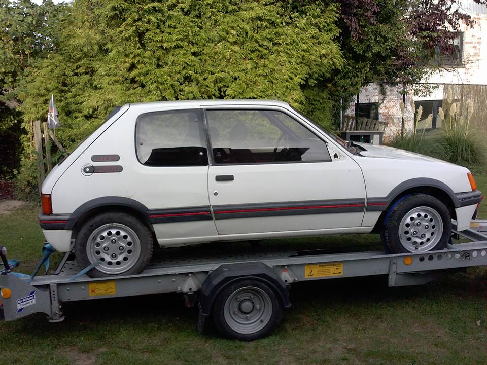

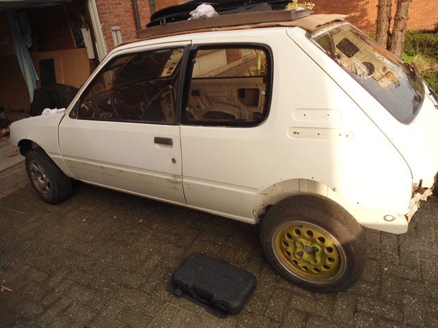

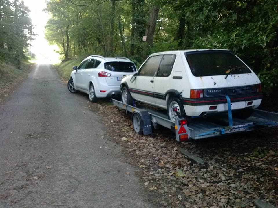

Pictures how preveus owner picked it up.

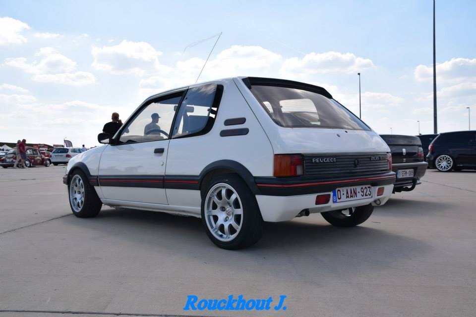

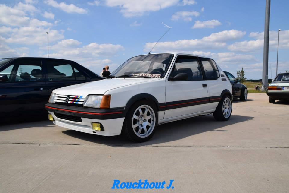

205tunerke

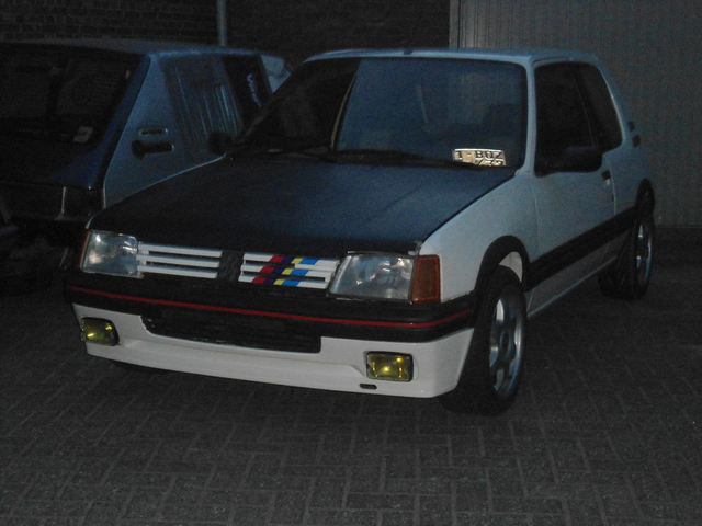

Current state except for rear side windows

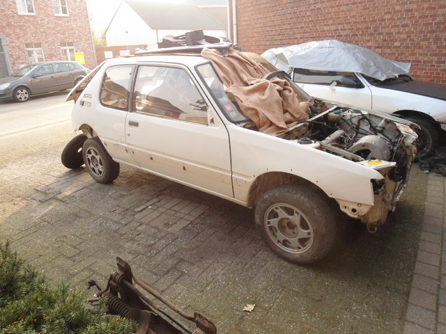

205tunerke

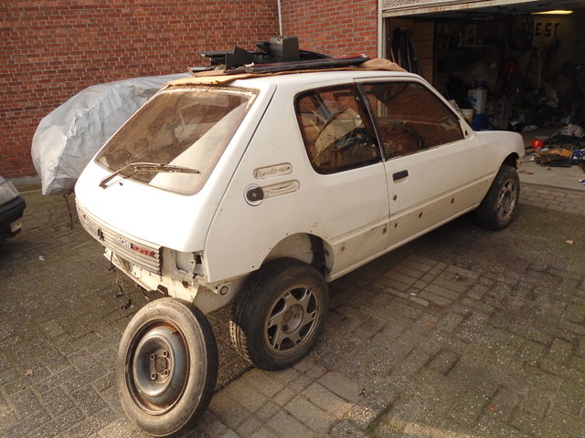

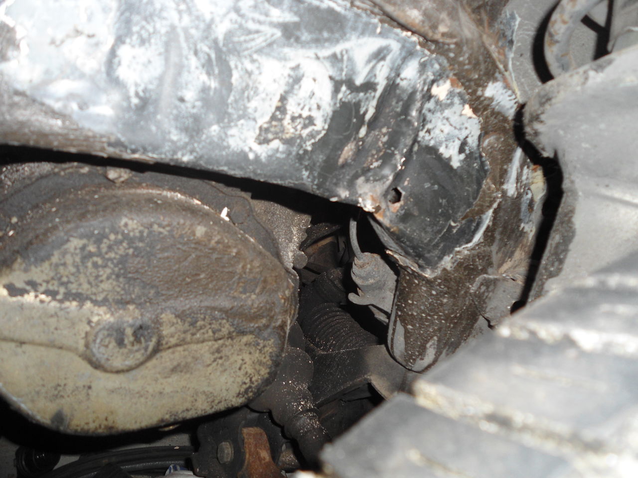

How it arrived...
On Busted discbrake rearaxle, trashed engine,stript interior and bend chassis member

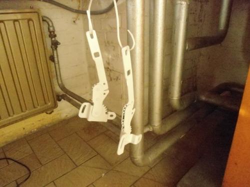

sourced Original hood hinges from a pre 86 car in perfect condition.
most of them miss a few teeth...
and found the time to mount them.

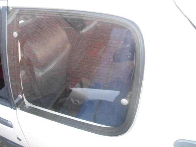

I found the rear side tinted windows without the black outline on them.
specialy from gti from 84...
allso found non-shruncken rear side window rubbers and mounted these with the new rear windows.
an ugly site, as soon as you see it you realise why they made the black outline on it.
but it's rare and Original, so for the time being it stays this way...

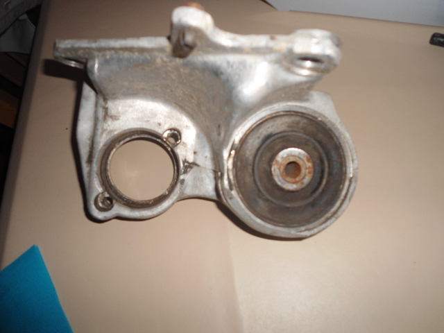

also found a an Original rear full engine mount.

Any chance of some bigger photos of the installed side windows please?
205tunerke
bigger picture as requested.
real ugly!

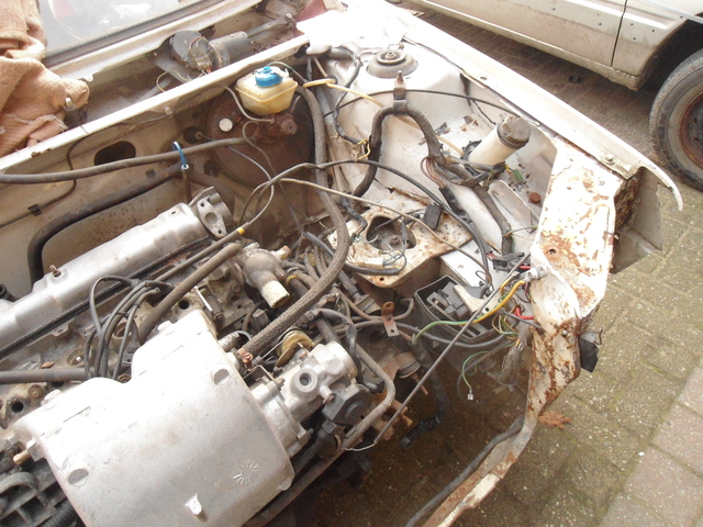

after degreasing and pressure washing came the stripping part...
and the result...

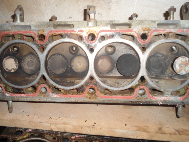

205tunerke

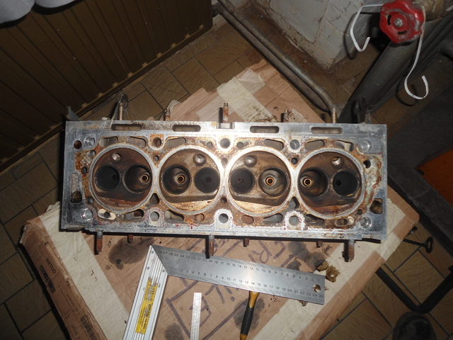

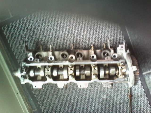

pulled the head of the original engine today.
did a few measurements, burning chamber is 1mm deeper on the 105bhp head...
will need to conform height of the head when the cam is removed.(measuring cambearing- buttom)
hopefully i'll be able to just skim the head, alltough i'm afraid that the distribution timing will be messed up...
don't now if a abjustable cam pulley will do the trick...
if not i'll be forst to change the appearence of the 115 head to that of the 105 head.
apart from depth the form of the burningchamber is different to, alltough this would be an easy modification grinding it down a bit...
on the 105 is has a straight ridge where the 115 is wider on the inlet side, to make room for the bigger valves...

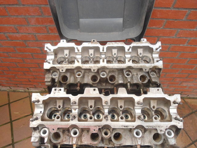

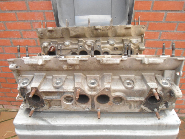

205tunerke

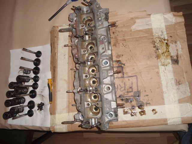

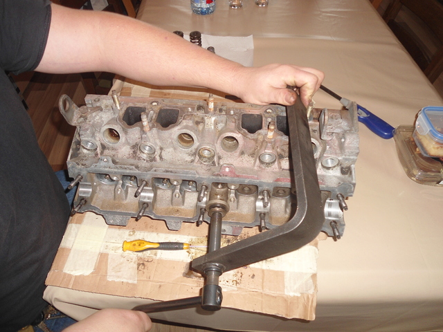

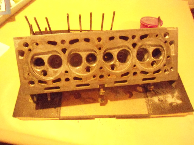

got a little bit of work done yesterday.
disassembled the 105 bhp head ending up with 2 bear heads...
did the depth measurement again, this time the right way and they seem to be equaly deep.
this means i can proceed forward with moding the 105 bhp head :D
next up changing the combustion chamber chape and search somebody who can grind down the bigger valve seats...
on the pictures you have a clear seight in the differences of the heads...
the 105 head has a symetrical layout on top, where the 115 clearly doesn't.
allso the 105 head is more wider at the bottum rear( look at the headboltholes...)
will put them on the scales on of the days to see if one weighs more then the other.

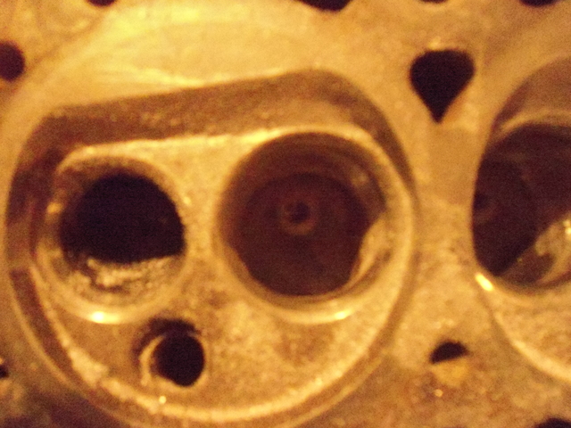

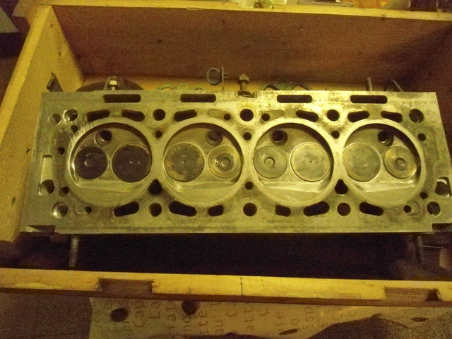

got the head back after changing the valve seats to fit the bigger valves...
you can clearly see the bigger valveseatopening on the inlet side.
on outlet the duct is larger then the valve seat opening.
205tunerke
just spend 2h grinding the inlet duct to the size of the bigger valve seats, just to improve the flow a little.
no point of putting bigger valves in if the duct size isn't addepted to...
not making a race car, so no need for high performance polished ducts etc...
