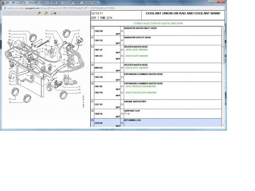

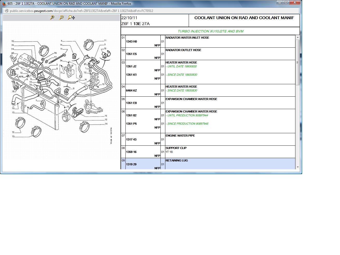

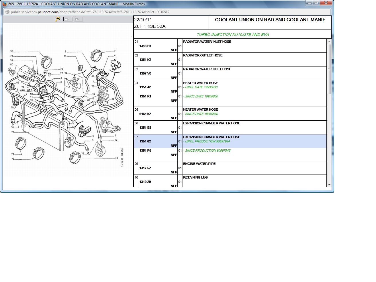

The first pic is for a manul box with the heat exchanger hose built into the top hose, the second picture is for an autobox which has different piping for the heat exchanger, this is the top hose i have on my car. you can see the turbo pipe feeding to the top hose on both of them.
Stew baker needs to make this top hose without the heat exchanger connections and the top rad hose facing the right way, imo it would be a good seller as its the hardest part of the turbo conversion to overcome if you dont have the original pipes to bodge, ive cut mine off and joined it 180 degrees
