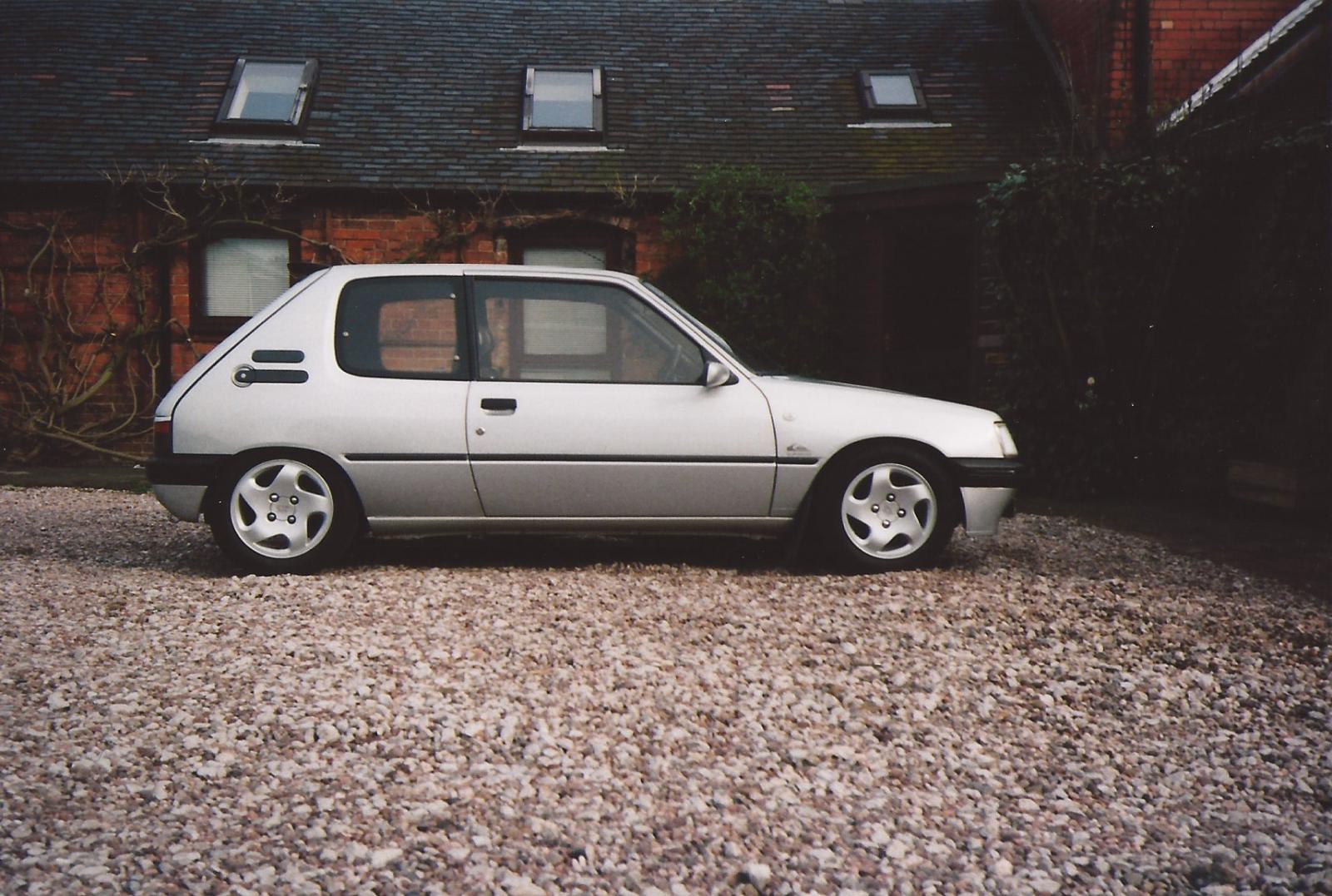

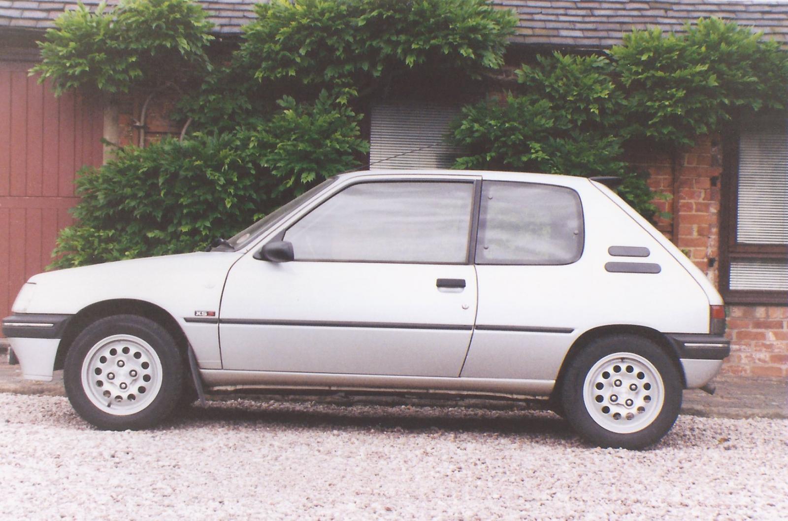

To give you an idea:

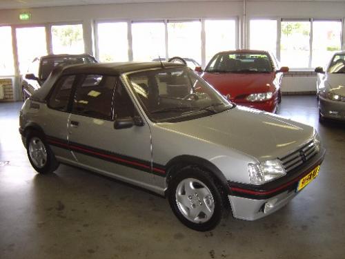

And this is a CTI though so has arches:
