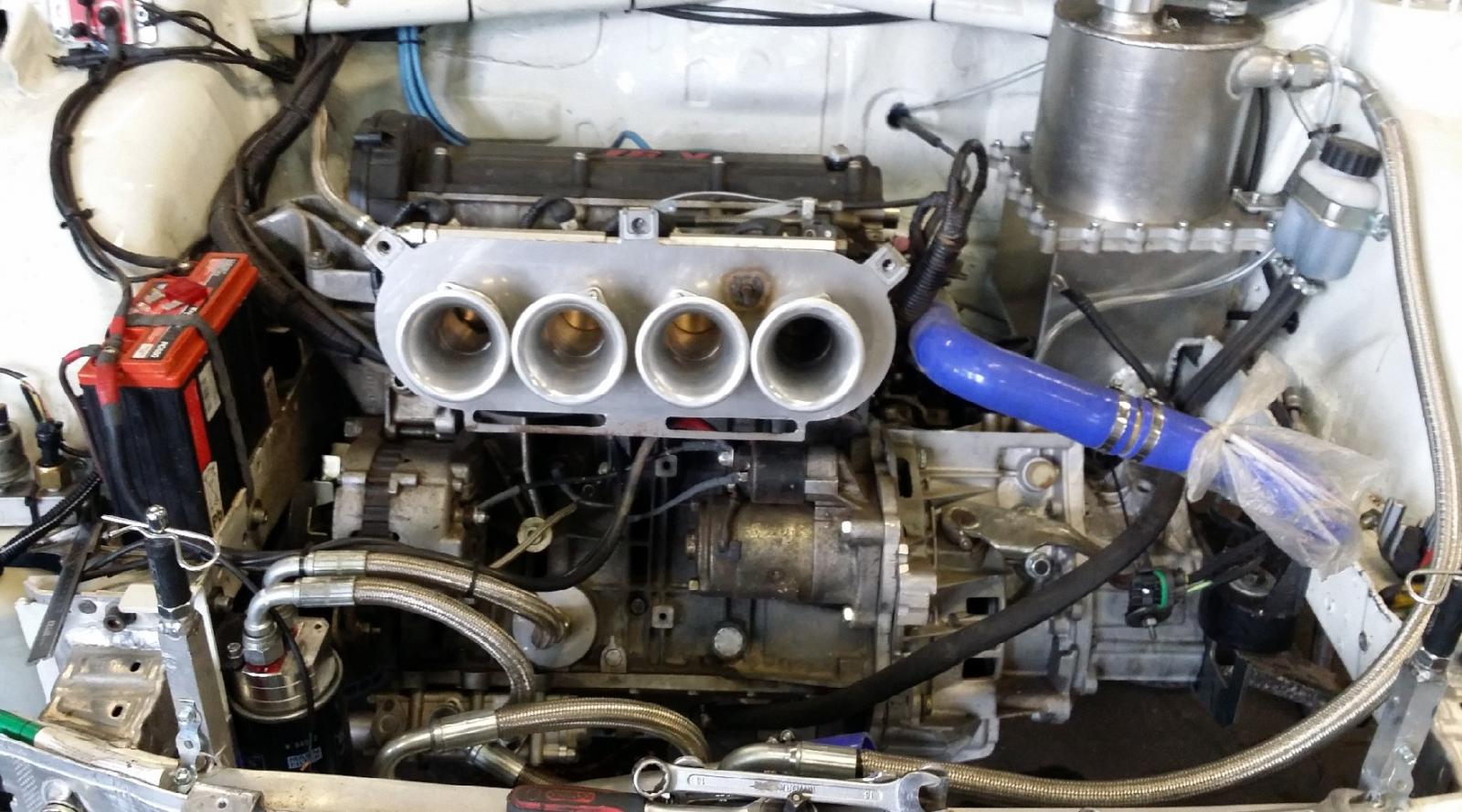

Hello all, we have a nice engine and car here, long list of parts but some lack of power.
Dont get me wrong, it works, no problem with reliability, hitting 9000rpm, has some 11000 miss shifts also... built as is should.
Torque is about right with the short stroke, if it would keep the figure till 9500 the power would be over 210 but its not the case.
Parts:
Ross pistons, dome high as normal plugs wont work, just racing ones
Aluminium rods, half the weight on the piston end ad steel...
Stock xu5 crank balanced
Catcams in the head, solid lifter 298/282 at 106/110
The head its not ported just the surface is cleaned polished
Ferrea 6mm steam, stock head size
Jenvey ITB (needed some after work to fit right...)
Pace dry sump, best choice, all the lubrication problems the XU has have disappeared, after a year of racing the bearings are like new.
Running on 102 octane race fuel.
At the moment it has a 70mm exhaust, last year it had a 60mm, no real change in max power, but its more consistent. Header is the same size as the 309 but straight.
If anyone here has some idea where the power is hiding please share :)

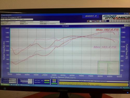

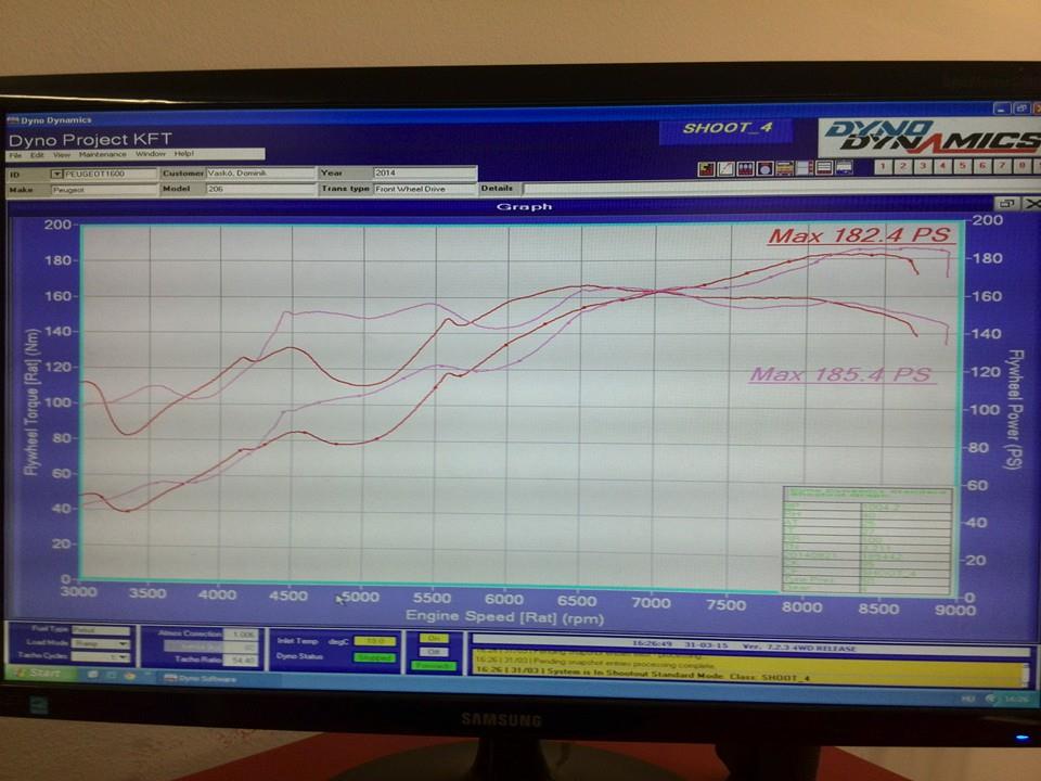

Dont know if I'm missing something or we have some problems with the cam selection, maybe internal vibration...maybe the dyno :P
We made 168hp with stock TU head just biggest hydro cam and springs, and 12:1 pistons, stock intake and just a 60mm cat-back.
