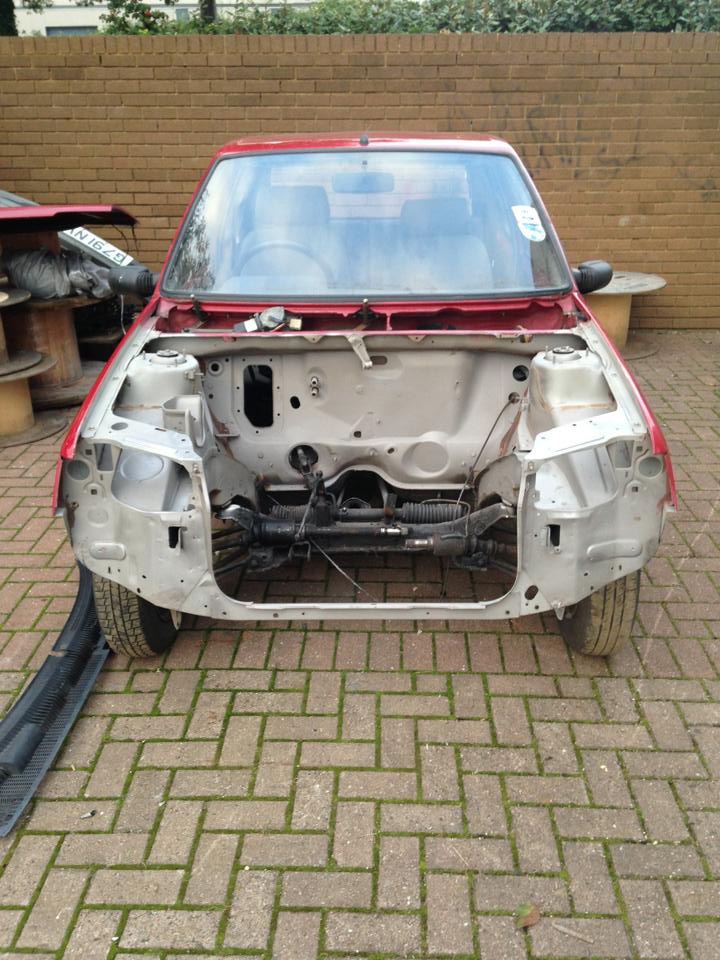

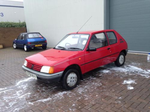

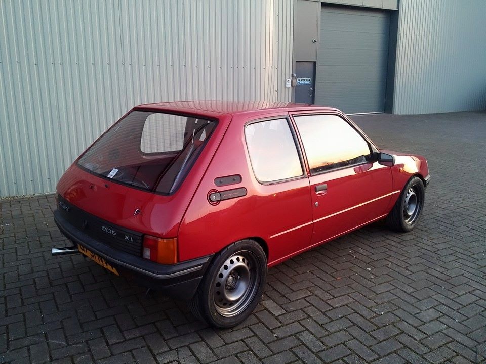

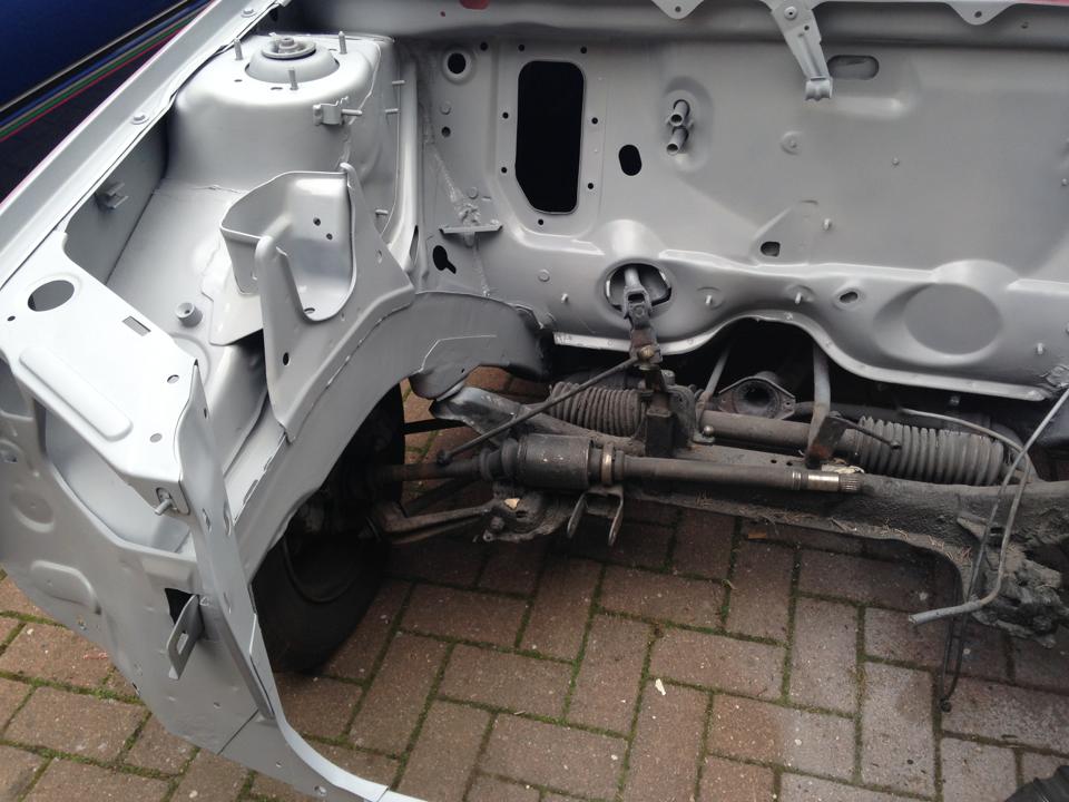

Started life a few years ago as a standard 205 XL, I basically stripped everything off the car, to start fresh with a 3 door non sunroof shell to work from. Hope its an interesting build, photos jump a lot as its been on going for a couple of years.

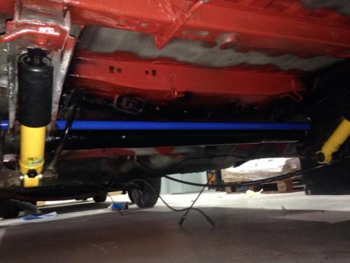

With Spax RSX coilovers, solid top mounts, various poly bushes and the engine with a pokey claimed 150bhp.
I managed to get some torsion bars through the forum, although I can't remember who from.
New 22 torsion bars and a 23mm arb

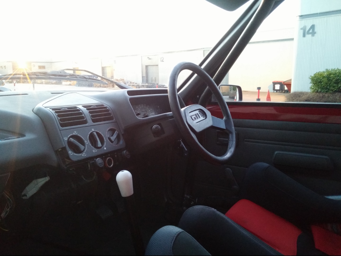

I welded in an omp cage which I need to take some pictures of for reference as we made a pretty great job of the strengthening plates and welding in the cage.

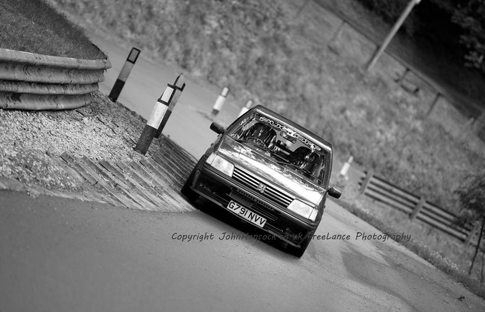

FCS castle combe 2014

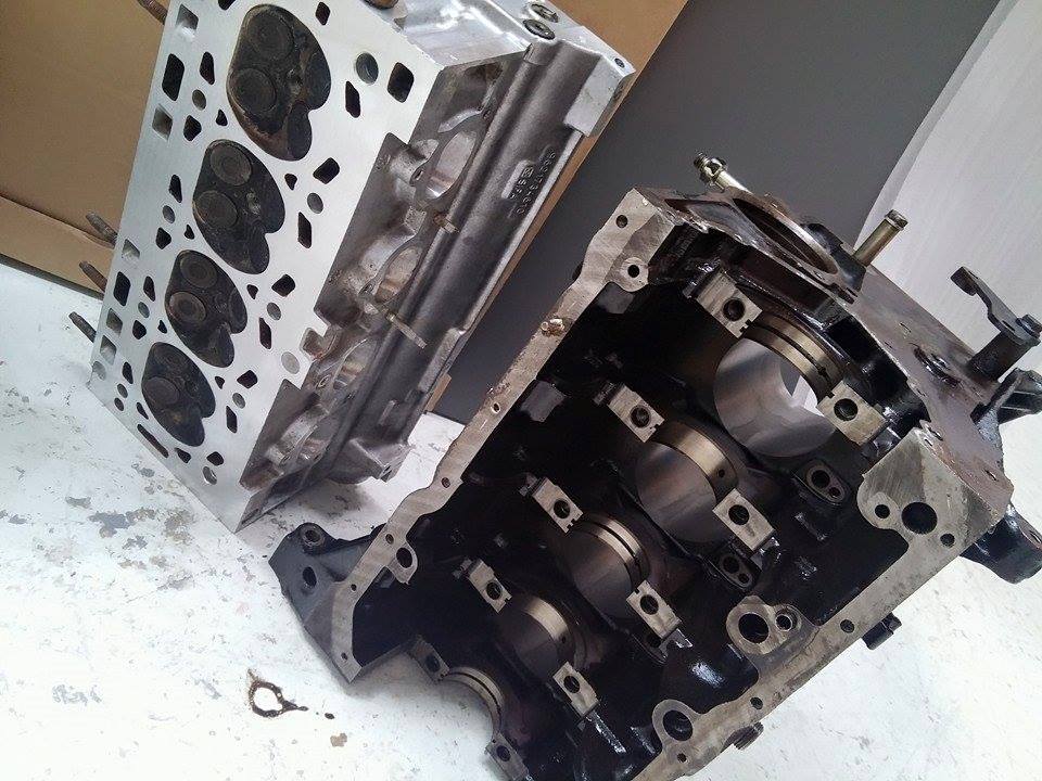

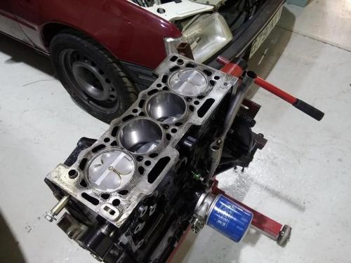

Unfortunately after a couple of years of abuse the engine began to smoke on overrun, not surprisingly really with unknown mileage and the manor to which it was treated on track!!
I took the engine apart only to find lots of issues, worn and scored bores and worn out pistons. Regardless of that, I landed myself another 205 with a throttle bodied engine, I put it back together and bolted the bodies on for a track day.

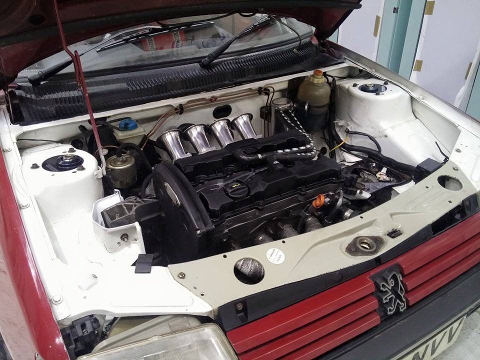

After losing 3l of oil while on track it was time to set about building a real engine for the car, in time for a second trip to the ring

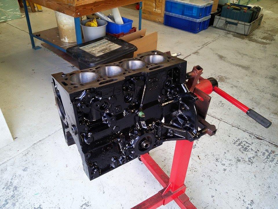

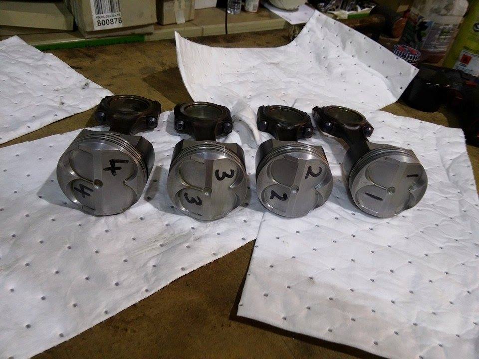

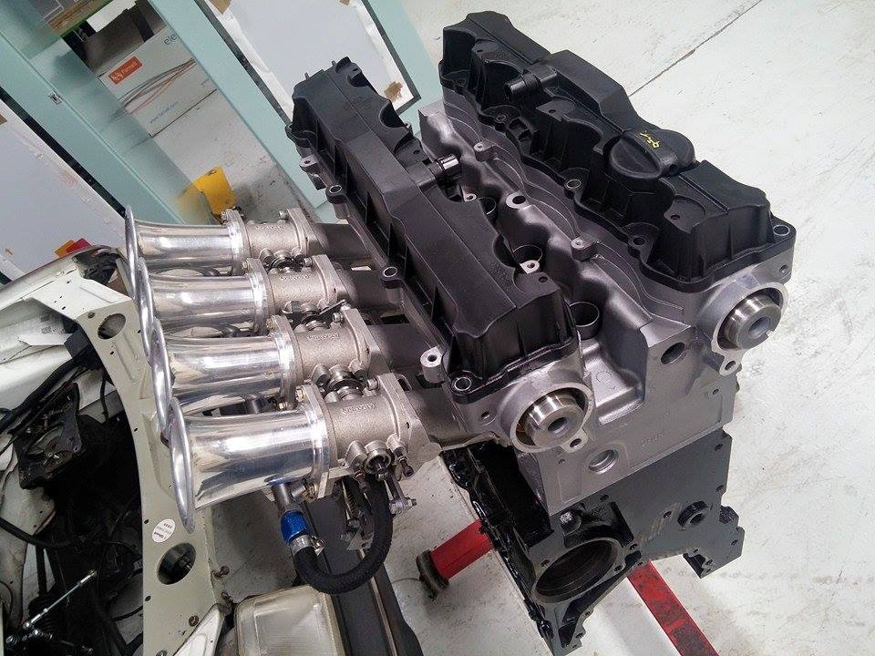

I set out to buy a forged engine, second hand ( a regretful decision which saved me absolutely no money!)
I scrapped the block, cams and most components, leaving me with a set of forged wossners in very good condition and a head with good valve seats and a home port job. Nothing ground breaking but you have to bear with me as I was doing it on a tight budget as I was also saving for the Easter Ring Trip!

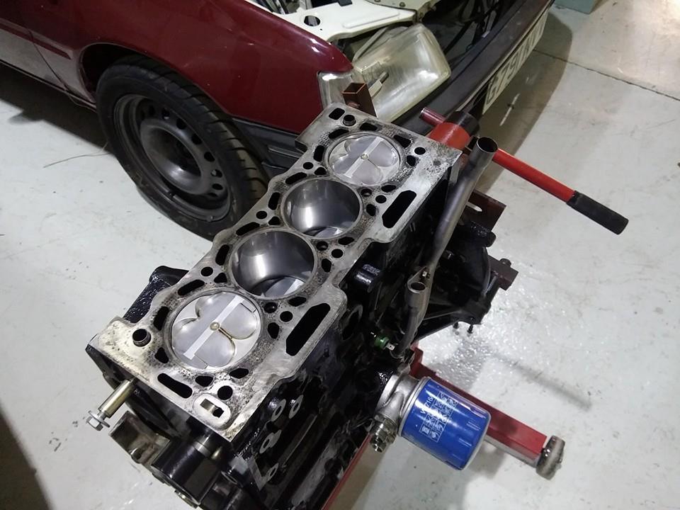

I set about building the engine, learning a lot along the way.

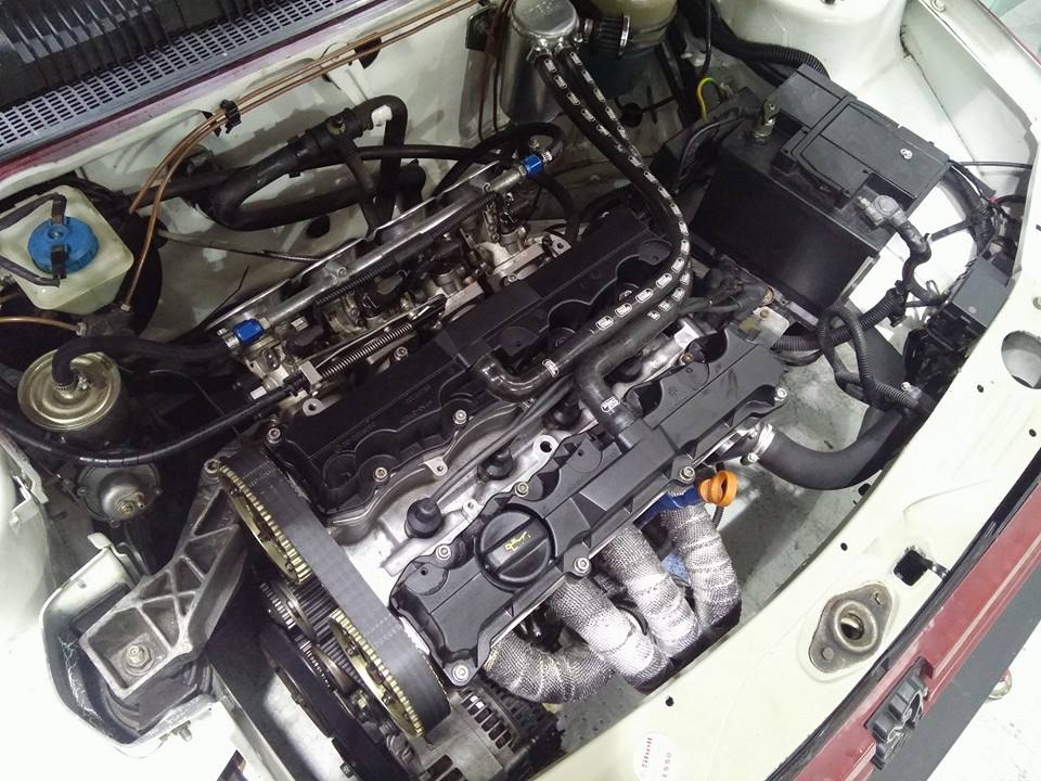

Jenvey 45/42 ST taper bodies
Newman PH4 cams and 160lb springs
ACL race bearings
Freshly rebored block from the engine I removed the jenveys from.
New rings
Fresh skim
1.57mm hg (head skimmed .2 in total)
Wossner GRP A 0.5mm oversize forged pistons
And all the rest of the bits and bobs you need!

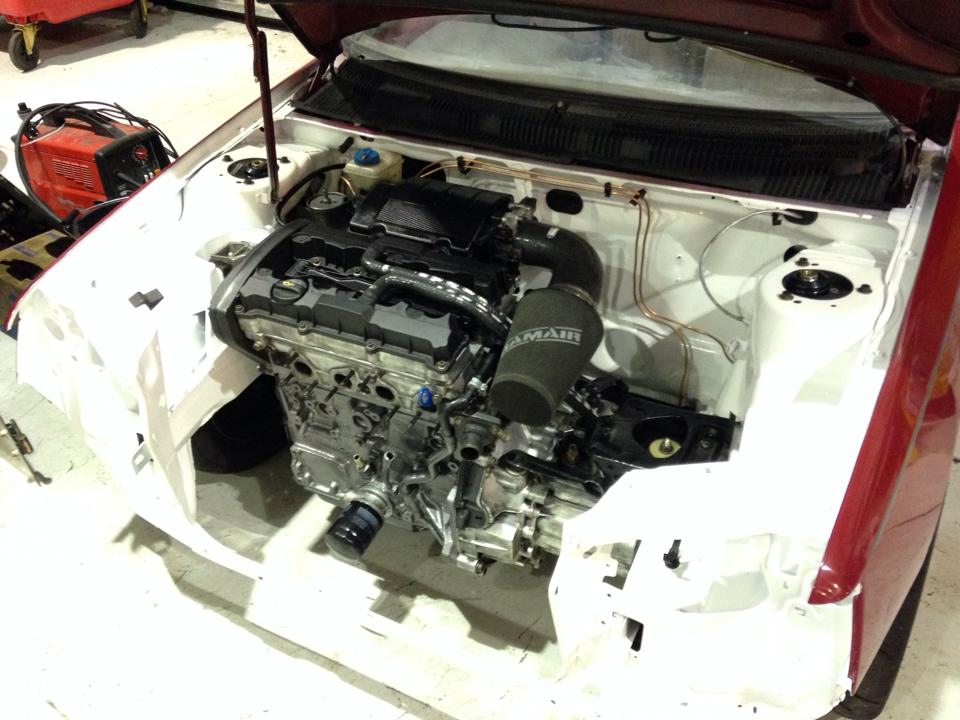

Sandy Brown gave me a great deal of information to help me a long the way, I cant thank him enough for that.
I flipped the bodies over, giving less chance of fuel pooling in the manifold
Sandy set everything up at SRD ltd for mapping, and thankfully I had a pretty trouble free day bar a couple of wiring niggles and I needed a new FPR
Run on the Rolling Road
I'm not in possession of any print outs etc, the only info i have is that it pulls about 160bhp at the wheels at 7k rpm, which is absolutely bang on!

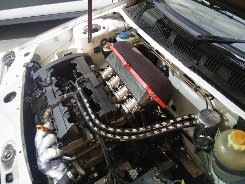

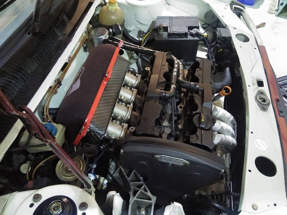

So at the moment I have been doing a little prep for the ring, and some tarting,
New coolant hoses (made my own matrix pipework).
ITG JC50 65mm internal height filter
ITG (reverie?) Carbon back plate 60mm makes up a 35mm gap from the end of the 90mm trumpets
A Satch shift for the MA box which kindly Colin supplied a couple of extra bits and a new bell crank when I was down in Cornwall.
Other than that, some grinding and repairing the arches from having the C5 wheels rubbing constantly with 195 50 tyres, a 1000 mile round trip rubbing would be a disaster!!!

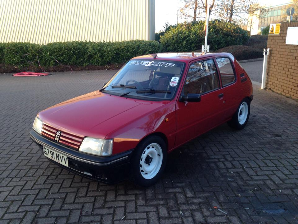

A1AXX

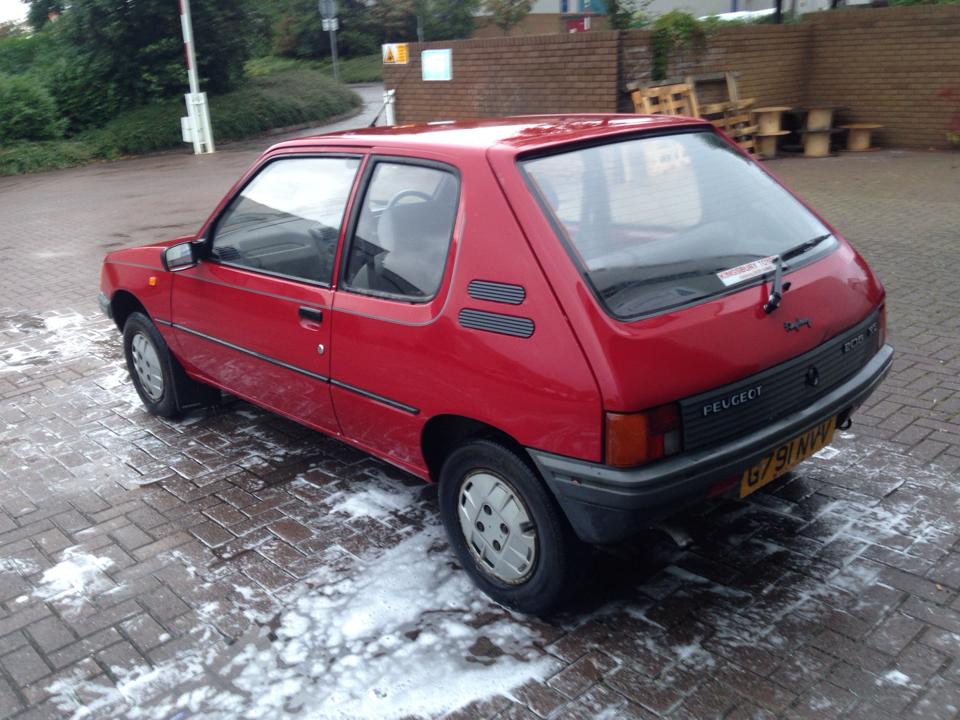

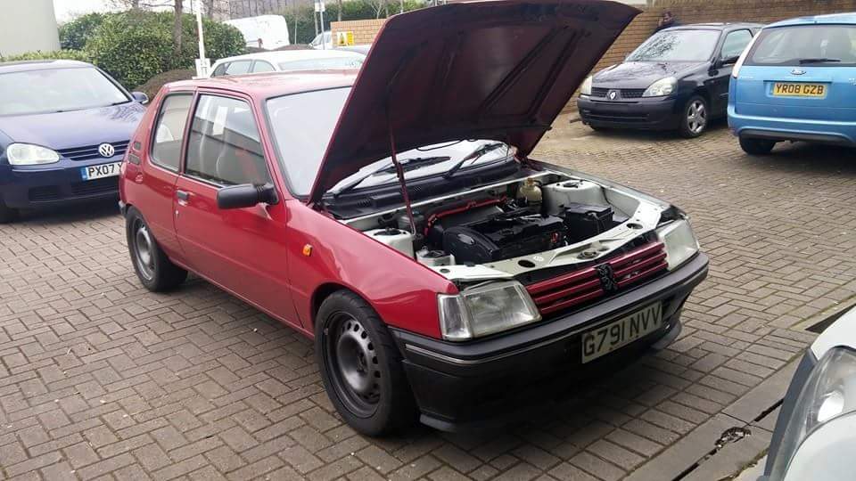

How the old girl looks, still a little sleeper!
Andy_C
Bloody love that. Can't beat a proper sleeper!
