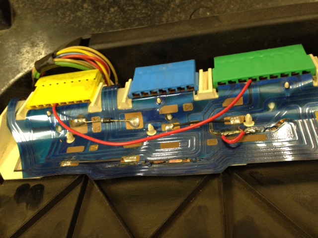

Found the fault, had a burnt out part of a track on the back of the dash,
repaired using a wire to link out the burnt track, so far seems it seems to have worked.
jackherer
That's an odd one! I guess the whole binnacle was flexing slightly when you were turning the steering wheel left.
