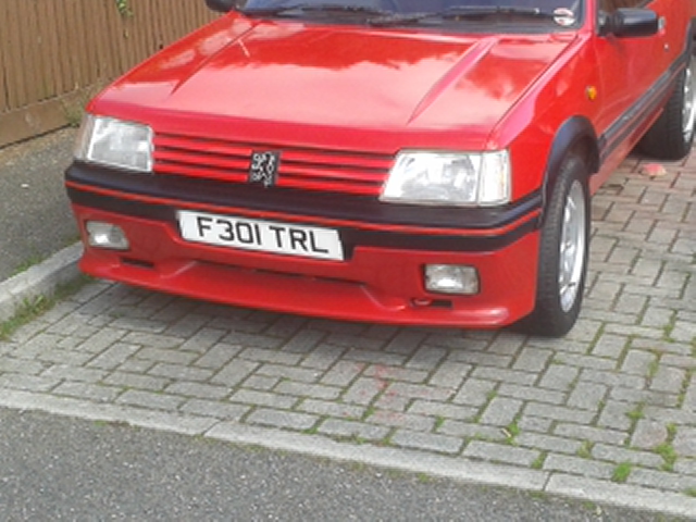

In the past I have used adhesive aluminium tape cut from a paper template and applied in 4 sections, top,bottom and both sides. A little dull compared to new but hasn't dulled further in over 5 years. Have thought about using same method but with self adhesive wing mirror lenses, just never got around to it. These were done about 7 years ago....probably nothing left but tape now!
