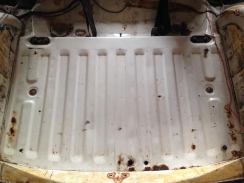

Pictures of the boot pan and inner arch. Some surface rust but no holes and arches are clean (apart from the glue making them look dirty!)
those areas each side will be holes, its where the rail underneath is spot welded to the boot floor.
Yup, common 205 rot spot - pokey tool will find holes. Probably that one at the rear won't be too clever either.
Can't see if it's just a trick of the light, but is that a large rust patch on the offside under where the rear seat base would be? Again, a common rot spot but that looks like it's a fairly significant size and will likely become a fair hole once poked...
Still, fair play for taking it on and most would have shied away :)
stepples
Yeah that's just shadow and a harness! Thanks for the comments. Knew it wouldn't be perfect but glad it's a common problem and glad it's not worse. Difficult to tell the extent but have had a poke and not gone through anywhere yet!

My white one was worse than this and was really rotten in some areas of the boot. I think that's not too bad going by the pictures.

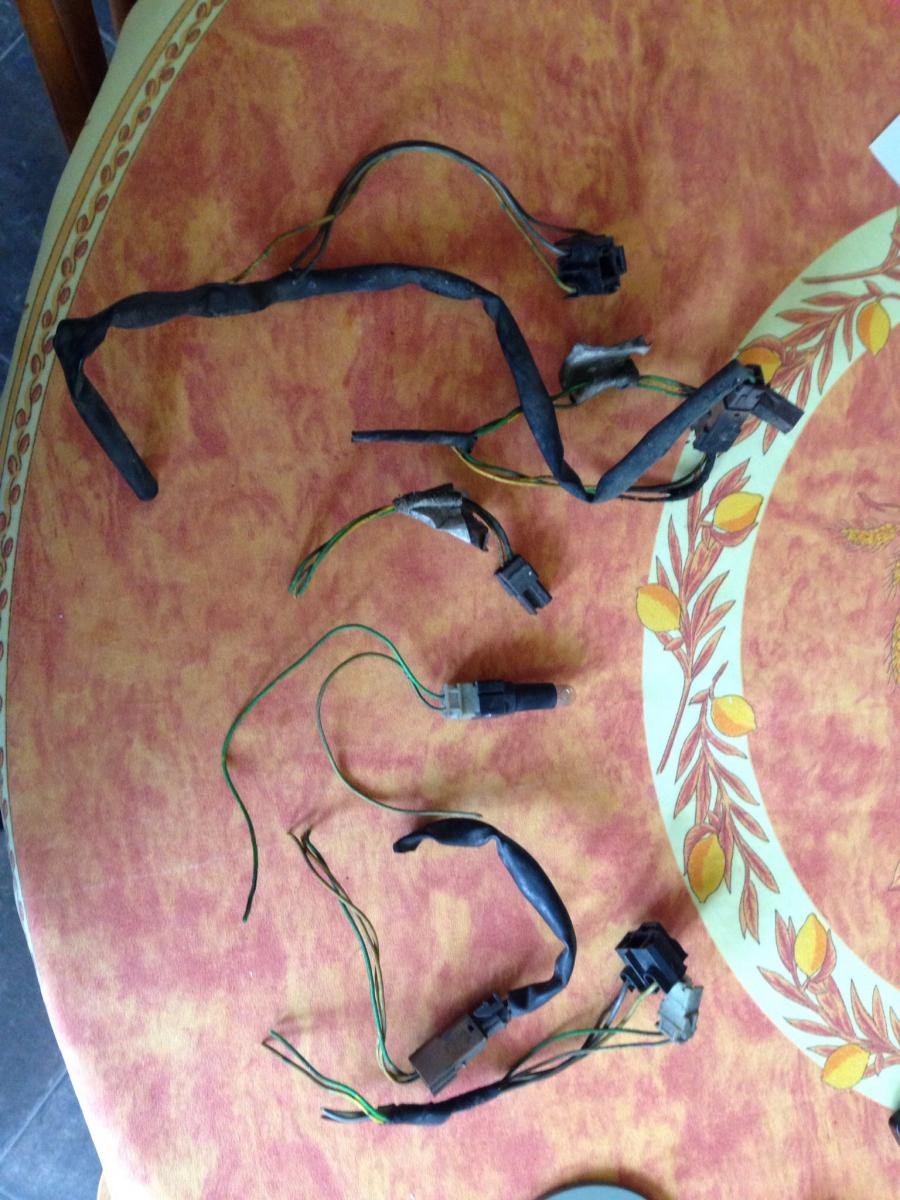

Bought these wires and will begin attaching them very soon to try and sort out the mess of wirespost-22791-0-16261700-1428072116_thumb.jpg

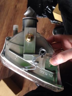

Indicators bought, just need the mounts nowpost-22791-0-79073000-1428072217_thumb.jpg

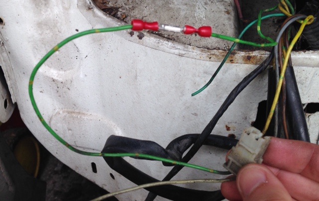

So my side lights were completely messed up through the wiring that had been put in. So with no knowledge of skills behind me I set about removing the mess and used a crimping set to reattach standard wires that I got from a breaking 205. This is the first connection, many more to go.post-22791-0-51198800-1428671238_thumb.jpg
Juttie205
Dont take this wrong way but a better repair to the looms would be to solder and heatshrink all joints instead of using crimps.
stepples
Yeah, thanks for the advice, appreciate it. I don't have much clue about what I am doing so it's a case of trial and improvement. Crimps didn't work, got all the wires sorted but no joy when I turned on the lights. Back to the drawing board and gotta find a multimeter to find out what is going on.
